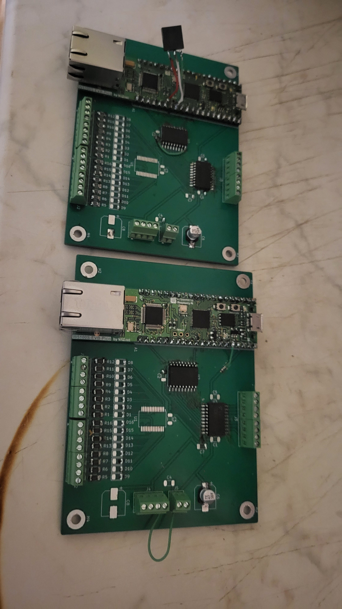

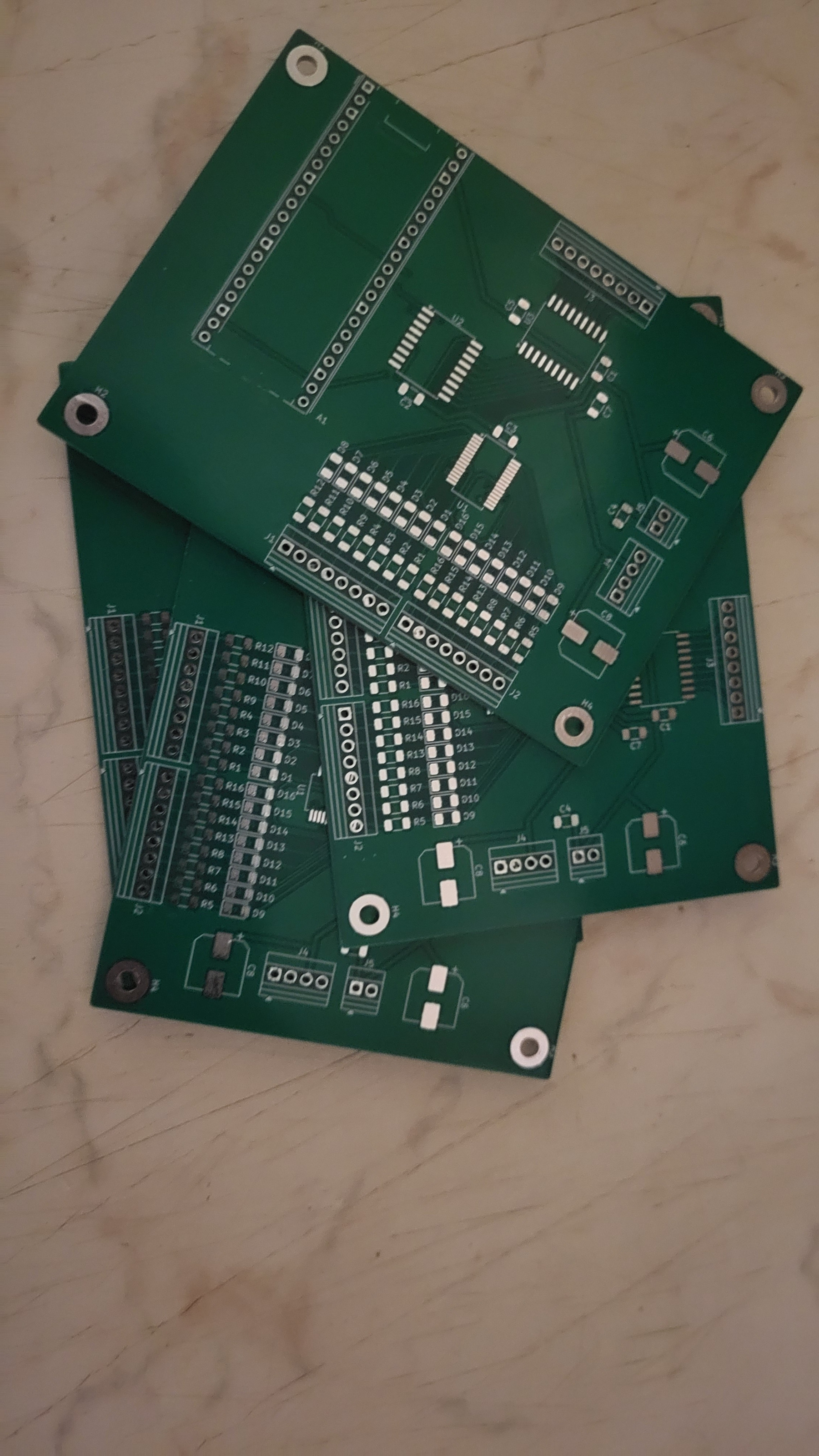

Prototype boards arrived.

03 Apr 2025 20:11 #325639
by atrex77
Replied by atrex77 on topic Developing a Raspberry Pi Pico-based I/O Board for LinuxCNC
Houston, we have a problem, i ordered the io port expander (mcp23017) in wrong package so28 instead of ssop28, and the zener diodes is missing from the order, and i missed the i2c port pullup resistors from the design this need a littlebit of workaround, but the outputs are working now (tbd 62783). Tested with 5v and 24v without load, i messed up 1 of the w5100s-evb-pico-s usb port by pulling the whole microusb inside out but now this programmed trough the SWD debug port, the positive side is i do not need to printing debug info in the usb serial port.

16 Apr 2025 10:01 #326444
by atrex77
i think i finished the prototype stage, all of the prototype faults are corrected, pcb updated, Linuxcnc HAL Driver finished with safety mechanism (watchdog + jump code checksum, (also in the pico)), added optional lcd connector(128x64 sh1106) to the pcb, python library is ready for other uses (experimenting, remote io, etc....)
