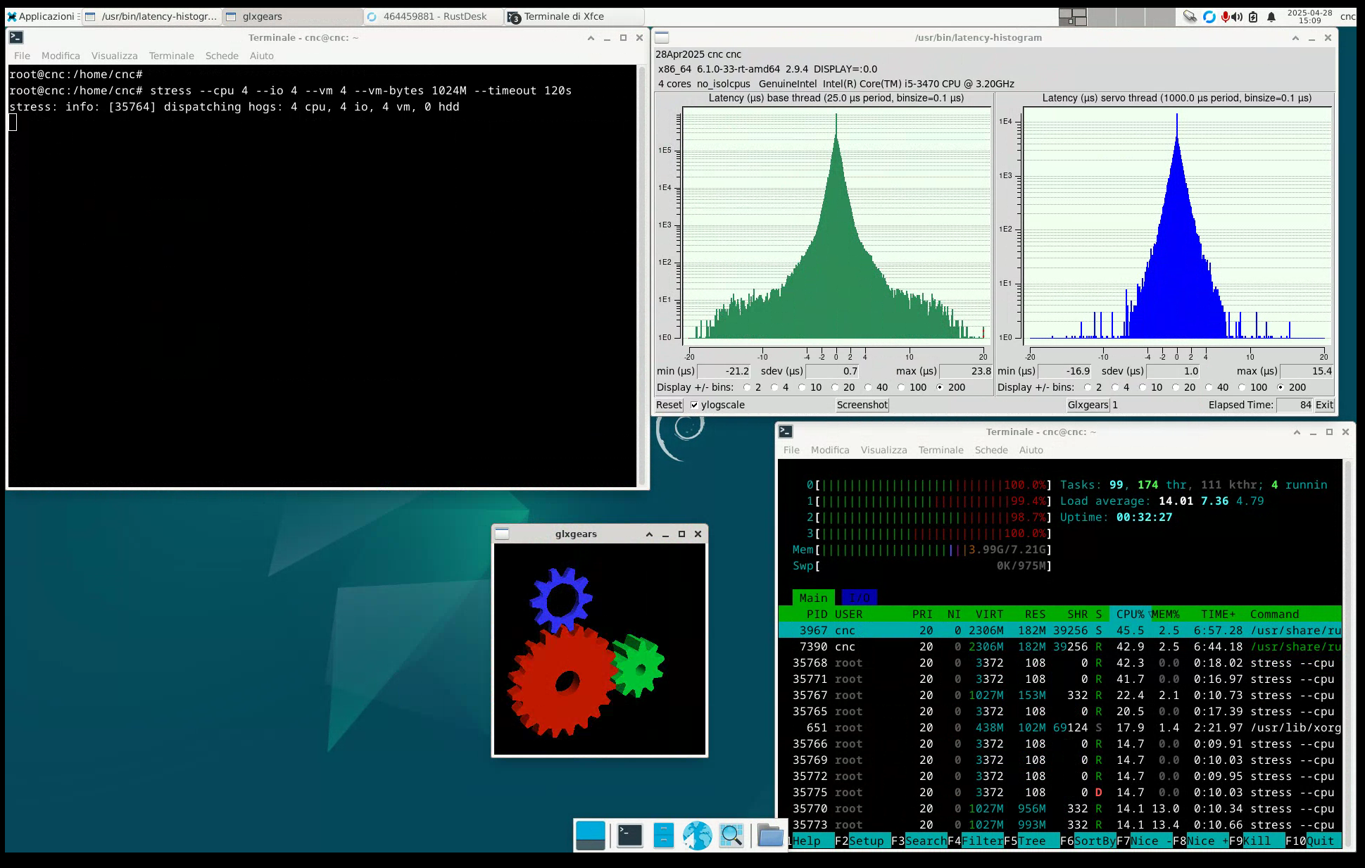

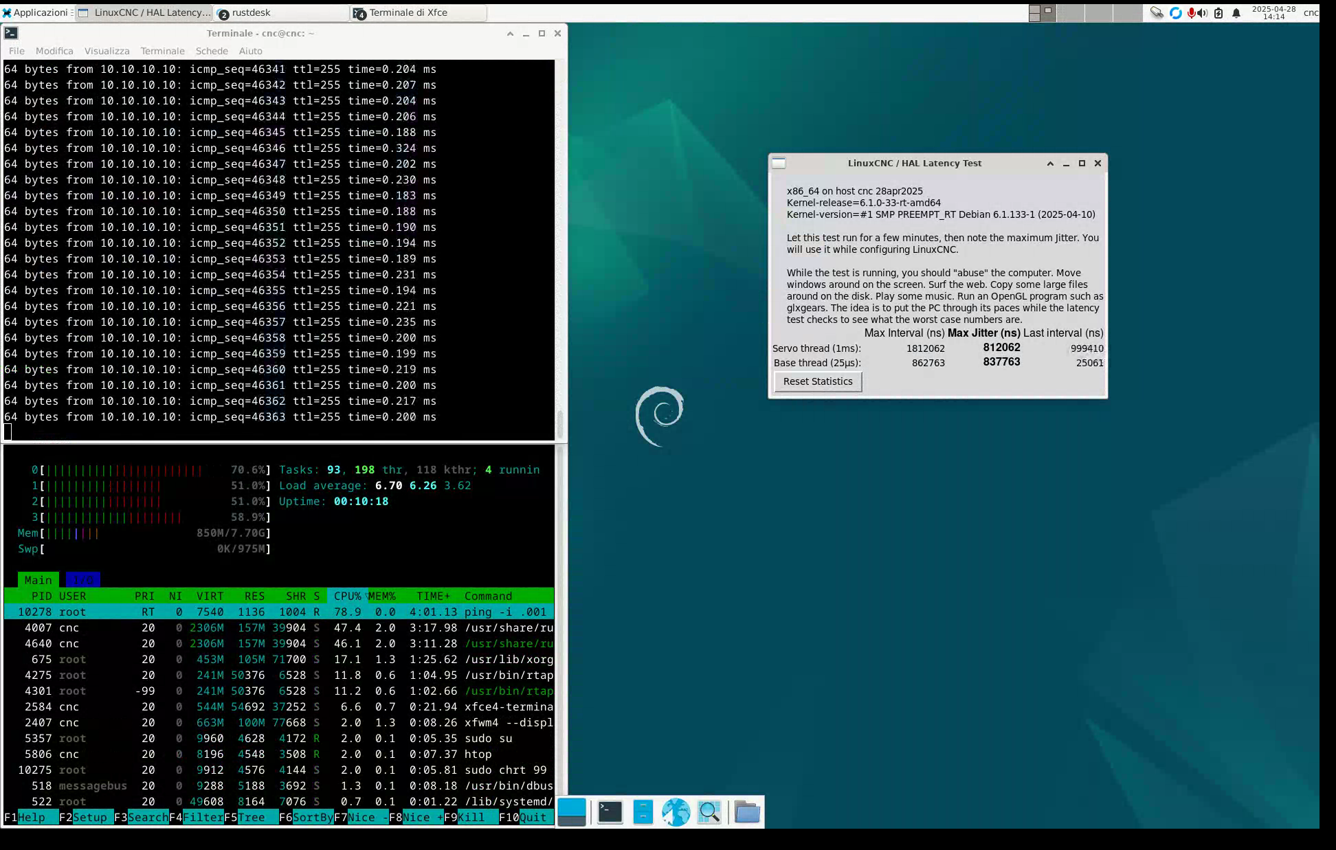

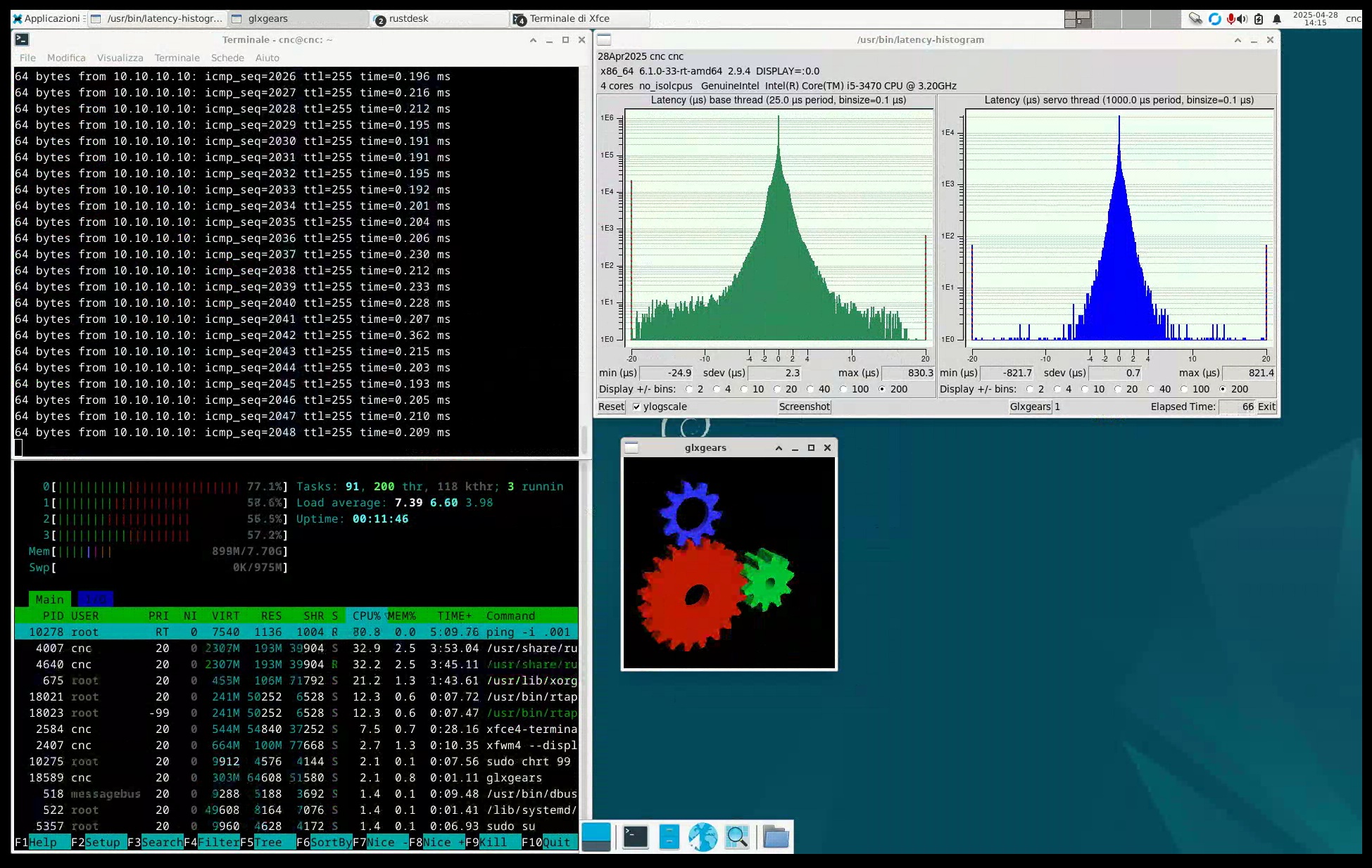

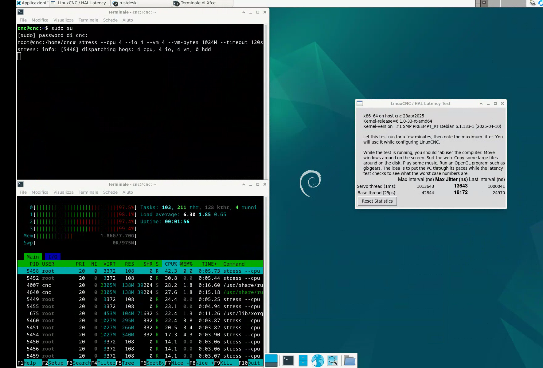

I have run various tests with different commands to check the latency but I don't know if I'm doing things correctly:
[/code]
[SOLVED]linuxcnc Latency test ambiguous results was created by DarkPhoinix
stress --cpu 4 --io 4 --vm 4 --vm-bytes 1024M --timeout 120s
[code]chrt 99 ping -i .001 10.10.10.10 -c 40000000
with stress I get good results with all the cpus at maximum usage, instead with chrt even if the cpus are not busy I see disastrous latency.
what should I do (kernel parameters, kernel recompilation)? the PC is not good for LinuxCNC?
If I don't use hardware parallel port and use NVEM, does this latency matter for operation?

What was the result of the ping command?

rtt min/avg/max/mdev = 0.158/0.255/4.918/0.225 ms
Yeah, ~ 5 ms will be an issue
What is the Ethernet hardware?
If Realtek you likely need to install the DKMS driver
