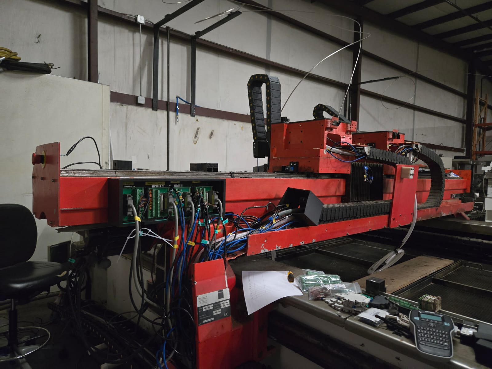

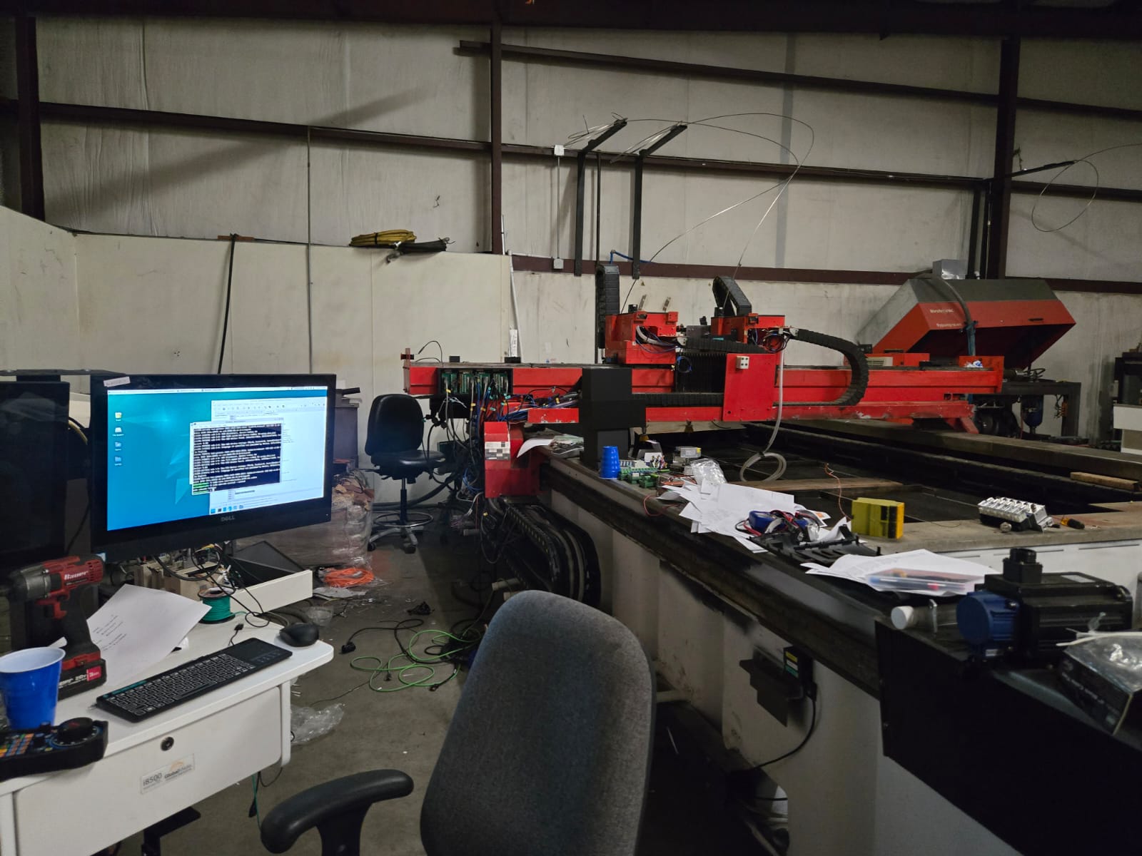

12 May 2025 03:38 #328244
by akim14
Replied by akim14 on topic LinuxCNC Dual-Head Gantry Setup Assistance Request
Thank you. The system I am working on is a water jet with dual cutting heads< two x and two z-axis, I use x and u as x2, and for the z, I used the problem I face is understanding how to implement the slave master on the x-axis and keep the z-axis independent,

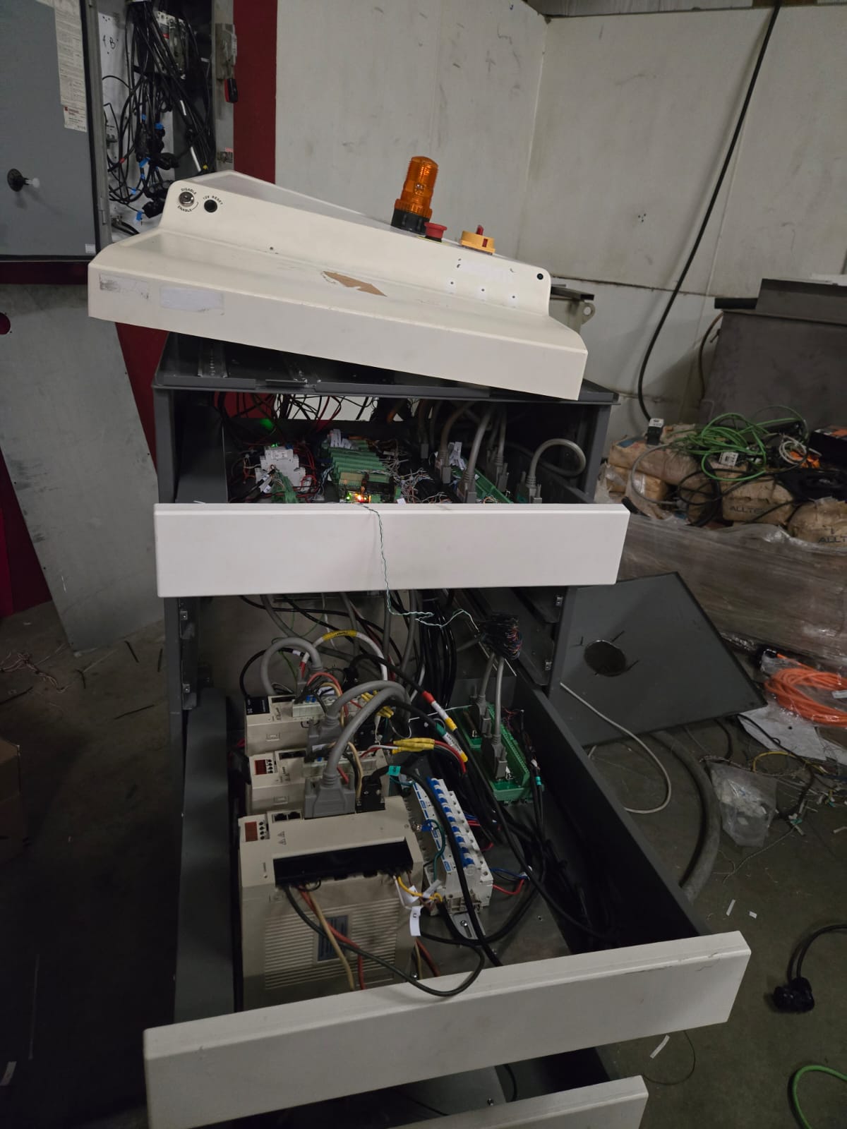

Wow, that's amazing. Did each of the eight heads move on the X-axis independently? I wish you could help me; I think I bit more than I can chew. I downloaded your files, and I feel lost. I am trying to retrofit this bystronic dual head water jet, it looks like a mess. I have all the axis moving, but I can't get the XHC-WHB04B-6 to work. I have not picked a GUI yet, and I have no clue of how to modify one , it sounds easy reading about things but doing it seem to be another issue, I just really need help
