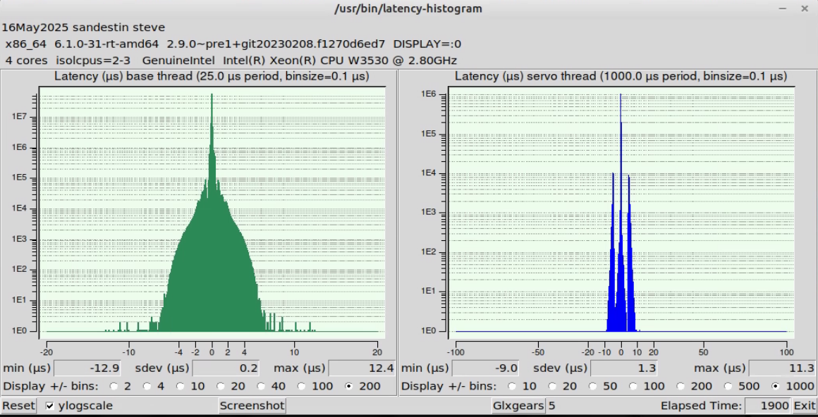

16 May 2025 13:43 #328562
by sajurcaju
Replied by sajurcaju on topic [SOLVED] New wifi card causes second parallel port to stop working
I remembered there is a wifi PCIe card (different brand) in my desktop which won't be missed. I put it in the CNC computer and now it all works.
I also did a latency test. This is with 5 glxgears plus YouTube running a psychedelic video, plus streaming from my RPi camera. Pretty much the same as I had back in March.
In addition to my machine config described in the first post, my graphics card is a Radeon Firepro V5800.
Thanks for the comments,
