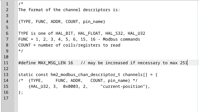

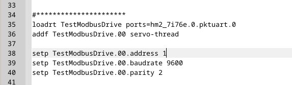

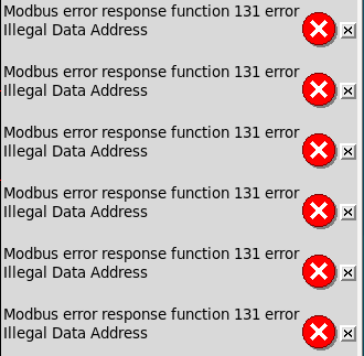

Hello Bro's;
I m trying to control (read/write ) data from MR-JE mistubishi servo drive using the 7I76EU mesa board, using PKTUART, i could reveive data from mitsubishi HMI but when i tried reading the data from the servo drive, it seems like the connection happened but there is not data reed and when i run the linuxcnc it take time to open not like usual time and two type of error appear as shown on the pic bellow. you will find also the .HAL configuration file and the C file where i put the adresse i wanted to read

Are holding registers at 0003 and 0004 readable?

At the end those two adresses are not readable and i change them according the the mitsubishi datasheet with two other adresses and it works thank you so much for your help

The original modbus driver only supports one device per interface
(its basically for VFD spindles or just single devices)
For multiple devices, use hm2_modbus
man hm2_modbus
