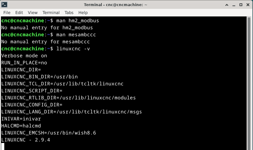

Modbus connection issue mesa 7i76eu pktUART

Replied by tommylight on topic Modbus connection issue mesa 7i76eu pktUART
Seems you would need 2.10 for it to work, see
buildbot.linuxcnc.org

Replied by PCW on topic Modbus connection issue mesa 7i76eu pktUART
2.10 or 2.9 will work but you need a recent build.
(newer than 1 month ago)

Ther is no 2.10, where can i find it and i download the 2.9 now, and same problem help please
You cannot use the standard release as they are only updated about once a year.
For a binary update, you need to use the image built by the LinuxCNC buildbot:
buildbot.linuxcnc.org/
(The page is a bit old as 2.10 is the current LinuxCNC master version and 2.9
is the current release version)
The other option is to build from source:
www.linuxcnc.org/docs/devel/html/code/building-linuxcnc.html
