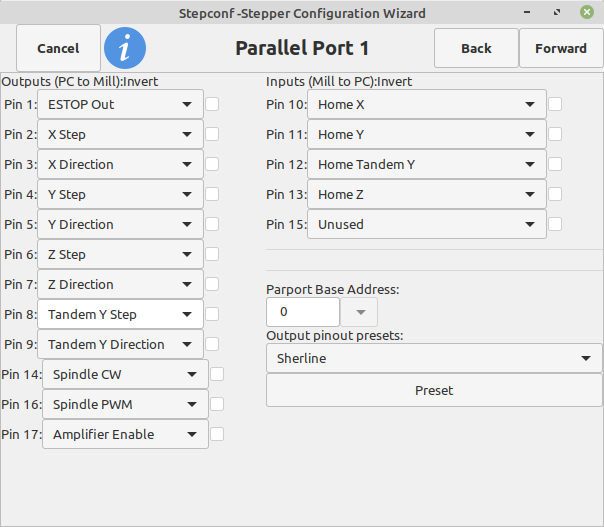

My machine is using the Y and A motors off a parallel port breakout board. I went thru the step config wizard and set up X, Y, and Z configuration and included the A motor pins while doing so. Im really not sure how to proceed as I need Y and A to both home at the same time? Does anyone have a solution for this application?
Thanks in advance for your help and support!

What version of LinuxCNC?
Does it have "tandem N axis" as a choice?
Use that if possible, there are no slaves in LinuxCNC.
Just checked and 2.10 has those choices.

Replied by PCW on topic Y axis A slave help request
Ahh, that may be a master only option for stepconf and not in 2.9.4
If stepconf is standalone (I think it is) you should be able to just use the latest:
( rename to stepconf and chmod +x stepconf )

Thanks for your help I was able to find the tandem axis for Y. I am still not sure how I will get both joints to home at the same time?

The stepconf in 2.9.4 does support gantries (tandem axis)

Is it just about homing sequences? Or do you need to keep a fixed ratio for the axis?

My Router has a motor on each side of the Y axis running a 16mm ball screw fixed to each side of the gantry (Motors Y and A). The motors will always be required to jog and home together in synchronicity. If I try to home or jog either of them, the gantry will rack. When I get an error for trying to jog either axis it says : " Cannot jog joint because home sequence is synchronized". Is there a way to jog Synchronized? Is that a setting in my step config I have overlooked? Should I be doing an XYZA type of step config vs, the XYZ step config choice? Thanks again for your help and support. I am going to dig into the documentation further.

Jogging a joint is not allowed (because it will rack the gantry)
You can jog the Y axis but only after homing is complete.
So if you don't have dual homing switches you need to setup immediate homing
Also unless you have a rotary A axis, there should be no mention of A anywhere
It would be a lot less confusing to refer to the Y Axis as Y and Y1
