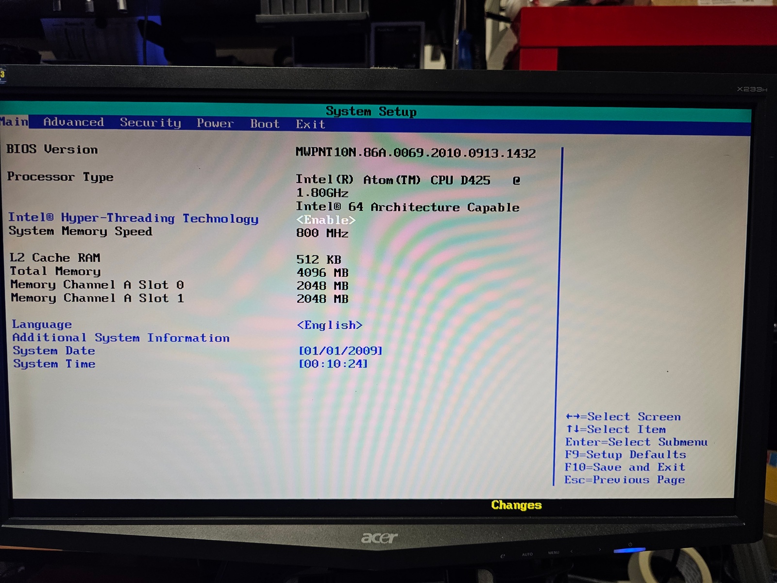

I just ordered a SSD for this old computer. Now that I know it's working, I would like to speed it up
Will this also improve latency for linuxCNC or doesn't it matter, since everything is stored in RAM?
- Posts: 21995
- Thank you received: 7488
04 Aug 2025 21:13 #332849
Replied by tommylight on topic Interfaces & linear scale for LinuxCNC
SSD will improve latency a bit, but adding more RAM would also help, 8GB is just fine, but i do not recall how much you already have.

Looks like HDDs do have interrupts since they are slow and do need the OS to wait for datatransfers.
I'll see if the latency-test will get better or worse when the SSD will arrive
- Posts: 12158
- Thank you received: 4150
07 Aug 2025 10:14 #332995
Replied by rodw on topic Interfaces & linear scale for LinuxCNC
Some errors here, anything over 4Gb of RAM is wasted on Linuxcnc. (2gb is probably enough if you can buy it today!)
Disk access has no impact on latency.
A more extensive real time latency test suite is included as standard in Debian (and most distros): sudo apt install rt-tests
and nothing in it mentions HDD or SSD
wiki.linuxfoundation.org/realtime/docume...howto/tools/rt-tests
