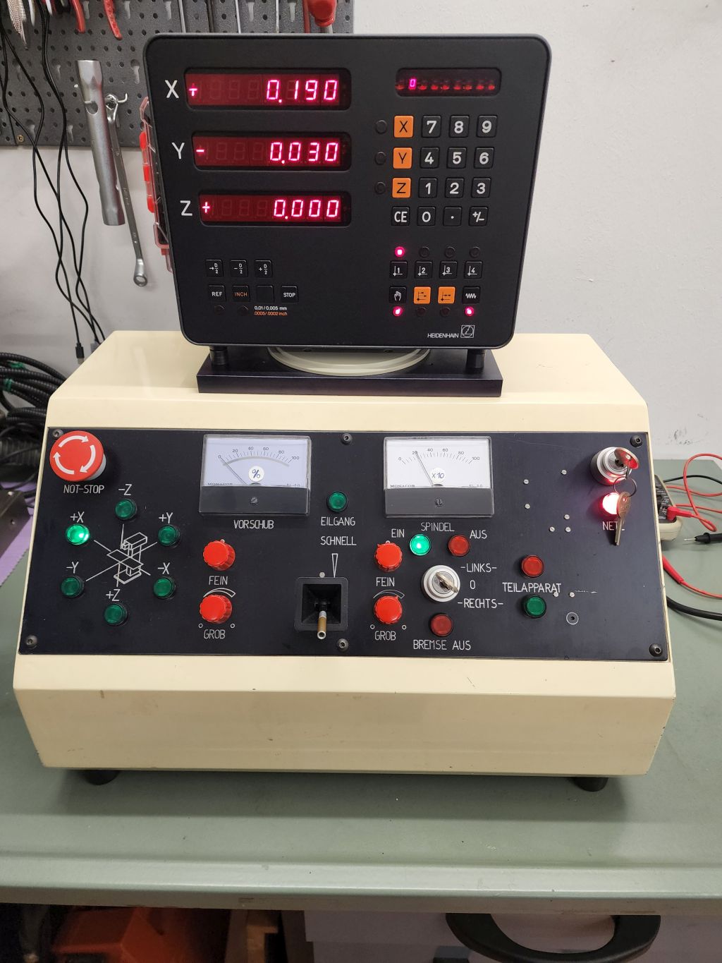

Dear members,
I would like to say hello and introduce myself. I'm a 66 years old Chemist and since 2 years retired from the industry. I am living in the northwest of Germany, near to the Dutch border and the city of Münster. One of my hobbies are old watchmaker machine tools.
I am grown up in an analog environment. I can not program any computer language (but I have a son, who is capable).
I understand pretty well electrics & electro-mechanical matters. I understand electronic circuits up to a level of using components with a maximum of four soldering feet (eg. bridge rectifiers).
All other components, like IC or even EPROM are a "mystery" to me.

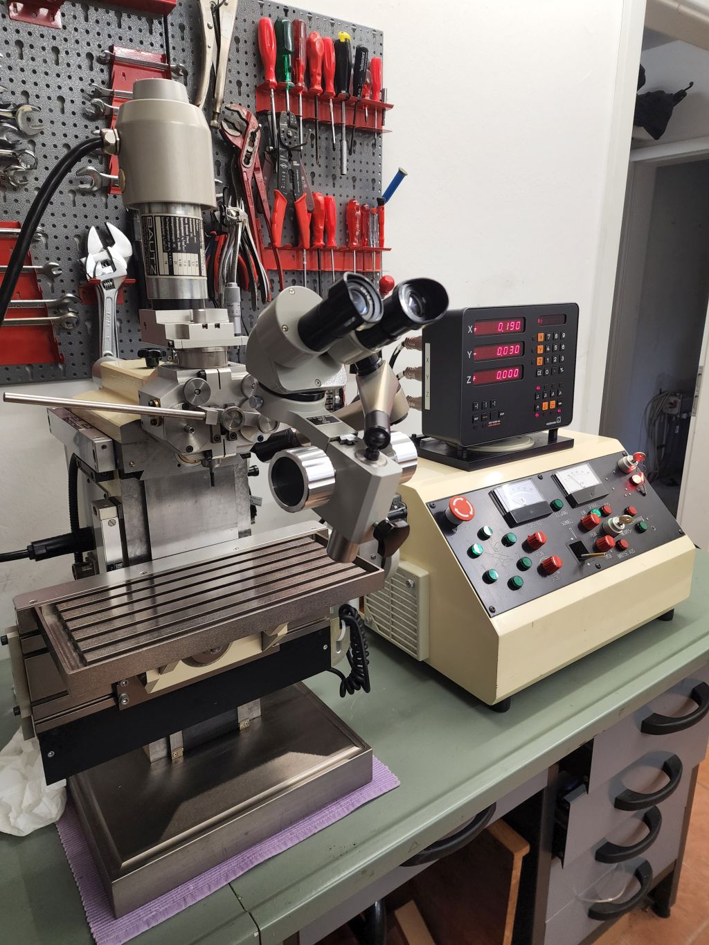

I own a small coordinate milling- and drilling-machine. A Leinen FM1, which is equipped with controls from the mid 80s of the last century.
It uses Heidenhain glass scales on the x-, y- and z-axis and ESCAP 12 V DC Tacho-Servomotors for the movements of these axes.
The indication of position and the positioning to a set coordinate is done by a Heidenhain TNC113 unit, connected with an analog control panel. Furthermore there is a dividing unit with a rotary axis, served by a Heidenhain rotary encoder.
The unit is fully functional. But I`m fearing electric defects in the control panel, without having in hand any documentation of the board layouts, the circuits and the connections. If, after 40 years, a capacitor or a diode would become defective, I would be lost. If needed, the Heidenhain TNC113 can be still repaired by specialists, but a repair is very expensive.
My idea is now, to buy 4 Heidenhain EXE610 on the second hand market and connect them to a newly built LINUX CNC.unit. Could somebody be so kind and advise me, which boards I would need to buy for:
- the INPUTs from the four Heidenhain EXEs
- the INPUTs from the five DC motor tachos (4 from the axes and 1 from the spindle)
- the OUTPUTs to the DC Motors amplifiers/controllers(I have already a second set of amplifiers for the spindle motor of 66 V and the axes drive motors of 12 V).
- some other INPUTs (digital and analog) like limit switches on the axes, emergency switch-off etc., potentiometers
- some other OUTPUTs for indicator lamps/LED

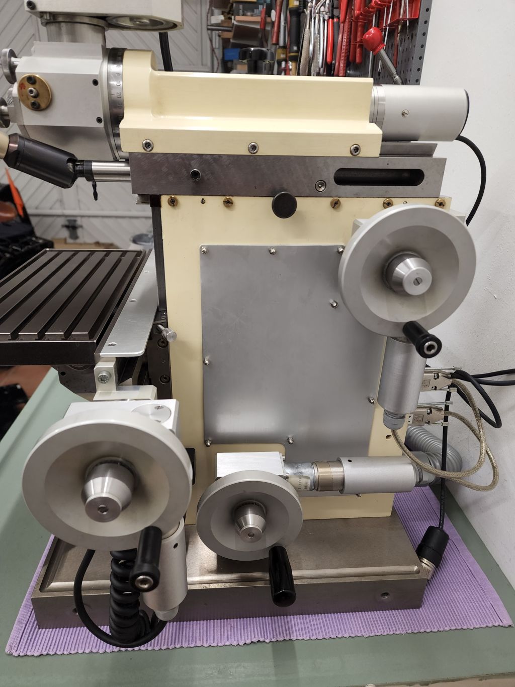

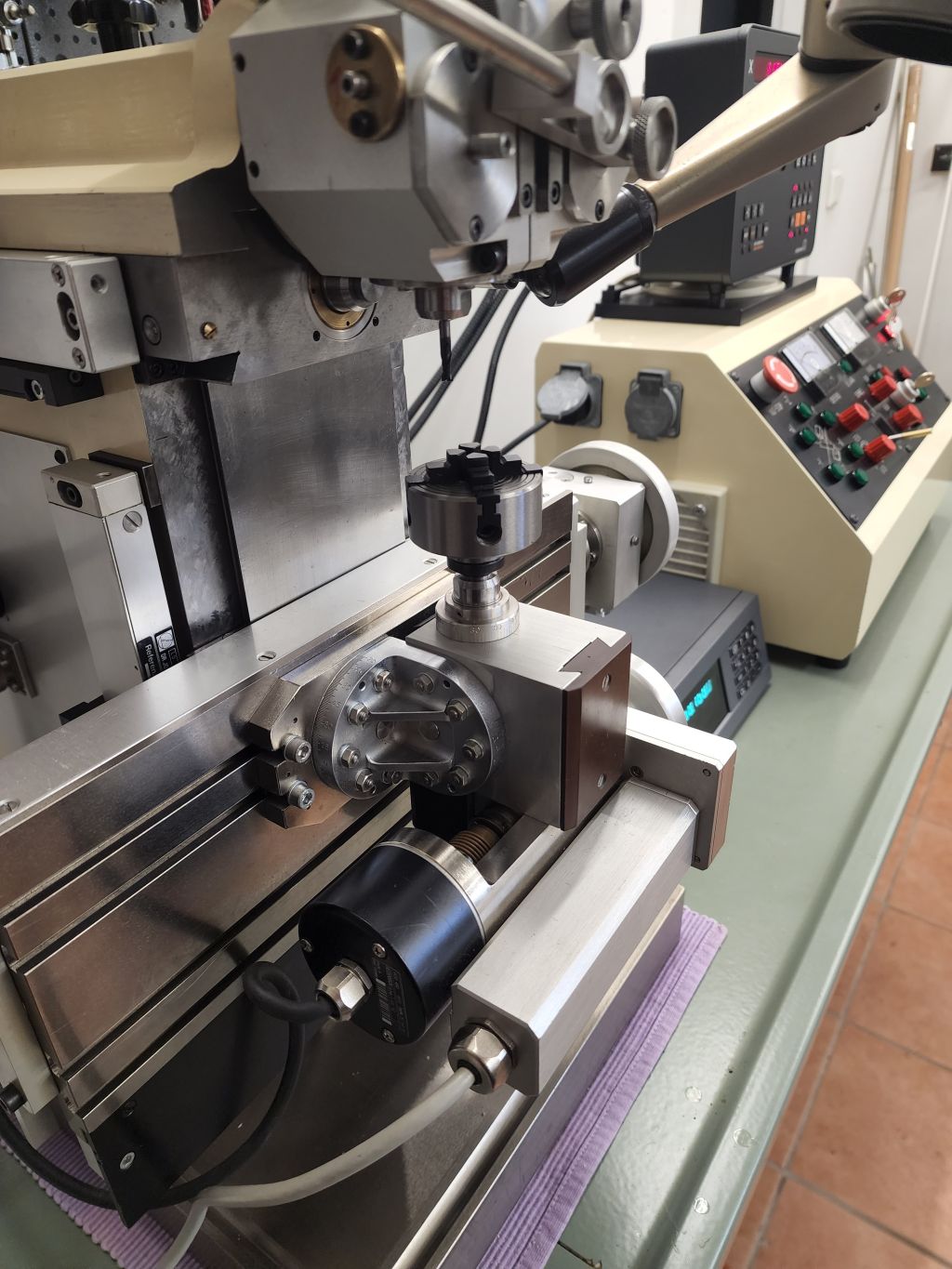

I have two ebay bought used EXE's on my mill. 602D/5-F and 602/1-F. I never did figure out Heidenhains model numbering, so I ended up with one providing 1µm resolution, and the other only 5µm.
How I wired them up is here:
www.forum.linuxcnc.org/12-milling/33035-...0e?start=1340#152364
Those Leinen FM 1 are lovely machines. Please add pictures to your thread. Lots and lots of pictures

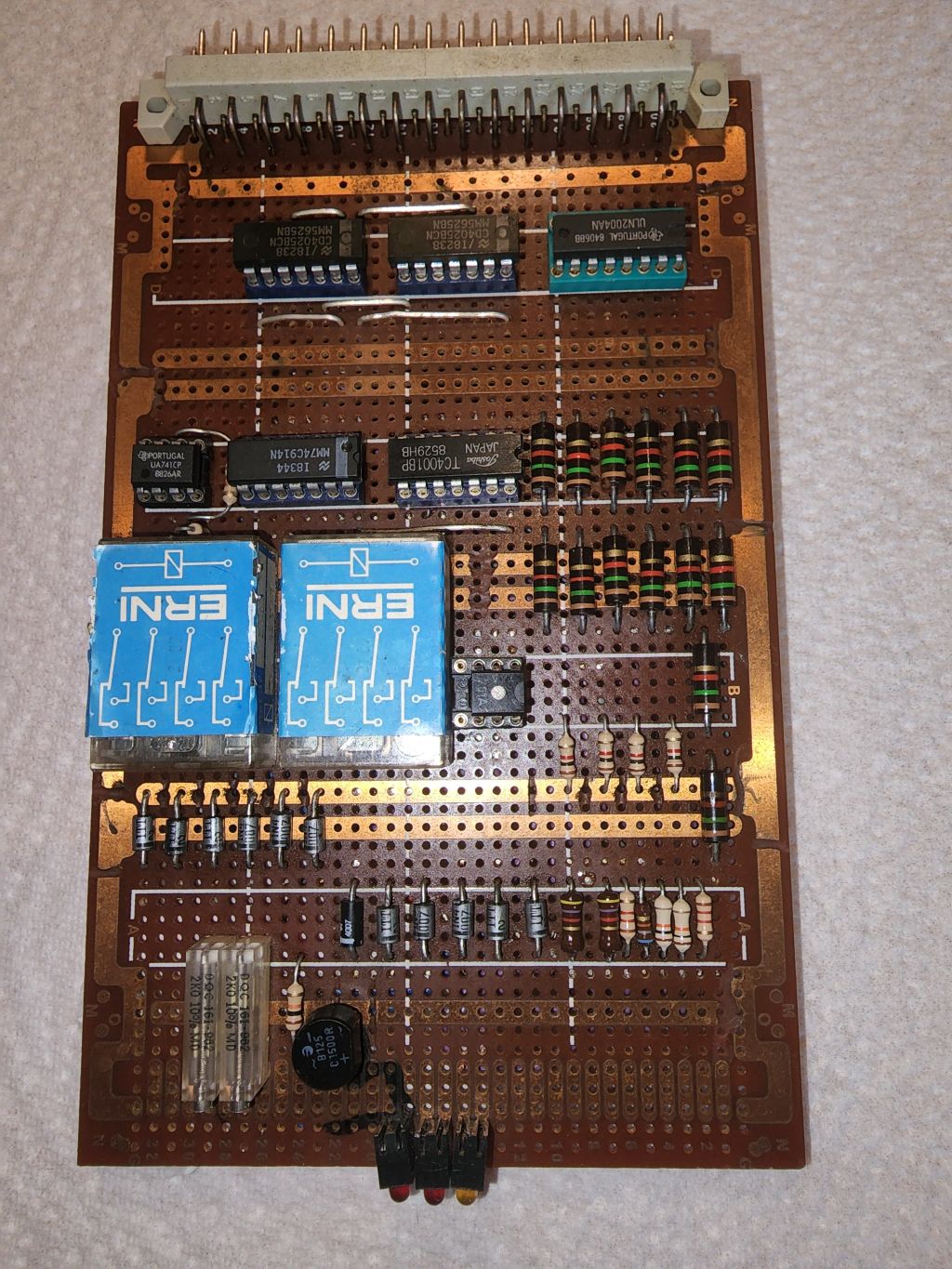

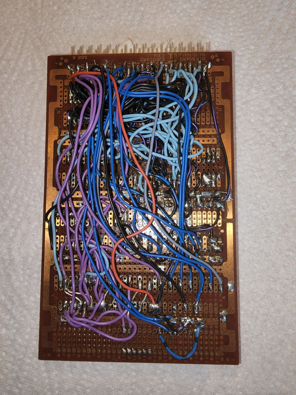

12 Aug 2025 11:17 #333271
Replied by andypugh on topic New member from Germany - CNC retrofit of a Leinen FM1
Is it this one?
www.instagram.com/furniturenmarkt/p/CKTauBwrZ-F
Which claims that it might be the only one?
The circuit board is odd, in that it seems to have only one connection.
Do you have any pictures of the inside of the control cabinet? I would not be surprised to find that you already own some EXE units, in that cabinet.
