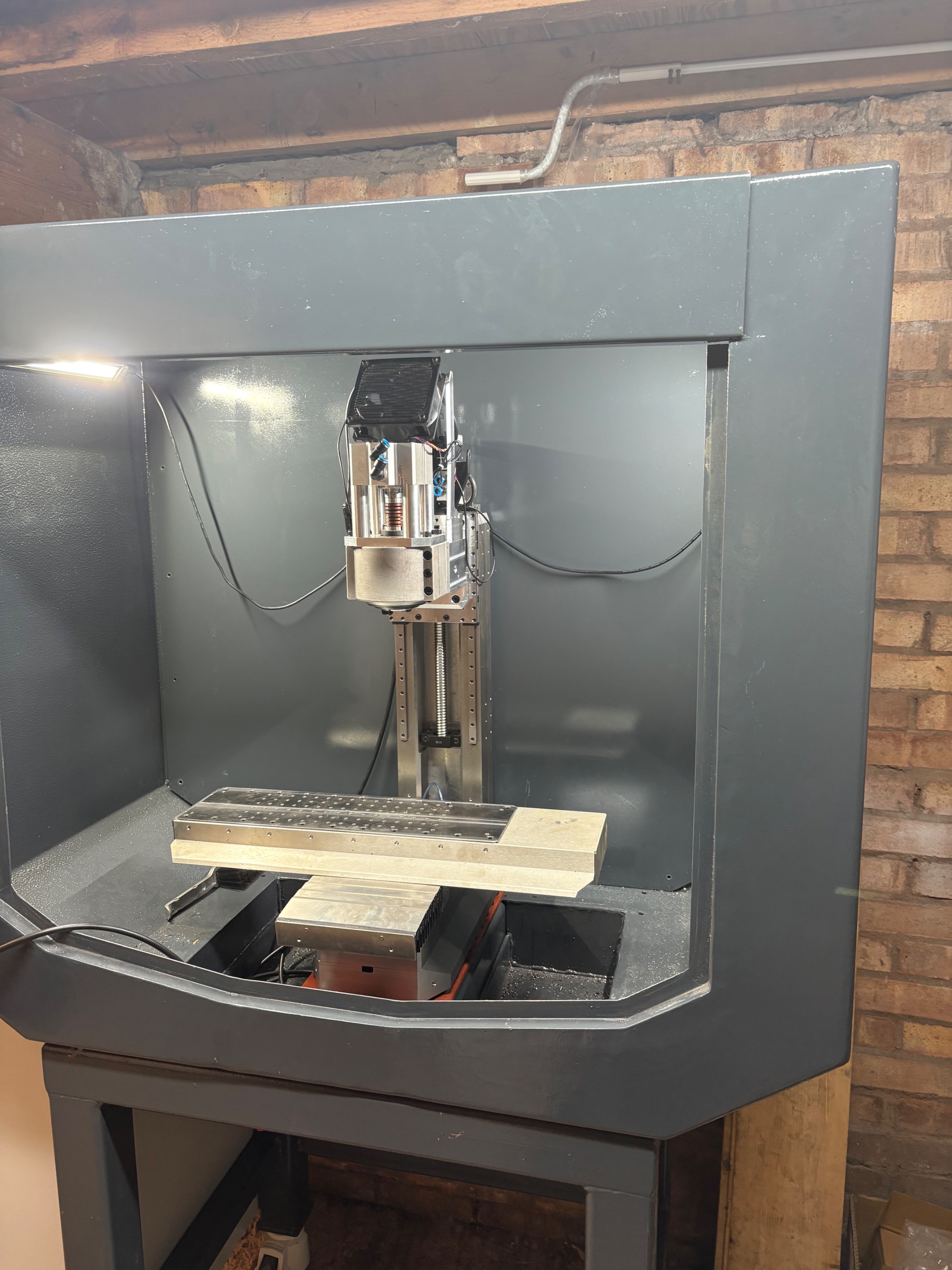

I have a Stepperonline 1000W servo motor with an EtherCAT servo drive, which I intend to use as a temporary spindle motor until I can upgrade to a higher-power unit.
Currently, I have three axes configured to work with Leadshine servo drives via EtherCAT.How can I configure this servo motor to function as a spindle motor?
Specifically, what needs to be added or modified in the following configuration files:
.INI
.HAL.
.XML
I’ve tried setting it up based on information from other forum posts, but I haven’t had much success so far.

Hi Hakan thanks for your help  to configure the drive.
Unfortunately I am having no luck in getting it to work.
I have attached my files below do you mind having a look to see if there is anything obvious I am missing?
I am very new to linux so am struggling to work out when using the loadrt command in the .hal file  where the other  file is loading from?
Thanks Will
