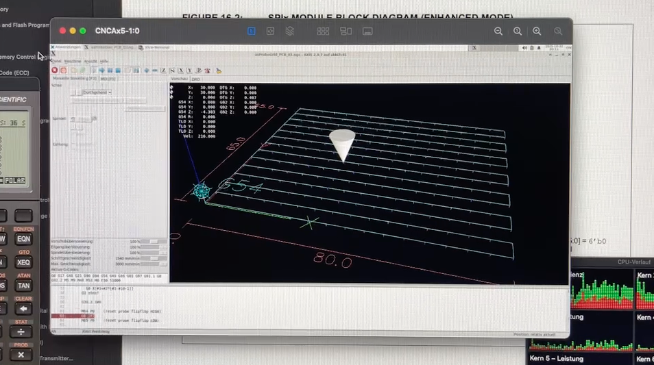

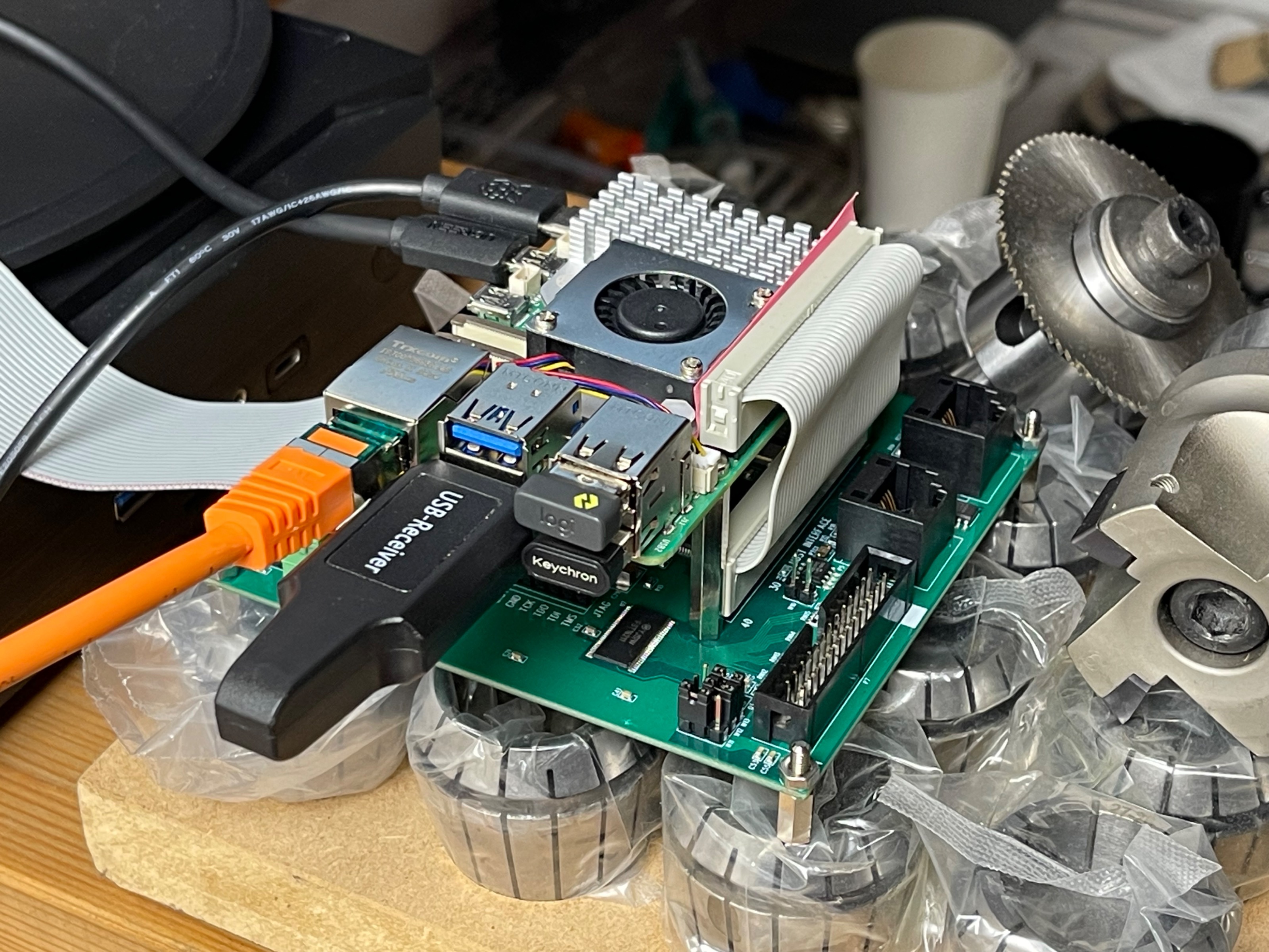

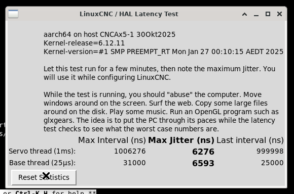

- AkkiSan
- Posts: 19
31 Oct 2025 00:25 #337558
by AkkiSan
Replied by AkkiSan on topic Which LinuxCNC HW for 2026+?
Kudos go out to all who made this possible:
60000+ probes for now, during the last 24 hours, with an RPi5, 7c81 and the brand new 2.9.7.
Zero issues, so far. \o/
While probing, this thing now also runs a VNC server in the background,
I am connected via VPN; it’s streaming music and also downloading a random
10GB image file in a web browser.
Pretty good latency too. Comparable to a decent RTAI setup, imho.
Still some extra steps, as described here,
forum.linuxcnc.org/49-basic-configuratio...rol-is-choppy#332726
and this "xset -r“ drives me crazy, bc I have to use the keyboard until I managed to get the handwheel working.

- unknown
- Posts: 887
- Thank you received: 323
31 Oct 2025 00:42 #337560
by unknown
Replied by unknown on topic Which LinuxCNC HW for 2026+?
Those figures look pretty good, where did you get your kernel from or did you build it yourself.
