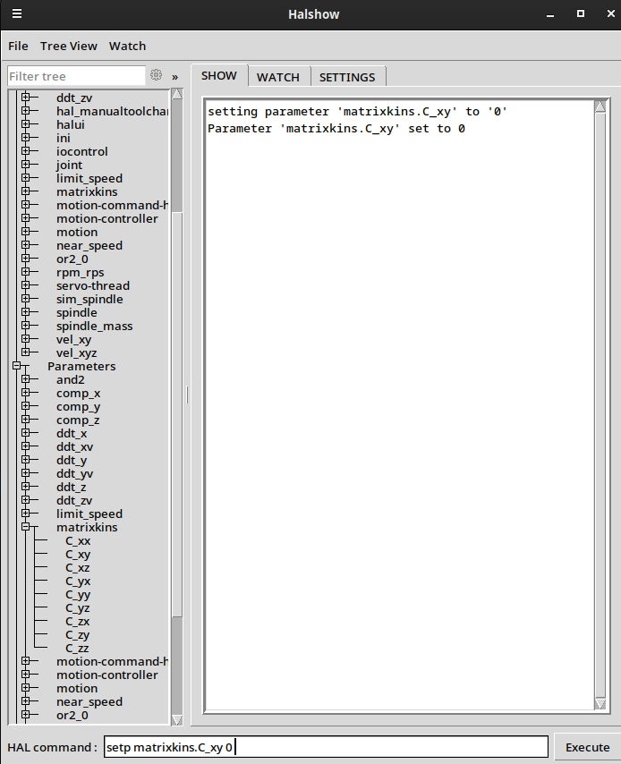

by abs32
Replied by abs32 on topic v2.9 and not the perpendicularity of X and Y
ok, -
INI -
[KINS]
JOINTS = 5
#2025-11-20 для 2.9.4
#KINEMATICS = trivkins coordinates=XXYYZ
KINEMATICS=matrixkins
HAL -
#2025-11-20 для версии 2.9.4
loadrt [KINS]KINEMATICS
#программная коррекция
#https://linuxcnc.org/docs/devel/html/man/man9/matrixkins.9.html
#https://github.com/LinuxCNC/linuxcnc/blob/master/src/hal/components/matrixkins.comp
#loadrt matrixkins
setp matrixkins.C_xy 0 # Skew Y axis towards X axis
setp matrixkins.C_xx 1 # X axis scale
setp matrixkins.C_xz 0 # Skew Z axis towards X axis
setp matrixkins.C_yx 0 # Skew X axis towards Y axis
setp matrixkins.C_yy 1 # Y axis scale
setp matrixkins.C_yz 0 # Skew Z axis towards Y axis
setp matrixkins.C_zx 0 # Skew X axis towards Z axis
setp matrixkins.C_zy 0 # Skew Y axis towards Z axis
setp matrixkins.C_zz 1 # Z axis scale
Start = abort,

20 Nov 2025 19:57 #338825
by abs32
ln -s /usr/lib/linuxcnc/modules/maxkins.so /usr/lib/linuxcnc/modules/matrixkins.so
# ll /usr/lib/linuxcnc/modules/ma*
-rw-r--r-- 1 root root 15240 окт 23 01:43 /usr/lib/linuxcnc/modules/maj3.so
-rw-r--r-- 1 root root 15680 окт 23 01:43 /usr/lib/linuxcnc/modules/match8.so
-rw-r--r-- 1 root root 14800 окт 23 01:43 /usr/lib/linuxcnc/modules/matrix_kb.so
lrwxrwxrwx 1 root root 36 ноя 20 22:52 /usr/lib/linuxcnc/modules/matrixkins.so -> /usr/lib/linuxcnc/modules/maxkins.so
-rw-r--r-- 1 root root 15512 окт 23 01:43 /usr/lib/linuxcnc/modules/max31855.so
-rw-r--r-- 1 root root 14704 окт 23 01:43 /usr/lib/linuxcnc/modules/maxkins.so
Start = abort,
Debug file information:
Note: Using POSIX realtime
4.hal:16: /usr/bin/rtapi_app exited without becoming ready
4.hal:16: insmod for matrixkins failed, returned -1
1358
Stopping realtime threads
Unloading hal components
maxkins: not loaded
<commandline>:0: exit value: 255
<commandline>:0: rmmod failed, returned -1
<commandline>:0: unloadrt failed
ЧЯДНТ? What I Do Wrong?

21 Nov 2025 08:30 #338865
Replied by Aciera on topic v2.9 and not the perpendicularity of X and Y
Appologies, it seems that 'matrixkins' is not in version 2.9 but in version 2.10.
you'll want to remove the link to 'maxkins'
It should be possible to install 'matrixkins' using the 'halcompile' tool, this will require the linuxcnc-dev package though. To check if 'halcompile' is installed try
if that works you can copy the contents from here:
github.com/LinuxCNC/linuxcnc/blob/master...ents/matrixkins.comp
to a file named 'matrixkins.comp', Then navigate to the location of the file in terminal and install it with:
If halcompile is not installed you would need to install the 'linuxcnc-dev' package:
sudo apt install linuxcnc-dev
NOTE though that I am generally unfamiliar with deb installs as I usually work with locally built installations so I'm not sure if installing 'linuxcnc-dev' will have any consequences to your current installation.

21 Nov 2025 08:49 #338866
by abs32
Thanks for the tips. I deleted sl. Linuxcnc-dev, of course, is installed.
# halcompile -h
halcompile: Build, compile, and install LinuxCNC HAL components
halcompile --install matrixkins.comp
File "/usr/bin/halcompile", line 1553, in <module>
main()
File "/usr/bin/halcompile", line 1523, in main
process(f, mode, outfile)
File "/usr/bin/halcompile", line 1363, in process
a, b = parse(filename)
File "/usr/bin/halcompile", line 434, in parse
f = open(filename).read()
FileNotFoundError: [Errno 2] No such file or directory: 'matrixkins.comp'

21 Nov 2025 09:17 #338868
Did you get 'matrixkins.comp' from the github page as linked in my last post?
- abs32
- Posts: 47
21 Nov 2025 09:21 - 21 Nov 2025 09:21 #338870
by abs32
pardone, -
wget github.com/LinuxCNC/linuxcnc/blob/master...ents/matrixkins.comp
--2025-11-21 12:20:08-- github.com/LinuxCNC/linuxcnc/blob/master...ents/matrixkins.comp
Распознаётся github.com (github.com)… 140.82.121.3
Подключение к github.com (github.com)|140.82.121.3|:443... соединение установлено.
HTTP-запрос отправлен. Ожидание ответа… 200 OK
main()
File "/usr/bin/halcompile", line 441, in parse
a, b = f.split("\n;;\n", 1)
ValueError: not enough values to unpack (expected 2, got 1)

Thank you, of course, I'm a hat and stupidly downloaded the html page. We have advanced
Compiling realtime matrixkins.c
Linking matrixkins.so
cp matrixkins.so /usr/lib/linuxcnc/modules/
start abort -
4.hal:22: parameter or pin 'matrixkins.C_xy' not found
4.hal file -
start abort -
4.hal file -
Last edit: 21 Nov 2025 09:43 by abs32.
- Posts: 4585
- Thank you received: 2034
21 Nov 2025 09:52 #338873
- abs32
- Posts: 47
21 Nov 2025 10:09 #338874
by abs32
Bravo, thank you!
The interface immediately changed - before home, a choice of individual motors is now available!
There was an error in the perception of the hal file configuration when I tried to write down the parameters
