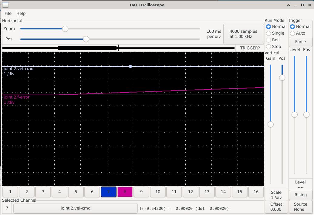

Hello everyone!
I am struggling with the implementation of my servo drives. I set up the pncconf wizard and did some adjustments, checked the Output Offset and scaled the Encoder. Now I want to start the machine an make some PID tuning, but if i toggle the Machine Power Button the Servos directly starts to turn. After a few secs i got an following error (make sens) and the Servos stops.
What is wrong in my config? Is this an Servo Controller Problem or an Mesa Setup Problem? What should i do next?
I am using the Linux CNC (2.9.4), a MESA 7I92TM connected via Ethernet and a 7i77 at Port P2 for the Servo Drive Control. My Servo Drives (Yaskawa SGDV-7R6A01A) run with +-10V and Encoder Signal to the Linux CNC.
Attached you can find some pictures and files of my config.
Thanks a lot and all the best wishes from Germany
JanCNC

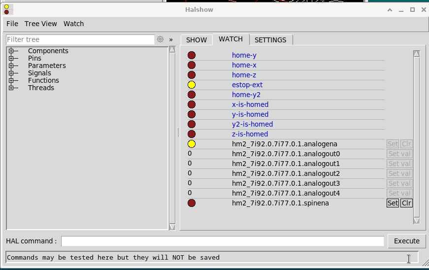

If I press F2 in LinuxCNC the analogena signal seem to work in the HALSHOW but there is no power on the TB5 Analog Drive Interface from the 7i77. The PINS ENA0- and ENA0+ on the TB5 connector should get power when I turn on the machine with F2 right???
I did some changes and tried to wired it properly but...

They just short internally as a normal switch.
Replied by tommylight on topic Servos drives directly start turning
No.The PINS ENA0- and ENA0+ on the TB5 connector should get power when I turn on the machine with F2 right???
- JanCNC

But now i got a problem with my gantry Y Axis. If both Y Axis connected to the TB5 and we press F2 the Motors jumps around and an following error occures. Do you have any idea why this happend?

Replied by PCW on topic Servos drives directly start turning
The hal file shows independent analog outputs and encoders
Are you sure you have the feedback correct for Y and Y2?
You not only have to get the right (matching) directions but the
proper feedback so you don't get a instant runaway at drive enable.
Might be best to test this with the linear axis disconnected
