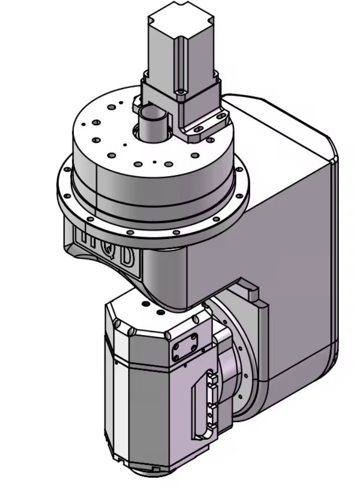

This is the swivel head that I want to insstall. It comes with Yaskawa servos and digital drives. The rotaries that I intend to install will also have digital drives so I think I will be using the analog drives and servos that come with the machine on one Mesa card, and doing all these more modern stuff on a second card with a 3rd handling all the sensors.
Question: The current setup with the 16hp columbo spindle is about 100ish lbs. This AC head is another 100ish lbs. I wanted to sell the columbo, and just install a spindle that is closer to what I need... about 6hp (max). The machine comes with an air piston that reduces the load on the Z axis servo drive. I'm not sure how much weight it can handle. I image this is a function of air pressure, gaskets, and how the thing is built. If this air lift thing is calibrated right, there should not be any additional load on the Z axis servo, so I'm going to assume that problem away. I sort of have no doubts that the gantry and bearings can take the extra weight... been climbing up there to check stuff out, and its just built solid, don't know what else to say. I think this was welded together as a bridge, and then machined to get a flat surface. I will need some sort of an L bracket and some hackery to stiffen that Z axis. This L bracket will put a moment arm on the linear guides, so I was wondering if I needed a counter weight. I know I will also have to alter the position of the tool changers because the swivel head will push the spindle a little further forward. That's no big deal. I wanted to add more tool holders anyway.
Do you guys see any major concerns? I know all this stuff is mechanically stressful which is why I bought this machine to upgrade instead of rolling my own joint with extruded aluminum. I think I don't have to worry about mechanical integrity, but again, I've never done this before. Thoughts?
Will have all the faceplates and schemes up tomorrow, then I want to order this swivel head parts once I am sure that I can make this work.
