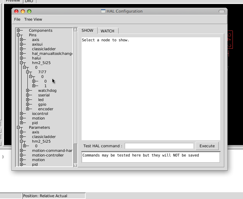

Andy, thanks for your response.
I did what you said and did this:
I do everything right, as cmorley says in pncconf I can see the inputs and outputs of "7i64" I read in the manual must encenderce the green "CR12" indicating that all is well but it does not, it stays on the red CR11.
Something I did not understand the cmorley response is this:
This will work as long as you Have the current bug fixes available from builbot or by compiling yourself.
If you do not you will Have to wait till the next bug fix release Which is supposed to come out soon.
Chris.
that may be bad?

11 Oct 2012 16:21 #25243 by PCW
Replied by PCW on topic Re:5i25, 7i77 problem
can you try running this set if hal and ini files:
freeby.mesanet.com/7i77.zip
unzip them into (home)/linuxcnc/configs/hm2-servo
11 Oct 2012 16:32 - 11 Oct 2012 16:42 #25244 by PCW
Also is the 7I64 jumpered properly? I think Default is USB interface
(make sure W1,W2,W3 are up/down/up)
Last edit: 11 Oct 2012 16:42 by PCW.
11 Oct 2012 16:36 #25245 by jlviloria
Replied by jlviloria on topic Re:5i25, 7i77 problem
blessed language, limiting ... besides that not much ... lol
But I'll keep trying ...
"5i25" and "7i77" perfect work.
"5i25", "7i77", "7i64" works, linux smoothly opens in PnCConf, I can see the inputs and outputs of "7i64".
settings as I do?
I am guided by what Chris said in a thread:
chris wrote:
Here is how to get what you want.
on the table I / O - config page September the number of encoder to 6 and the number of channels sserial to 3 and press 'accept changes'
this gets rid of the second 7i77 board components and Allows them to be GPIO (You Will See That tab on the connector 2)
Now on the connector 3 tab look for the smartserial # 2 combo box. second box down left side.
select the 7i64 board and a tab will Appear - 'smart serial # 2'
This is the tab to configure the 7i64 board.
Chris
but when I open linuxcnc find nothing about "7i64". of the rest everything is perfect.
I recognize the "7i64"
seriously sorry that trouble.
thank you very much.
11 Oct 2012 16:40 #25246 by jlviloria
The real question is:
as I view the inputs and outputs of the "7i64"?
everything seems fine but not see them.
11 Oct 2012 16:53 - 11 Oct 2012 16:59 #25247 by PCW
Is the 7I64 jumpered properly?
as I mentioned before The default jumpering is for USB interface:
(W1,W2,W3 = UP,UP,UP)
for sserial/LinuxCNC you need 2.5 MBaud serial:
(W1,W2,W3 = UP.DOWN,UP)
Last edit: 11 Oct 2012 16:59 by PCW. Reason: ommision
11 Oct 2012 17:00 #25248 by jlviloria
Peter.
I have not moved the jumpers this as manufactured
buy the serial cable and connect it to TB2 of "7i77"
right now you only the red LED "CR11"
thanks
11 Oct 2012 17:01 #25249 by PCW
Did you set W1,W2,W3 to UP,DOWN.UP?
11 Oct 2012 17:03 #25250 by andypugh
Replied by andypugh on topic Re:5i25, 7i77 problem
jlviloria wrote:
halcmd: show pin
Component Pins:
Owner Type Dir Value Name
5 bit OUT FALSE hm2_5i25.0.7i77.0.0.input-00
5 bit OUT TRUE hm2_5i25.0.7i77.0.0.input-00-not
The 7i64 pins should be listed here.
It seems that Hostmot2 isn't seeing the 7i64.
I think you might be being confused by the interaction between PNCConf and the rest of LinuxCNC.
PNCConf has no idea what smart-serial cards you have attached. It tries to set up the card you tell it is attached, whether or not that card is attached and working.
I think that PCW might have guessed the problem, is your 7i64 set with the jumpers for serial connection and for cable power?
W1 W2 W3
UP DOWN DOWN 1.25 MBAUD
UP DOWN UP 2.5 MBAUD FOR SSERIAL
UP UP DOWN 5.0 MBAUD
UP UP UP USB INTERFACE SELECTED
You need the jumpers W2 W3 W4 to be UP - DOWN - UP.
