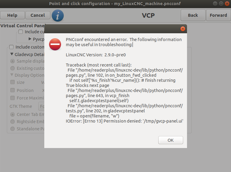

thank you, so should I leave the other inputs unused or is there a way to configure enable, fullste, fault and reset functions?
- Posts: 18063
- Thank you received: 5308
06 Nov 2020 21:08 #188541
Replied by PCW on topic pncconfig error
You would need to connect these by hand in the hal file

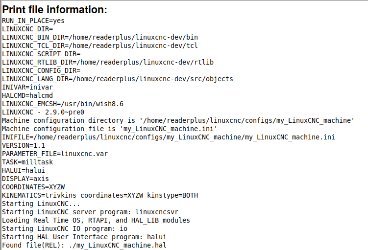

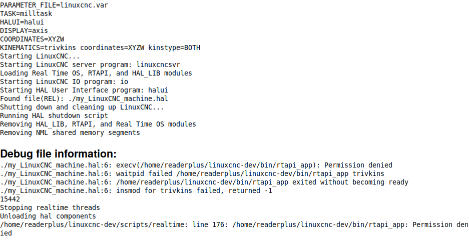

looks like you might not have done the:
sudo make setuid
step when building
sudo make setuid
step when building

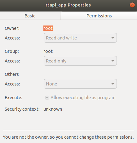

You need to run that from
~/linuxcnc-dev/src
~/linuxcnc-dev/src

It looks like your LinuxCNC installation is broken in some basic way
How did you install LinuxCNC?
