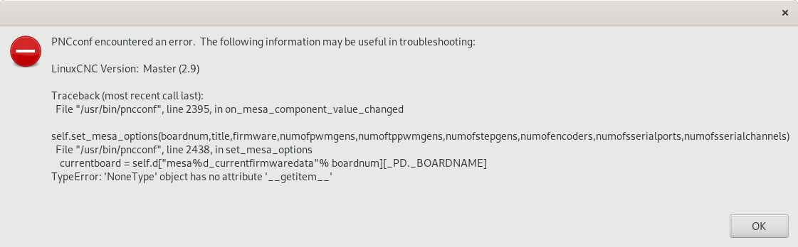

12 Dec 2020 18:42 #191763 by travis036
Replied by travis036 on topic Mesa 7i80HD-16: startup errors
still same error...
i scrapped the former config, and tried a new one, but when i load the 7i80 data, from "/lib/firmware/hm2/7i80hd_16" (where i piled the Mesa BIT files), i get the following error when i try to accept changes.
so i assume i have yet again screwed something up...
~Travis

12 Dec 2020 19:04 #191766 by tommylight
Replied by tommylight on topic Mesa 7i80HD-16: startup errors
There is no need to load or use any firmware now, just do a config, save and close pncconf, and start that config.

12 Dec 2020 20:12 #191774 by travis036
still getting errors...
12 Dec 2020 20:14 #191775 by PCW
Replied by PCW on topic Mesa 7i80HD-16: startup errors
Looks like the same firmware
Did you reset the 7I80 after loading the new firmware?

12 Dec 2020 20:20 #191776 by travis036
no, didn't know i was supposed to... :unsure:
just power-cycled it, and i get a new error. my guess is i picked a firmware with no PWM
12 Dec 2020 20:24 #191777 by PCW
Yes, a ST12 config would not have any PWMgens
Mesaflash should have printed a message that you need to power
cycle the board or used the "reload" command to use the new firmware
