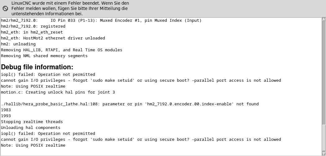

Replied by WKS-3D on topic Glasmaßstab EIA-422 an Mesa 7i85 (S)
@PCW
Sorry for only getting back to you now, but I've only just had a chance to try it out.
When I insert this:
setp hm2_7192.0.encoder.00.index-enable true
and comment out this:
net x-index-enable joint.0.index-enable <=> hm2_7i92.0.encoder.00.index-enable
I get an error message when starting LinuxCNC.
The complete section for the X-axis looks like this:
What's wrong?

13 Sep 2025 12:03 #334917
by WKS-3D
- Hakan
- Posts: 1317
- Thank you received: 453
13 Sep 2025 12:13 - 13 Sep 2025 12:13 #334918
by Hakan
Replied by Hakan on topic Glasmaßstab EIA-422 an Mesa 7i85 (S)
We would like to see the error you get.
Nevertheless, I happen to know why. It's because index-enable is an IO pin, it's both input and output, a bit special.
So you can not set it to true, only connect it to a pin that is IO both input and output. Such as joint..index-enable
Relevant links www.linuxcnc.org/docs/html/drivers/hostmot2.html#_pins_5
linuxcnc.org/docs/html/man/man9/motion.9.html#JOINT%20PINS
Last edit: 13 Sep 2025 12:13 by Hakan.
- Posts: 18065
- Thank you received: 5308
13 Sep 2025 13:58 - 13 Sep 2025 14:08 #334924
Replied by PCW on topic Glasmaßstab EIA-422 an Mesa 7i85 (S)
Actually you can:
As long as hm2_7192.0.encoder.00.index-enable is not connected to
a signal in the hal fiie. It will be set true once at LinuxCNC startup.
The error you have is that you did not comment out the net command connecting
hm2_7192.0.encoder.00.index-enable to the signal x-index-enable:
# ---Indexsignal GMS fuer Referenzpunkt X (NICHT MIT NORMALEM ENDSCHALTER)
net x-pos-fb <= hm2_7i92.0.encoder.00.position
net x-vel-fb <= hm2_7i92.0.encoder.00.velocity
net x-pos-fb => joint.0.motor-pos-fb
net x-pos-rawcounts <= hm2_7i92.0.encoder.00.rawcounts
But for testing it's better to do this in halshow
Note that while you cannot change hm2_7192.0.encoder.00.index-enable
in halshow (or the hal file) if it's connected to a signal, you can
change the signal ( x-index-enable) in halshow for testing.

- WKS-3D
- Posts: 114
- Thank you received: 16
14 Sep 2025 07:25 #334965
by WKS-3D
That's what I did:
but it doesn't work
but it doesn't work

14 Sep 2025 07:48 #334968
by WKS-3D
I changed it as follows:
# ---Encoder Feedback Signals/Setup
setp hm2_7i92.0.encoder.00.counter-mode 0
setp hm2_7i92.0.encoder.00.filter 1
setp hm2_7i92.0.encoder.00.index-invert 0 # war 0
setp hm2_7i92.0.encoder.00.index-mask 0
setp hm2_7i92.0.encoder.00.index-mask-invert 1 # war 1
setp hm2_7i92.0.encoder.00.scale [JOINT_0]ENCODER_SCALE
#net x-index-enable joint.0.index-enable <=> hm2_7i92.0.encoder.00.index-enable
but I get this error message:
- Posts: 18065
15 Sep 2025 03:16 #335004
Not sure what that issue is, the "cannot gain I/O privileges" is not related to index at all

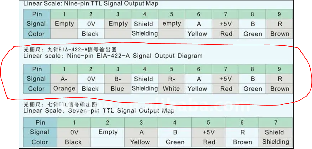

I tried a few more things and just couldn't get anywhere. So I decided to take another look at the wiring and the 7i85. I noticed that the jumpers for the signal are not set to RS-422 (in the down position) but to the up position for TTL signal.
Unfortunately, the nine-pin TTL signal pin assignment is the same as the RS-422 assignment, except that A-, B-, and R- are omitted. The signals are then ignored anyway. So there's probably no point in changing the jumpers.
Or should I try?
Or should I try?
