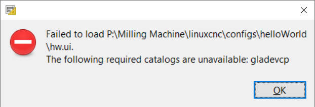

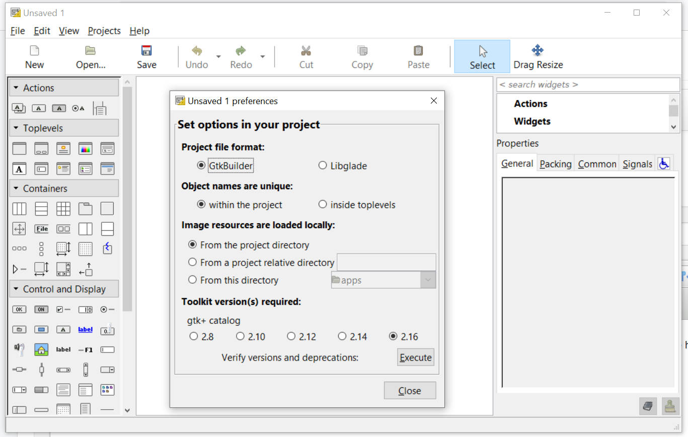

11 Aug 2023 07:24 #277608
by jcdammeyer
Replied by jcdammeyer on topic gladevcp catalog, and other questions
I realize this is a bit of a drift from the original poster working inside Linux but a google search for the missing gladevcp error led me here.
Running WIN-10 I can go here and download the glade IDE.
sourceforge.net/projects/gladewin32/
Running the installed application I get this:
Then when I load hw.ui I get the following error:
So looking at the IDE options I can go to Edit | Preferences and bring up that dialog show in the first screen grab. There's the ability to put in the path to the icons. But not a heck of a lot of other options.
On top of that, other than in a comment in the .ui file there's nothing that explicitly states that gladevcp even needs to be included.
So if we look other IDEs be it Arduino, Delphi, MPLAB from Microchip, CodeWarrier etc. etc. etc. there's nothing like a C program with include files or project options that can be set up to state where gladevcp is. Or for that matter what gladevcp is.
How do I tell the Glade IDE how to find this?

11 Aug 2023 08:34 #277616
by jcdammeyer
Thank you for your prompt response.
It looks like I was in error thinking that
<!-- interface-requires gladevcp 0.0 -->
<!-- interface-naming-policy project-wide -->
was a comment. Removing these two lines allowed the hal.ui to load into the glade IDE. It then displays a box but doesn't show the button and LED.
In either case that's not the point. If the Glade IDE requires a 'catalog' then what I'm asking is how to tell the Glade IDE where the 'catalog' is for linux CNC and what it consists of.
I can pull over any folders I need from the Raspberry Pi4 that can run LinuxCNC. And BTW, it throws up the same error when I run Glade on it.
So my question remains the same. The Glade IDE screen designer requires a path to a folder or set of folders in order to be able to load the icons and appropriate HAL connections.
So where are they for the 'simple' example hal.ui. If it can't figure out how to show the items described in the hal.ui then it certainly can't do the AXIS screen.
