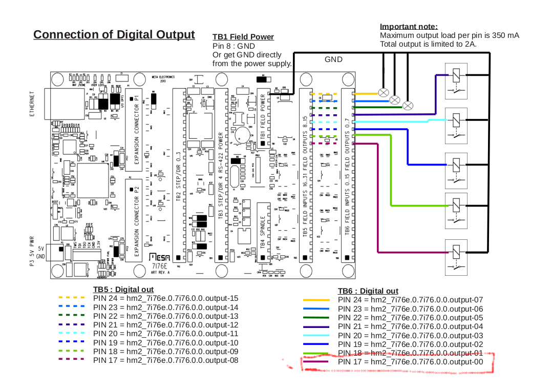

Hello,
I would like to have a header on my Linuxcnc interface that switches Pin17=hm2_7i76e.0.7i76.0.0.output-00 on and off on my Mesa7i76e. So far, I have created an LED and a button in Glade. This already appears on the Linuxcnc interface, but no control content is stored. How do I proceed? I tried to do some preliminary work on the Glade page, but failed. What do I need to do and where?

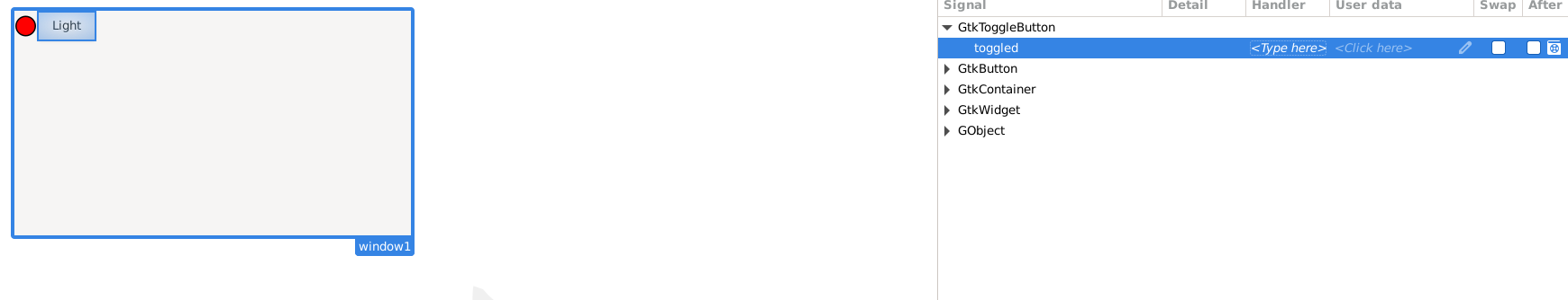

I only became a Glade user today... so I don't have any experience yet. Please take a look at the attachments. I have the following questions:
Do I have to enter something in Glade -> Light Button -> Signals -> Handler? Do I enter this handler in postgui?
I entered the command in postgui. This does not start linuxcnc. Do I have the correct command from Halshow for postgui.hal?

Can you help me understand how Glade and Handler work? I've already created the switch and the LED. How do I now connect them so that pin 17 switches on and off? I'm completly stuck.

If your Glade UI element is of type "Hal button" then the HAL pin will be created automatically and no handler file is needed.
(This is stated with 93% confidence, I don't have easy access to a LinuxCNC machine at the moment to test this assertion)
