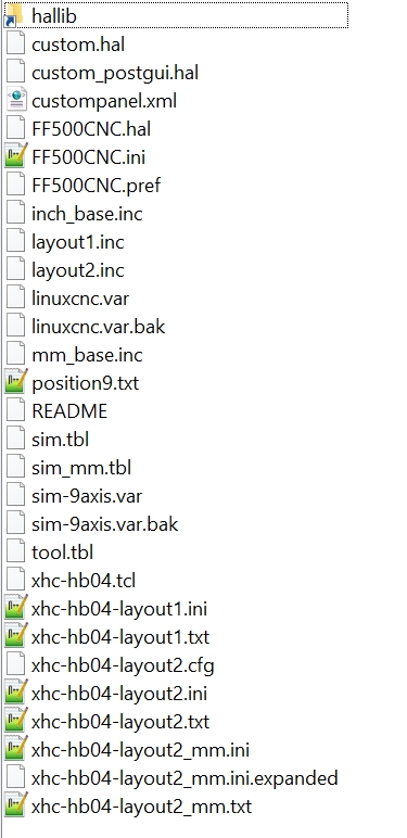

The fact that setting the spindle-at-speed pin to true allowed the machine to continue running confirms that your lack of a connection to that signal is your problem.
When you deleted the line "net spindle-at-speed => motion.spindle-at-speed" and Linuxcnc failed to start, It was because you have a connection to that signal in your custom post gui hal file. Could you share that file so we can make a better recommendation what you should try next?

07 Aug 2016 13:52 #78446
by jaro_p
Replied by jaro_p on topic The program always hangs after the command M3
Bingo!
In the file: custom_postgui.hal, it was this:
# Include your customized HAL commands here
# The commands in this file are run after the AXIS GUI (including PyVCP panel) starts
sets spindle-at-speed false
I changed the value false to true, and the program continues.
