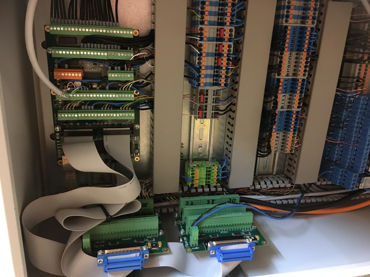

Hi , i have the 7i76E + 7i85s + 7i85 + 7i84
Bit file is in standard an works pretty well
