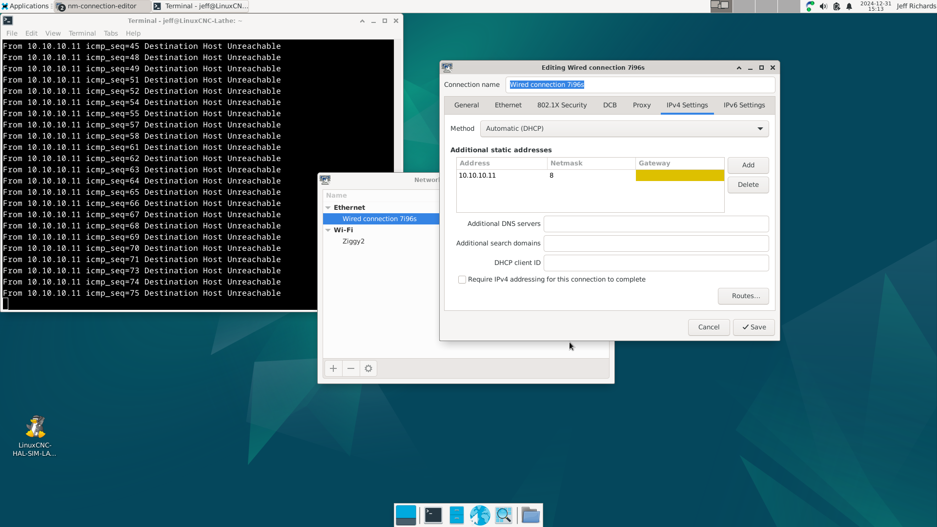

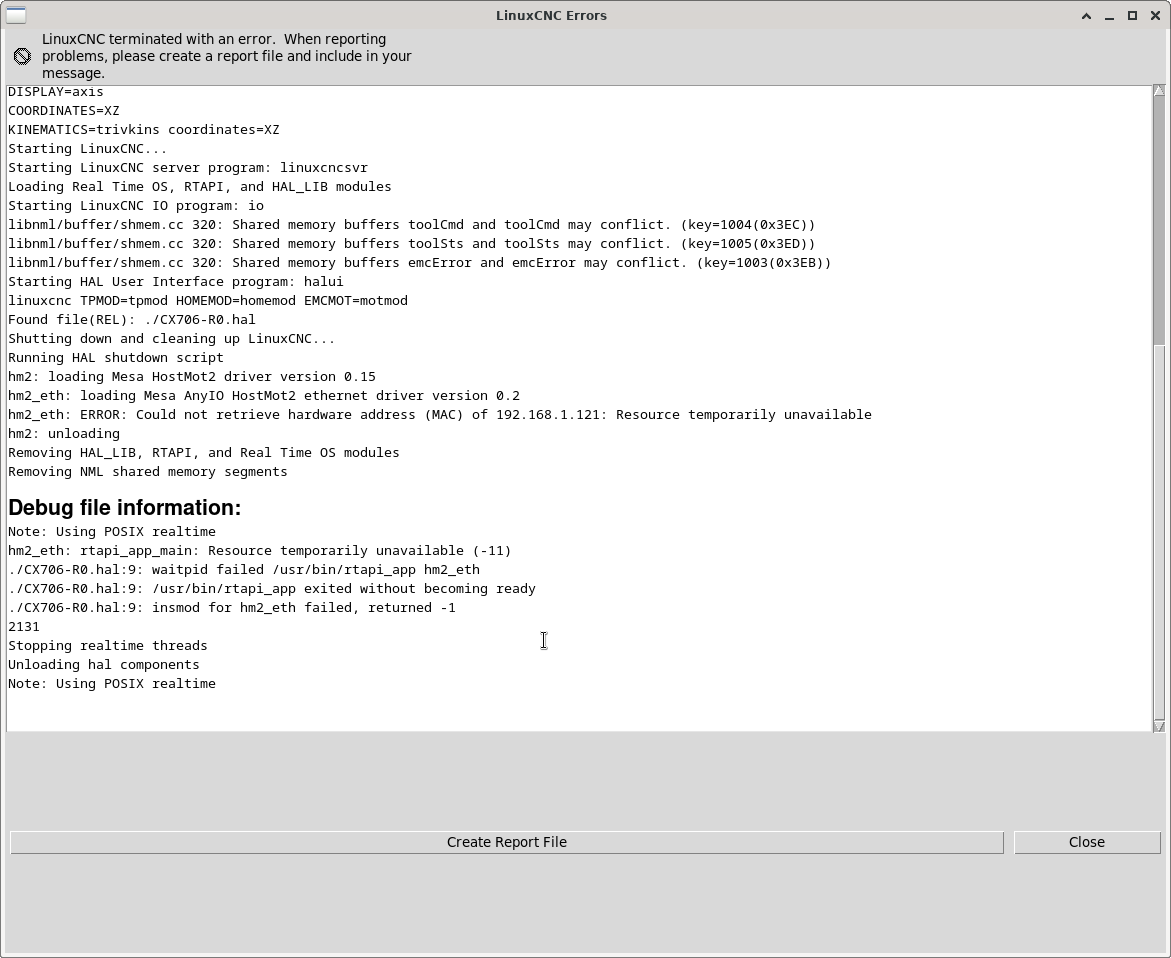

New installation of Linux2.9.3 on a Lenovo Yoga
I followed the tommylight Ethernet setup for 7i9x and can't seem to get Linux to recognize the 7i96s
Power LED and the green user LED's change status, I'm getting a swirly network icon up in the top right that I assume is indicating it's trying to connect.
Settings and error are as shown in attached.
I also tried moving the jumpers from the default 192.168.1.121 to EEPROM and same result except can't connect to 10.10.10.11
Suggestions?

31 Dec 2024 21:28 #317736
Replied by PCW on topic 7i96s not recognized
Set the IP address in the hal file to 10.10.10.10
(and make sure the 7I96S is set for 10.10.10.10)

31 Dec 2024 21:36 #317737
Apparently you missed a step, you still have it set to automatic.
Replied by tommylight on topic 7i96s not recognized
- choose "manual" on the "method" drop down menu

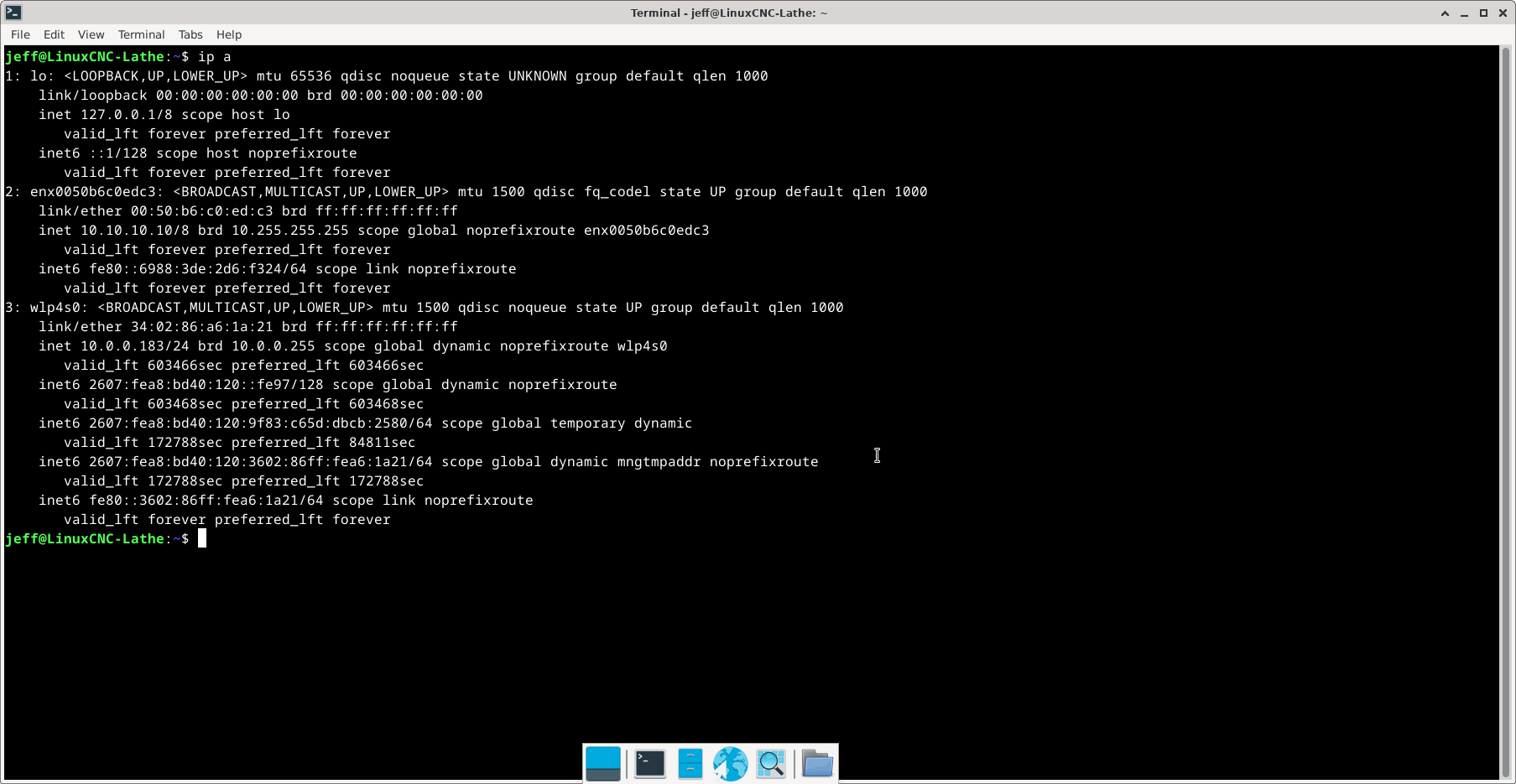

- Posts: 18093
- Thank you received: 5325
31 Dec 2024 22:34 - 31 Dec 2024 22:43 #317745
A couple notes:
1. The IP address in the hal file must match the Mesa card IP address
2. If you change the Mesa card's IP address jumper, you must cycle the card
power for the change to take effect
3. The host IP address cannot be the same as the Mesa cards IP address
but should be in the same 254 host subnet (only last digit different)
Also last digit cannot be 0 or 255.
4. You can determine you host IP setup with the command:
ip a
5. When LinucCNC is not running, you should be able to ping the card
for example:
ping 10.10.10.10
Beware: if you set the host address to say 10.10.10.10, you will get responses
to the ping command from the host rather than the Mesa card

01 Jan 2025 01:01 #317749
by slowpoke
Both the wired connection and CX7076-R0.hal are set to 10.10.10.10 and ipv4 is manual
I can now ping 10.10.10.10 (that's new)
Linux still does not start, might be #3 above host subnet?
please see ip a result attached.

01 Jan 2025 01:40 #317752
Yes, you are pinging yourself (I hear that may make you go blind)
I would set the host address to 10.10.10.100
