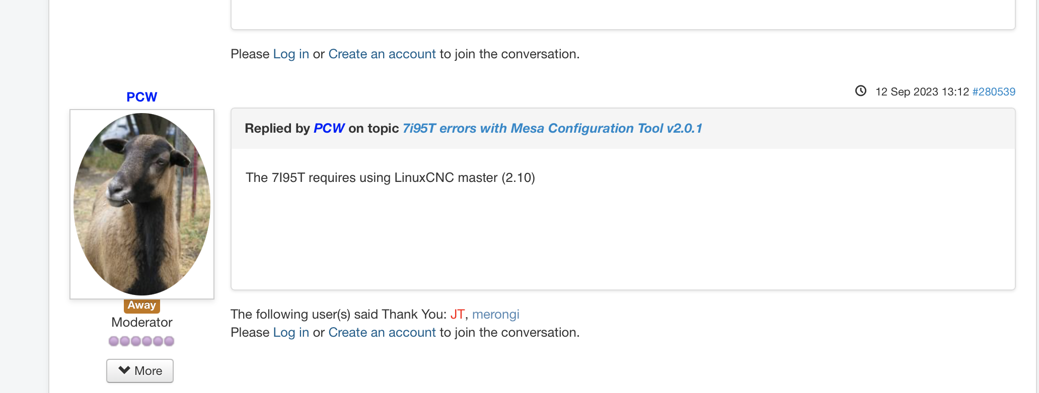

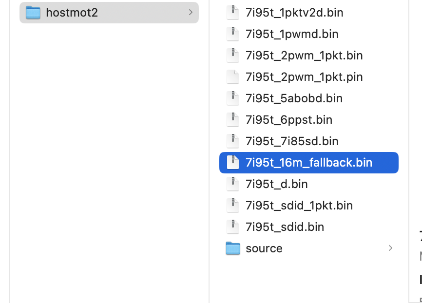

Hello,
i am beginner and (so far I can tell right know) successfully got my pi5 running with LinuxCNC 2.10 (which I read is required to run a 7i95T).
Sadly pncconf has no template for the Card, nor the combination of cards. So I decided to give mesact a try which at least knows the cards I got.
for my understanding, I need a firmware file to flash on my 7i95T to make the daughter card addressable. is that correct?
After downloading the firmware of the card and saving to the mentioned folder I recognized there is no firmware on the Mesa website available for my combination of cards?! or am I missing something? <screenshot appended>
can somebody help me out with it?

RPI is NOT required to run, it CAN be used to run LinuxCNC, any PC can be used to run LinuxCNC and Mesa cards.
On the Mesa subject, i do have somewhere a working 7i95 config if you need one, without the 7i77.
As for firmware, please do not proceed without consulting with PCW here, you seem to be bumping into some fishy info...
And for next time, when you have a 7i95 and you need to add analog outputs, use a 7i83 as 7i95 has encoder inputs. That is if you do not need all of the stepgens and encoders and analog outs and encoders...

Replied by PCW on topic 7i95T & 7i77
Which combination of cards do you have?
Oops should have read the title.
That's a fairly odd combination, what hardware interfaces do you need?
There is no standard firmware for the combination, but it can be built easily

what's wrong about the pi's?
for me right now the pi is just handy, because I have it here. maybe I change it to a miniPC at some point... I am not sure... but first I need to get a working cards/hal/ini
Replied by BloodyT on topic 7i95T & 7i77
I meant 2.10, not the pi
....successfully got my pi5 running with LinuxCNC 2.10 (which I read is required to run a 7i95T).
Where did you read that?
