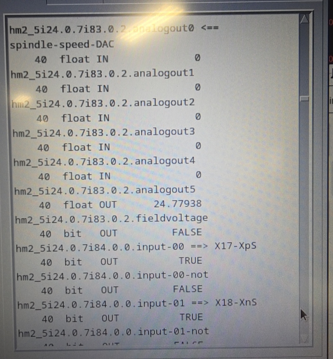

Thank you for letting me know about halshow. There is a wealth of data in here that will be VERY helpful. Unfortunately, the image size exceeds allowable data limit so I can't attach them just yet. Looking into reducing the file size.

This should work.

Replied by TheTinkeringMechanic1 on topic Spindle speed?
Digging into a bit deeper, whenever I run it in reverse the setting jumps to 8.25 and stays there. If I run it forward it stays around 2.69 with some variation in the next 5 digits. It moves up and down with speed adjustment.

03 Aug 2025 00:11 #332702
Sorry, I guess the images didn't upload. "hm2_5i24.0.7i83.0.2.analogout0 <= spindle-speed-DAC" reads in forward and reverse. In reverse it shows a reading of 8.25 and stays there, doesn't move when trying to adjust the speed.. In forward it stays around 2.69 with some variation in the next 5 digits. It moves up and down with speed adjustment.
- Posts: 18075
- Thank you received: 5314
03 Aug 2025 00:27 #332703
Replied by PCW on topic Spindle speed?
Its a bit tricky to setup a PID speed control with a unipolar analog control
and FWD/REV signals.
I would first try eliminating the feedback by running the spindle open loop
you can do this by setting all PID terms to 0 except FF0 which should be set to 1.0
If you need feedback (this is rare unless the spindle speed control is very poor)
The structure needs to be like this:
PID command = signed commanded spindle speed in RPM
PID feedback = encoder RPM
PID output --> ABS --> analog out
ABS sign (of PID output) determines the FWD/REV pins
