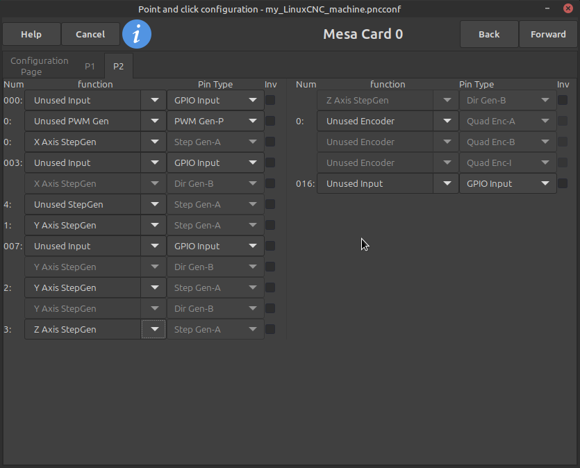

Help with tandem axis Y
  • tommylight
  • tommylight's Avatar
  • Away
  • Moderator
  • Moderator
25 Sep 2025 00:24 #335391 by tommylight
Replied by tommylight on topic Help with tandem axis Y
Yes.
Or any other combination, except tandem joints can not be on the same pin, so you can have XYZ on 1 pin and the Y2 on the 2 pin.
Check point 2 for you situation.
The following user(s) said Thank You: RikoBR
25 Sep 2025 22:47 #335441 by RikoBR
Replied by RikoBR on topic Help with tandem axis Y
Thank you Tommy and Djdelorie, i appreciate your help so far, i had a few minutes and disconnected probe and assign individual pins and did not work but i did not have much time and I will be away form the shop probably till Tuesday (which sucks because i want to convert this machine so bad) but i like the idea of only using 2 pins this way ill end up opening one output. and ill get back here to report how ever i did not find the option of assigning multiple stepgens to one pin so i assume it will have to be done in .hal and .ini??!! ill include those once i try (if i get a chance ill sneak in the shop on Sunday (fiancé permitting lol)
thank you again for the help
