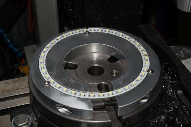

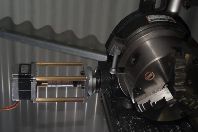

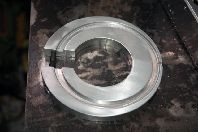

I personally don't think there is any benefit in the dealing with the backlash for a dividing head on a manual machine because you are not going to be using it for milling operations. For indexing, you just need to make sure that you only go in one direction which is the way we've used manual machines since they were invented. Then backlash does not exist.
It quite simple to mount a motor to one. Using mounting posts like this makes it very easy to align the motor.
you can do circular milling operations but on my 90:1 table the rpm maxes out at about 4 RPM so maybe a 40:1 is good for say 8-10 rpm
This is a mount for a spindle light for my Seig SX3 mill
The LED ring is for a headlight which we bought off eBay.
Replied by rodw on topic Universal dividing head with absolute encoder
I have got universal dividing head
