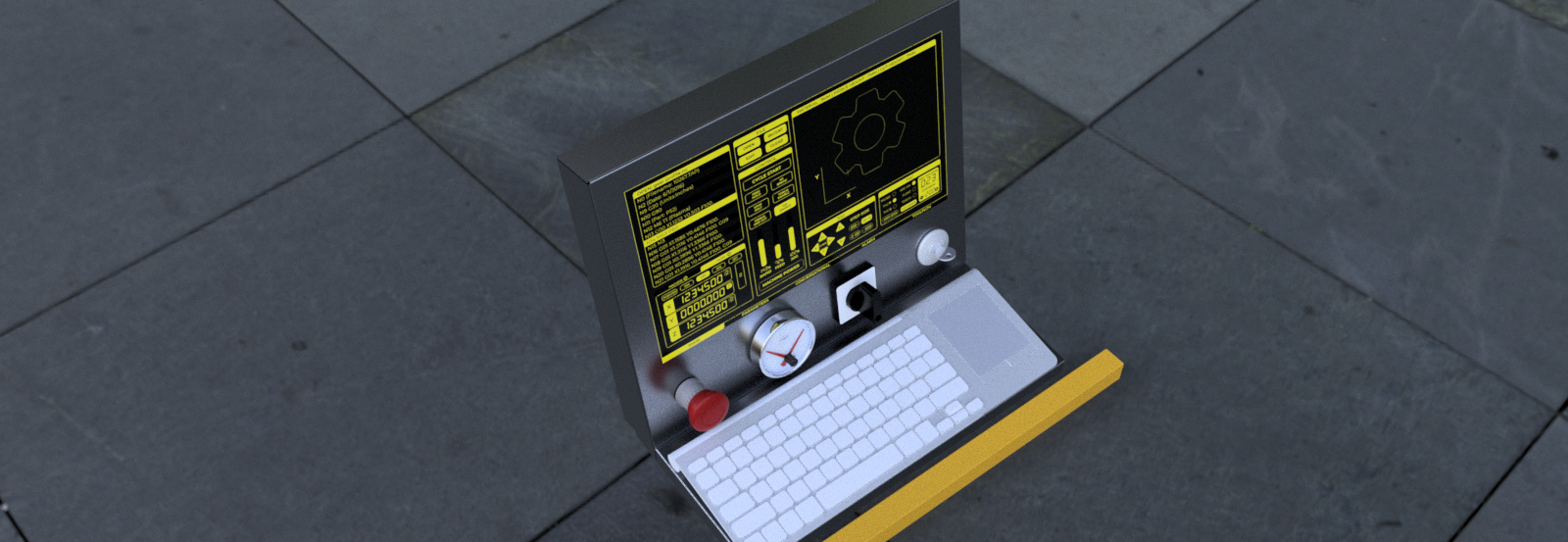

Hi everyone, I designed GUI for plasma machines and @KCJ is developing the QTPYVCP for that. You can check that out
here
Now, I wanted to share the idea for a physical controller along with the touch GUI.
I will share here design files, and specially sheet designs so that you can cut and make one.
I'll update the github links here.
Suggestions and criticisms are welcome.
Want any change just ask.
checkout the render
checkout the render

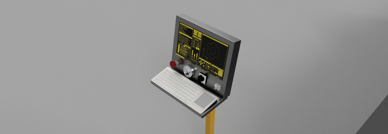

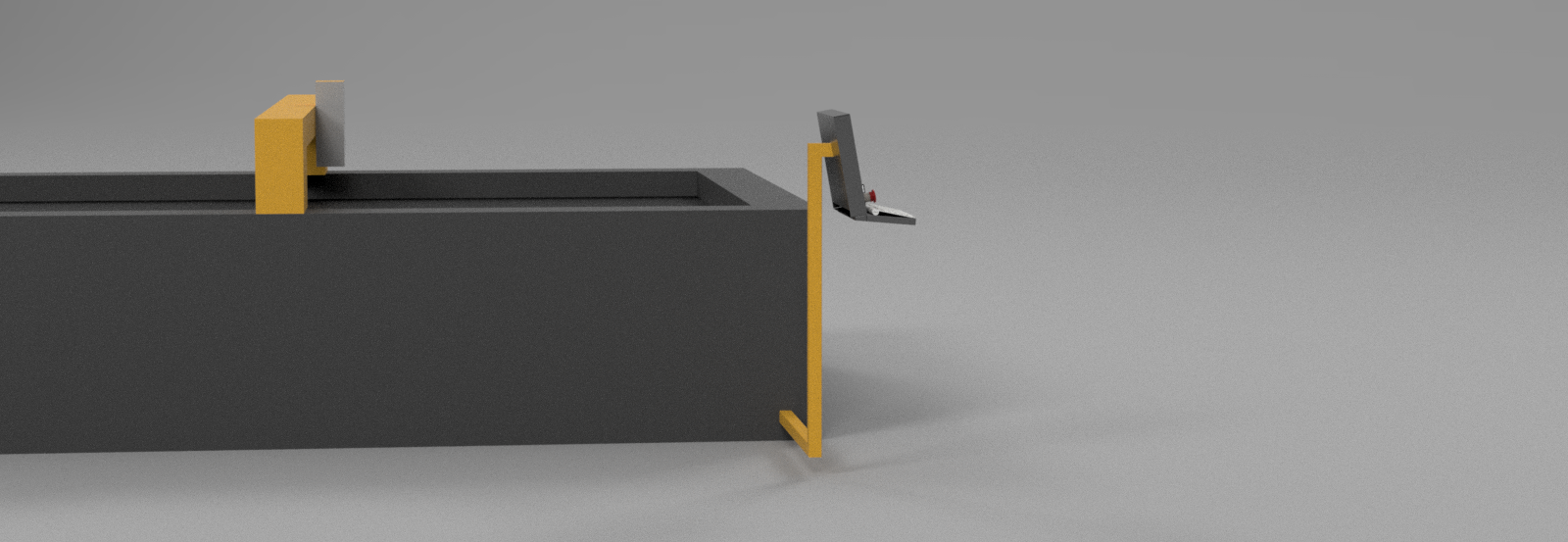

Looks like a couple of us had the same idea with Pinder's developing GUI. I've had this idea in my head for a long time.
15.6" monitor. Entry level is an Asus VT168 touch screen but there are industrial panels the same size available but they cost 6-7 times the price.
I had in mind the keyboard would be in a separate hook on arm that mounts to a similar upright post so it could be removed. You don't often need a keyboard and if the GUI is full featured with separate popup alpha and numeric data entry.
I need to make the mount to see if it actually works!

Yeah thats what I was thinking if keyboard could removed altogether.
As the GUI is fully featured, thanks to Kurt.
Next time I'll remove the keyboard and move the the Switches to left or right.

Thanks, I am struggling trying to learn Fusion 360 at the moment. Its quite different to what I'm used to.
I've only got a couple more parts to draw and we'll be done aside from making sure the cutouts are all correct. I roughly drew a monitor today so I just need to make the monitor mount and the back.
I don't mind sharing the files when I get a bit further. If you use F360, maybe you can help I can share it. I think I can share it with other users.
The wireless pendant is from XHC but a more industrial version so it does not use USB. It has a hard wired receiver that plays with Mesa cards perfecctly.
