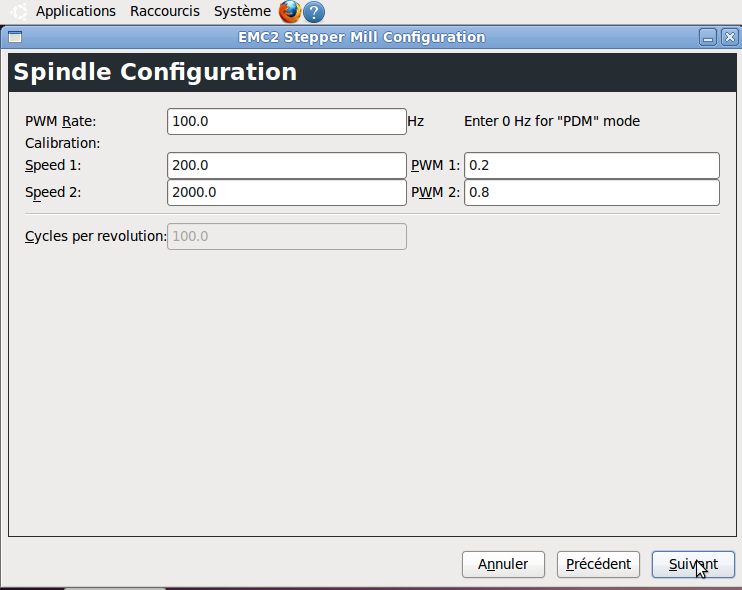

- caloups67
- Posts: 2
12 Nov 2010 19:44 - 12 Nov 2010 19:53 #5275
by caloups67
Replied by caloups67 on topic Re:setting up EMCO Compact 5 PC
Last edit: 12 Nov 2010 19:53 by caloups67.
