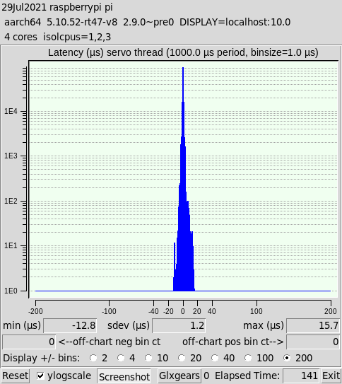

11 Aug 2021 15:08 - 11 Aug 2021 15:23 #217552
by elovalvo
Replied by elovalvo on topic RPI4 Raspbian 64 bit & LinuxCNC
To continue experimenting with using LinuxCNC with a 64-bit kernel on Raspberry Pi 4 I have updated the SD image.
The image, downloadable at the following link:
drive.google.com/file/d/1WhEeqCz0PC6oucp...XUs/view?usp=sharing
is based on Linux raspberrypi 5.10.52-rt47-v8 with PREEMPT_RT and is precharged with the LinuxCNC 2.9.0~pre0 version.
Can be installed with Raspberry Pi Imager
www.raspberrypi.org/software
that in the latest version allows you to modify some startup parameters by using hidden commands that can be accessed with the CTRL+SHIFT+X key combination.
This is latency test obtained from command:
latency-histogram --nobase --sbinsize 1000 --show

12 Aug 2021 10:51 #217595
Replied by tommylight on topic RPI4 Raspbian 64 bit & LinuxCNC
What happens when adding some glxgears and minimise/maximise them ?

14 Aug 2021 19:54 #217767
by cakeslob
Replied by cakeslob on topic RPI4 Raspbian 64 bit & LinuxCNC
Trying to test out the new image elovalvo, your work is appreciated, but just a few comments
For some reason, every image I download from you (this is the 4th so far), it says the image is corrupted when I unpack the rar files. Ive even redownloaded and it still says corrupted but images appear to load fine.
Unpacked, this image is 8gb so it takes a long time to load it to sd card, I think it took me like 3-4 hours or something.
Lastly, what power supply/setup are you using? When I load the 2.9pre_rt64a on my setup it is incredibly power hungry. it boots the os, but trying to do anything causes huge latency spikes related to not enough voltage. I can assume the improved latency is related to the power draw, but ive only been able to successfully run these images on a CM4 with 12v power supply. this newest one with even latency improved even more(2.9pre_rt64b), I cannot fully boot to os on 2 of my setups so far(normal RPI4). I will try a few more later today, and report back.
That being said, I have had unwavering success with the 32bit 5.4 images you posted some time ago, and have it loaded on several of my setups without issue. Thank you for your work.
