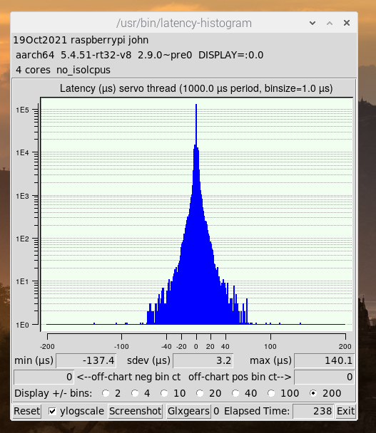

19 Oct 2021 11:14 #223572
by BigJohnT
Replied by BigJohnT on topic RPI4 Raspbian 64 bit & LinuxCNC

19 Oct 2021 18:28 - 19 Oct 2021 18:30 #223604
by cakeslob
Replied by cakeslob on topic RPI4 Raspbian 64 bit & LinuxCNC
How is it with isolcpus 1,2,3?
Last edit: 19 Oct 2021 18:30 by cakeslob.
- Posts: 22030
- Thank you received: 7504
19 Oct 2021 19:38 #223608
Replied by tommylight on topic RPI4 Raspbian 64 bit & LinuxCNC
I have seen worse, and worked quite reliably with Mesa 7i92.
Attach a Mesa board to it, leave it on for a day or two and do stuff occasionally see if it drops the link.
- Posts: 12172
- Thank you received: 4154
19 Oct 2021 21:22 #223618
Replied by rodw on topic RPI4 Raspbian 64 bit & LinuxCNC
I also think this is fine for a Mesa card. I don't know if it will work on a PI but isolcpus=1,2,3 idle=poll made a significant difference on my J1900I have seen worse, and worked quite reliably with Mesa 7i92.
