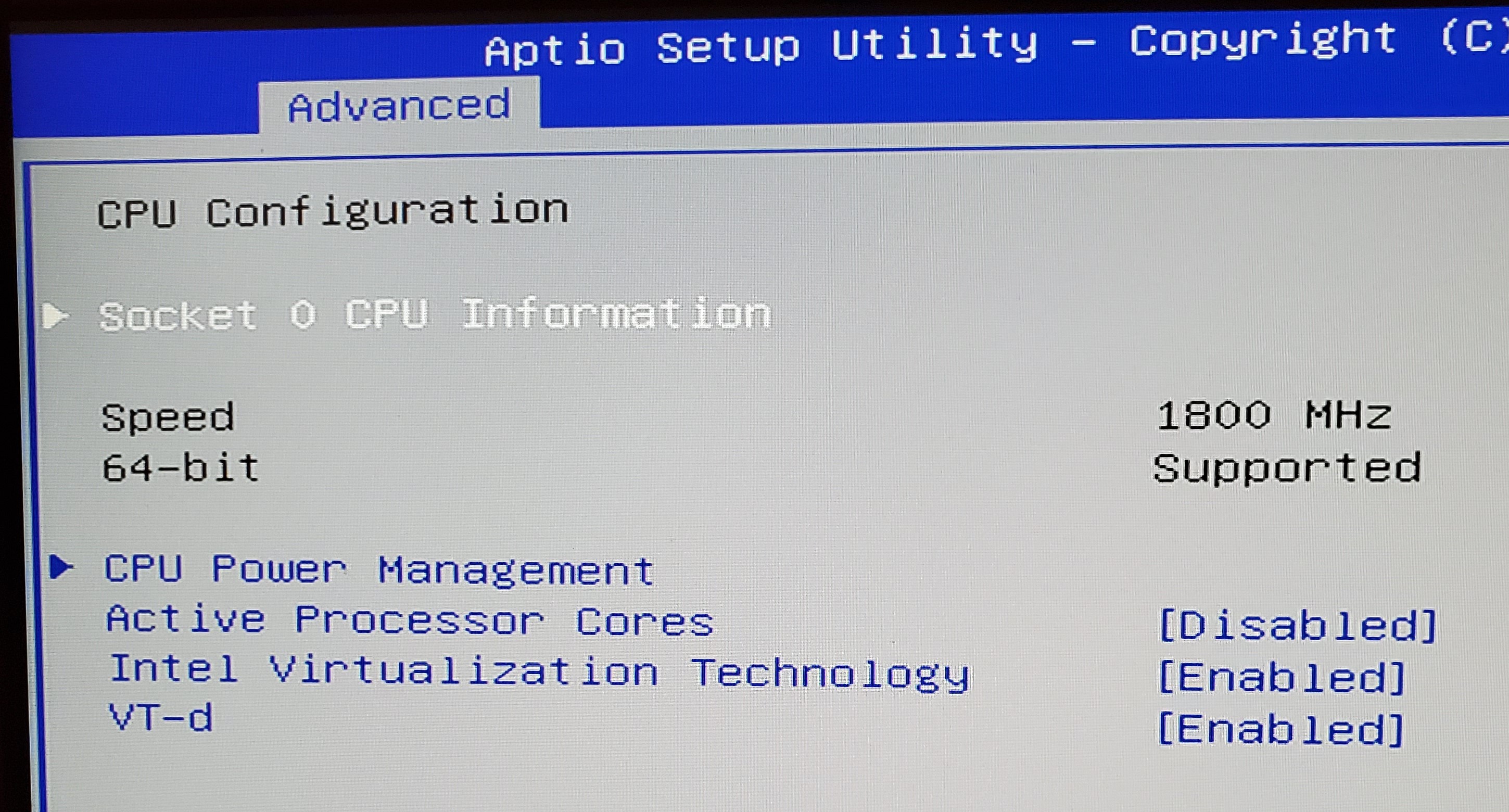

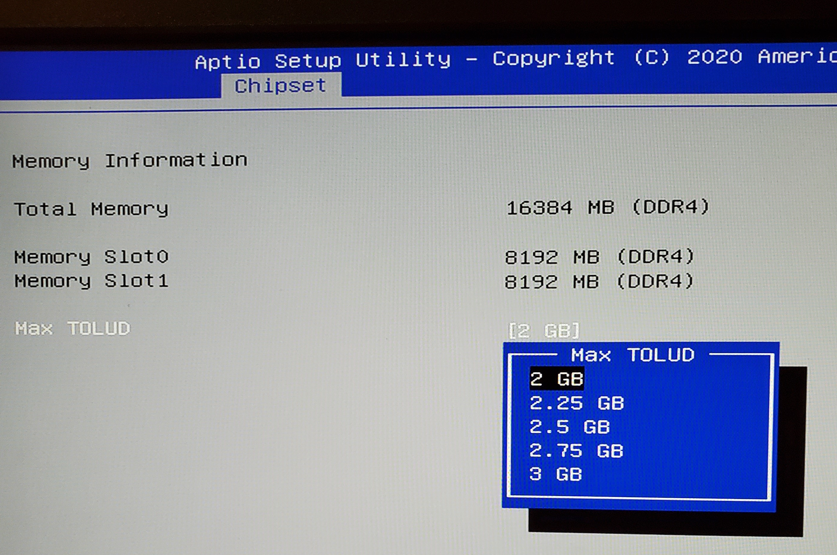

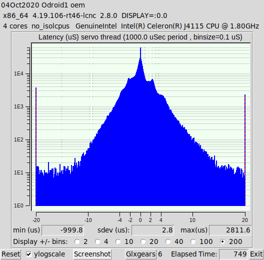

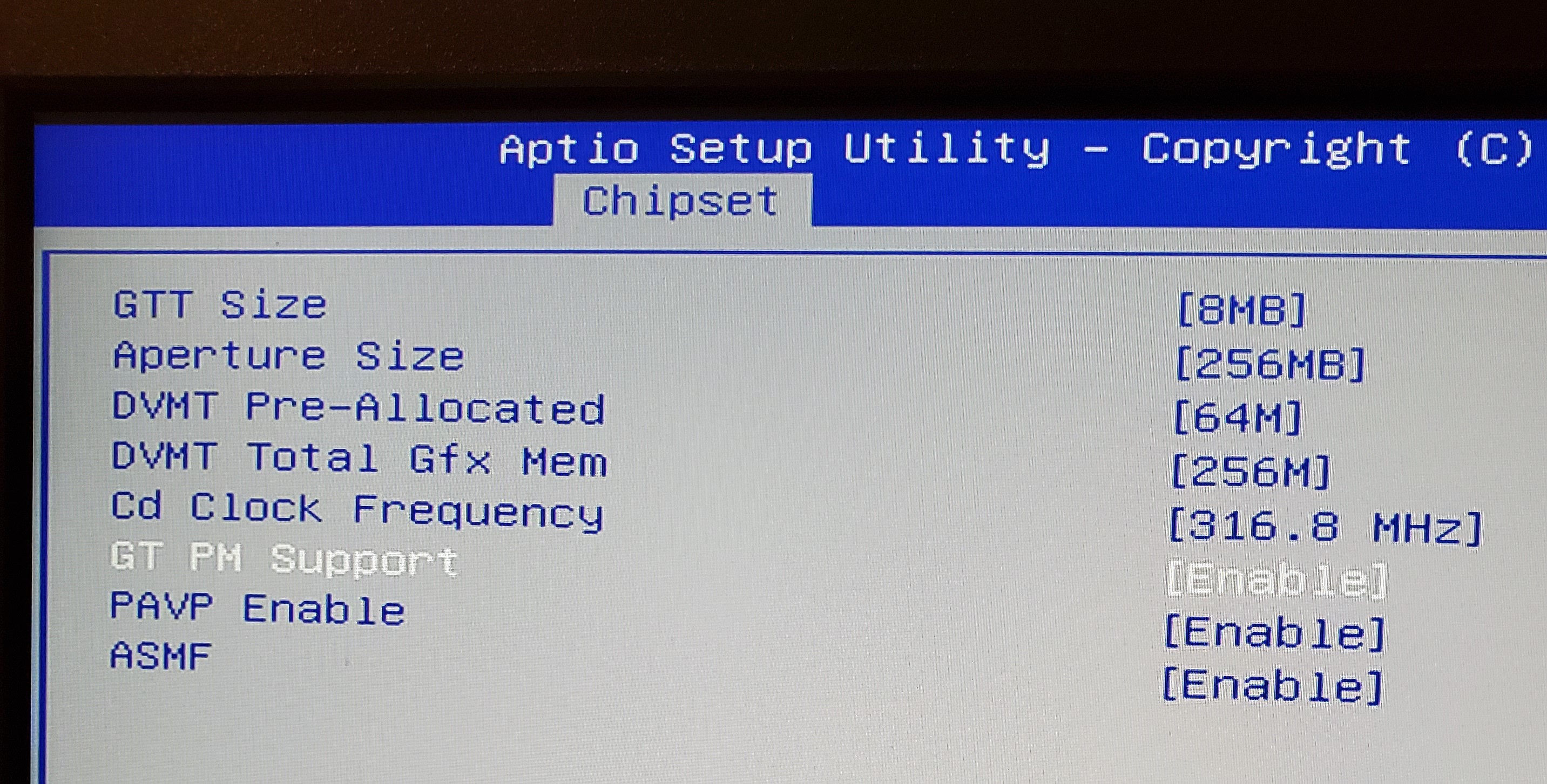

Hey Mr. Brainz, I've got the Odroid H2+ running, 16GB RAM, 256 SSD drive. I don't know how to read these latency tests, but I don't get a sense this is good.
Do you or any one have a list of bios tweaks? Tommy was talking about using AHCI and disabling serial-ata power saving. I'm about to poke around in there, but I really only know enough to be dangerous, as they say.
Here are a few of the settings that I feel might affect performance, but don't really know. I'd hate to recreate the wheel here. If any has tweaked this stuff before, please chime in.
Help me Obe Won Kenobi, you're my only hope.

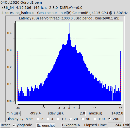

Here is another latency test after doing a few bios tweaks that seemed to make sense to me. I forgot what I did already. Not very methodical, I know. Oh wait, I remember one of the tweaks, there is a setting in there to tell the bios which OS you're using. The default was Windows, I changed it to linux.
Cheers,
T-
Cheers,
T-

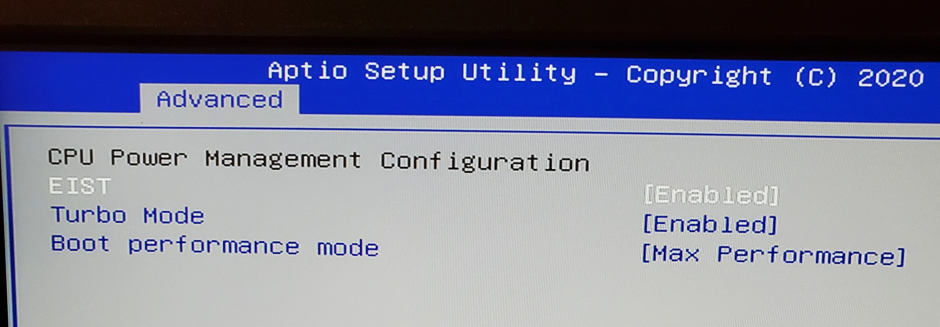

I would disable:
Intel Virtualization Technology
VT-d
EIST
Turbo Mode
and try again

Try This:All the other options I left default, Repeated the same for Port 2,3,4,5,6
The above made the biggest change.
Under CPU Configuration I haveAnd all four cores set to enabled
Under CPU Power Management ConfigurationWhich then disables the Turbo option anyways.
Other options were left as default
I've only tested with a NVME module. SATA & eMMC I can't vouch for.
Most recent tests haven't required isolating any CPUs.

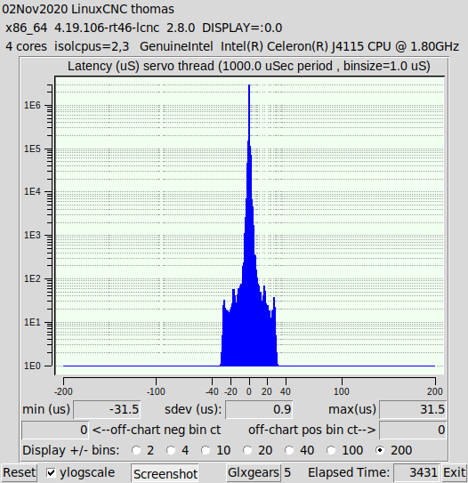

02 Nov 2020 19:19 - 02 Nov 2020 19:20 #188135
by thomaseg
Replied by thomaseg on topic Mint 19.3 Linuxcnc Odroid H2+
Last edit: 02 Nov 2020 19:20 by thomaseg.
The following user(s) said Thank You: rodw, BeagleBrainz
- Posts: 12156
- Thank you received: 4149
02 Nov 2020 20:38 #188150
Replied by rodw on topic Mint 19.3 Linuxcnc Odroid H2+
Very nice. I have two of them here waiting.....
