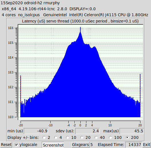

14 Sep 2020 16:37 - 14 Sep 2020 17:30 #182144
by BeagleBrainz
Replied by BeagleBrainz on topic Mint 19.3 Linuxcnc Odroid H2+
Brand new NVME, I stick with Crucial for SSDs as I’ve always found them to be top notch.
But yeah I’ll look into it.
Well that's strange.
Installed smart mon tools nvme-cli, checked NVME drive, all passes.
Running latency-histogram --nobase with youtube & 5 glx gears min us -33.2 max us 35.5 sdev us 2.5, only has been running for 5 minutes or so.

14 Sep 2020 21:27 - 14 Sep 2020 21:29 #182172
by BeagleBrainz
Last edit: 14 Sep 2020 21:29 by BeagleBrainz.
- Posts: 12172
- Thank you received: 4154
15 Sep 2020 03:17 #182191
Replied by rodw on topic Mint 19.3 Linuxcnc Odroid H2+
That looks really good Rob. Particularly in the absence of parallel ports and with two network ports, this is perfect for a mesa card.
