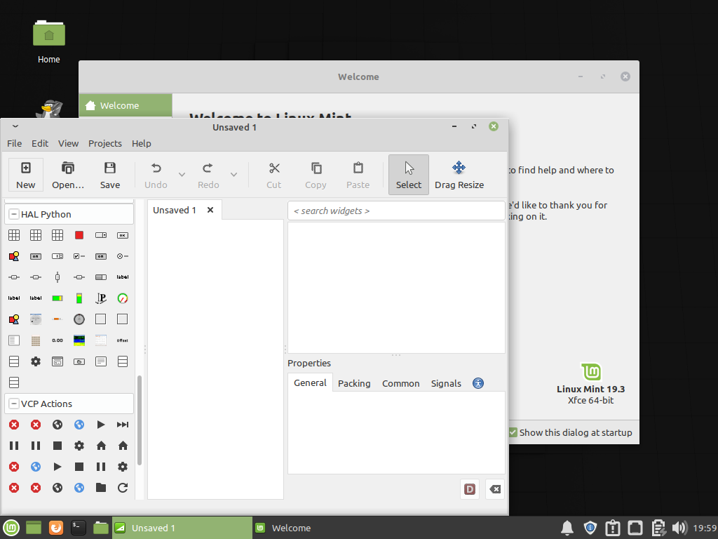

Yep. Just install all the usual deps and configure & build for uspace.
Or you could install the Mint 19.3 (which is Ubuntu Bionic )ISO I've created in a VM and use that. Running a realtime kernel in a VM is just like running one on a machine with really bad latency. That's how I do the initial tests of the ISOs. Of course this is you want 2.8 & you don't have too much invested in you Ubuntu VM.
Glade is included:
Glade is included:
