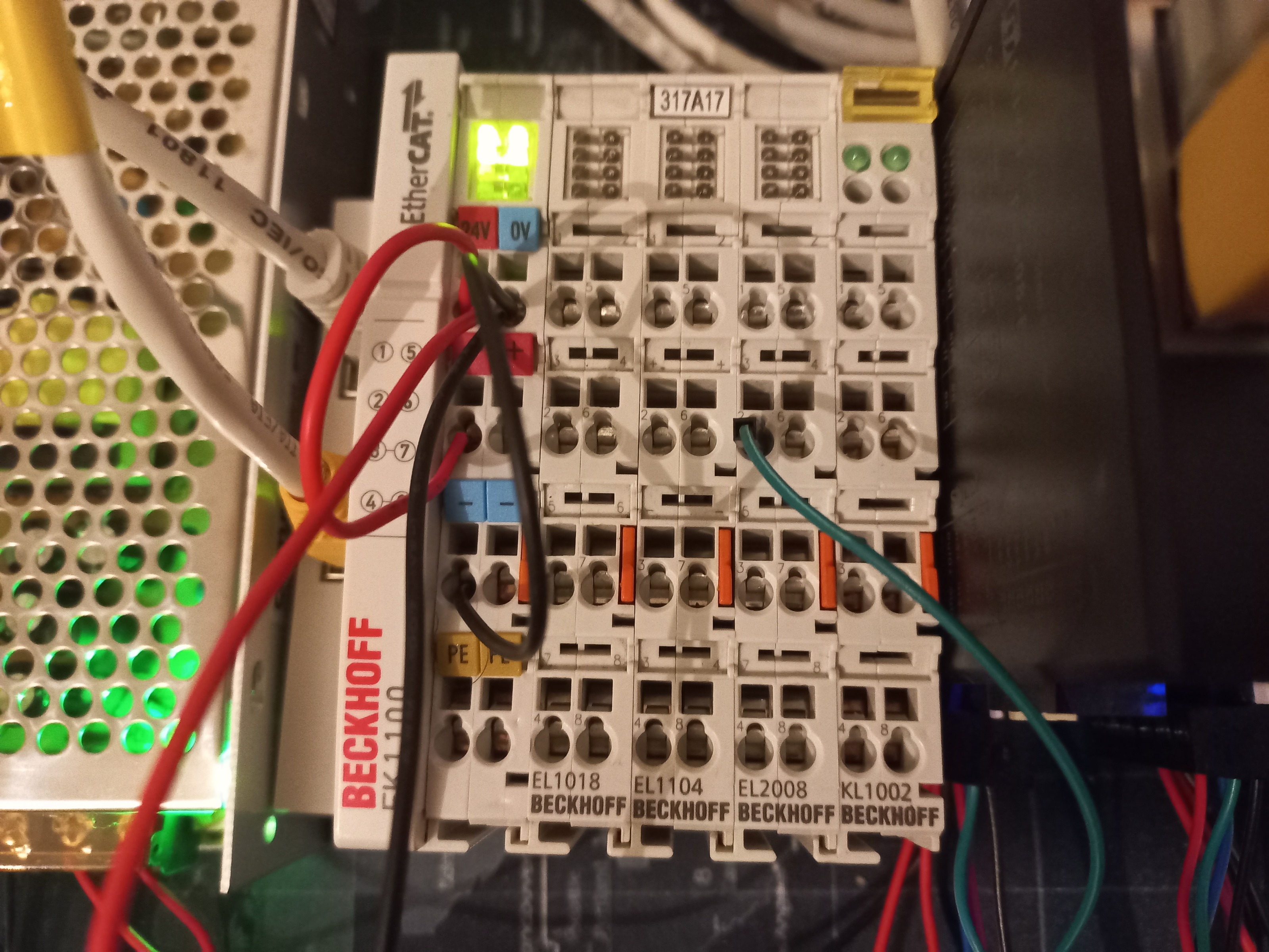

Hi everyone
I hope not to have the wrong section, this is my first post from Italy. I am installing linuxcnc on rpi with ethercat following the instructions of
Bouni whom I thank in advance for the work done
gist.github.com/Bouni/8b4532d0bdf012bd83c65d3eb62f8aa2
and MetalMusings
I followed the instructions step by step but arrived at the last stage:
halcmd setp lcec.0.<module-no>.dout-<output-no> <state>
halcmd setp lcec.0.3.dout-3 1 (knowing my el2008 device is the third slave)
I get the following error: <commandline>: 0: parameter or pin 'lcec.0.3.dout-3' not found
In addition, starting linuxcnc I get the following error:
HAL: ERROR: thread 'servo-thread' not found
I've searched for a file or function with the name servo-thread but can't find anything
I'm probably missing something.
Can anyone help me?

Edit the .INI file, there should be and entry for
servo-period
in the emcmot section, something like this:
servo-period
[EMCMOT]
EMCMOT = motmod
SERVO_PERIOD = 1000000Please Log in or Create an account to join the conversation.

If your device is the third slave it will have number 2, since slave numbers start at 0.Hi everyone
- Dj Junior

I entered SERVO_PERIOD = 1000000 in the axis.ini file but I get the same error

This error thread 'servo-thread' not found
pi@linuxcnc:~/linuxcnc/configs/sim.axis $ linuxcnc axis.ini
LINUXCNC - 2.8.2
Machine configuration directory is '/home/pi/linuxcnc/configs/sim.axis'
Machine configuration file is 'axis.ini'
Starting LinuxCNC...
application-specific initialization failed: no display name and no $DISPLAY environment variable
Error in startup script: invalid command name "."
while executing
". configure -borderwidth 0 -highlightthickness 0"
(file "/usr/lib/tcltk/linuxcnc/bin/popimage" line 35)
Found file(REL): ./ethercat.hal
Note: Using POSIX realtime
./ethercat.hal:3: addf failed

Well that should have gotten rid of that error, so do check again if it is added to the correct section, otherwise i can not think of anything causing that error.
Can you upload the ini file here ?

I would think you should add the HALFILE line as the last line in this section
Put it after the "HALFILE = check_xyz_constraints.hal" line.
Then there is something with the gui, are you running this without a display? Not sure how that works.
Also, with that specific ethercat-conf.xml you will not see the individual devices, just that ethercat is up and running. To get the devices in there is another ethercat-conf.xml; it is in a forum-posts further in that thread. As others already have pointed out, the devices in ethercat-conf.xml must be ordered the same way as you see in your listing.[/code]
