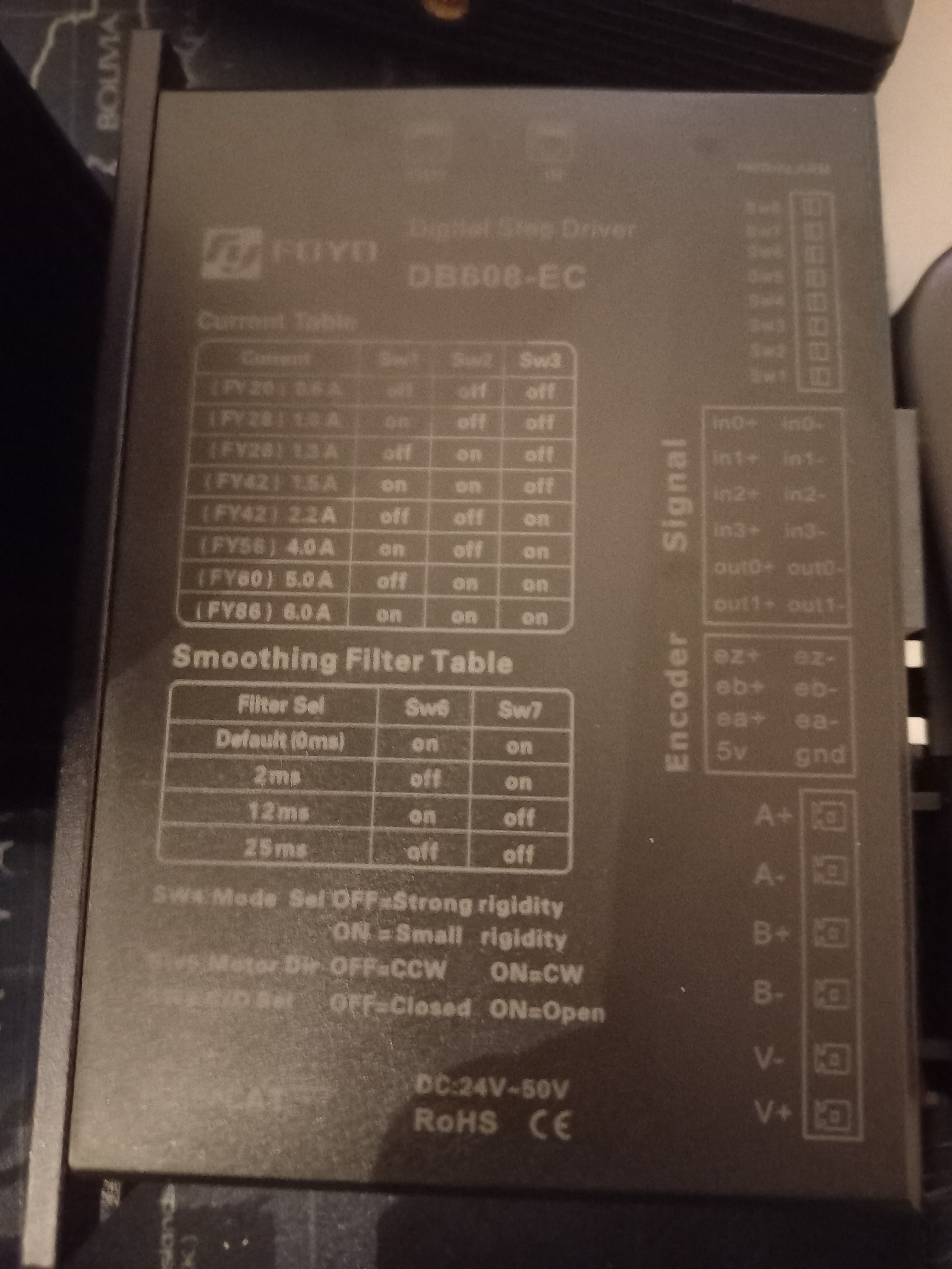

Wow Thanks a lot hakan
I moved HALFILE = ethercat.hal to the last line as indicated and now the error is gone linuxcnc is open and the command
halcmd setp lcec.0.3.dout-3 0 no longer gives errors
I updated the ethercat-conf.xml file with the devices connected except for the stepper driver. I have to read the documentation to understand how to configure them
i start linuxcnc with display via vnc
ethercaty-conf.xml updated
<?xml version="1.0" encoding="UTF-8"?>

by Hakan
Replied by Hakan on topic (Need Help) Linux CNC + EtherCat + RPi 4 Setup
Great, then it works.
When you move on, please consider that the read-all and write-all has to come in a specific order.
For the stepper motors, I think it is a good chance they work as is. But you should remove the lines
Your driver doesn't have the open/closed loop setting. It seems to have the max motor current setting at 2000, but best to read up on that I guess.
<sdoConfig idx="2000" subIdx="0"><sdoDataRaw data="70 17" /></sdoConfig><!-- Max motor current (6.0) -->
<sdoConfig idx="2011" subIdx="0"><sdoDataRaw data="01 00" /></sdoConfig><!-- Closed loop -->Your driver doesn't have the open/closed loop setting. It seems to have the max motor current setting at 2000, but best to read up on that I guess.

24 Jan 2022 19:50 #233001
by Dj Junior
Replied by Dj Junior on topic (Need Help) Linux CNC + EtherCat + RPi 4 Setup
I have the db608-ec driver as pictured and the ESI file received from the supplier. It works both in open loop and closed loop but to do the tests I connected 3x nema 17 motors in open loop.
