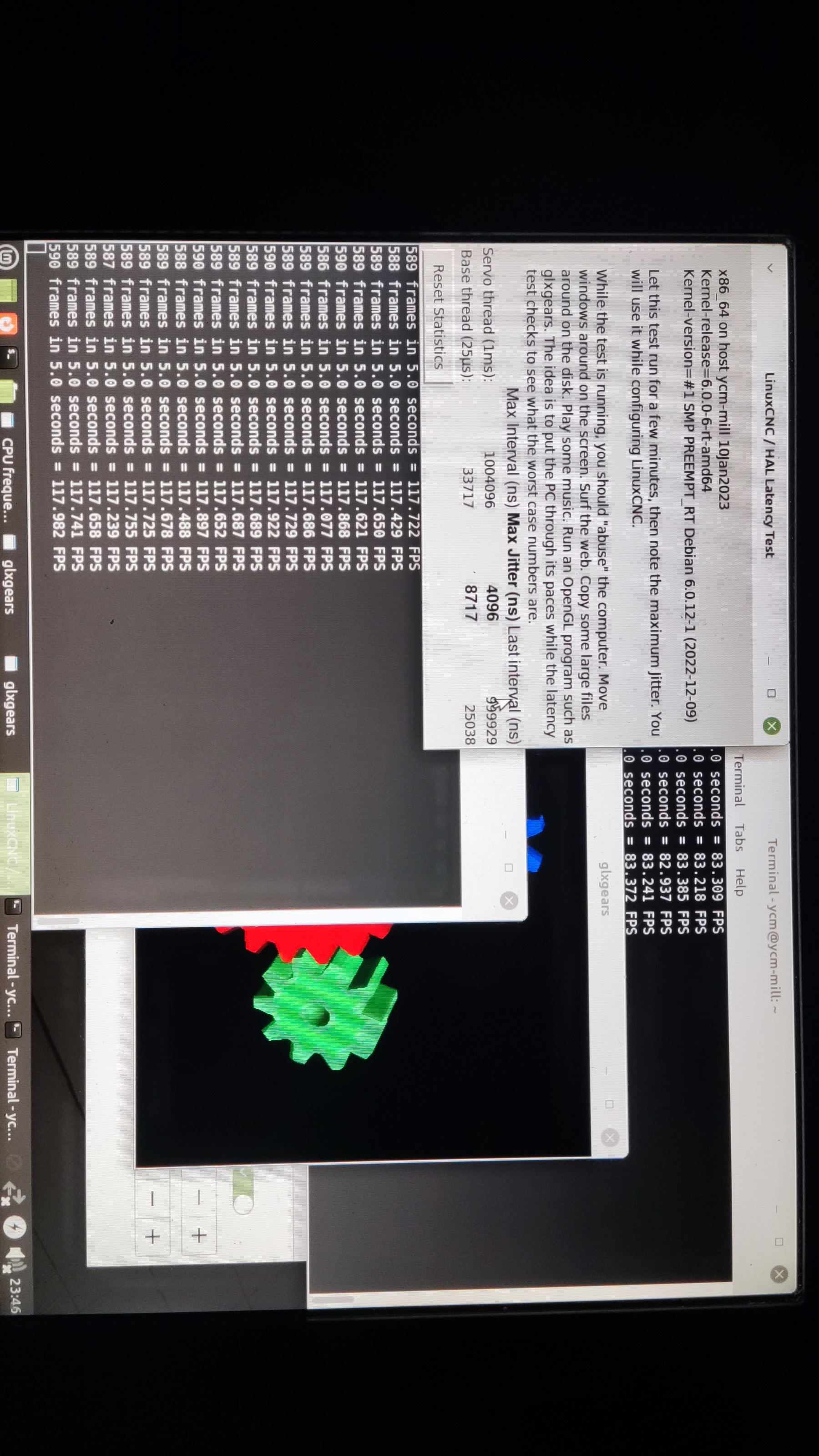

Hello ! Racing to get better latency results on j3355 - could other test latency histogram before and after stopping apparmor service ?
sudo systemctl stop apparmor
sudo systemctl disable apparmor ?
www.phoronix.com/news/AppArmor-Linux-5.5-72-Tests
One more:
exa.net.uk/latency-debugging/
One more:

10 Jan 2023 19:56 #261488
Replied by rodw on topic Installing LinuxCNC 2.9 or Master on Linux Mint 21
I added apparmor=0 to the grub boot line and latency seemed to be a bit worse.
my 6.1 kernel, on an i5 with: isolcpus=2,3 nomodeset apparmor=0
The following user(s) said Thank You: Stanislavz

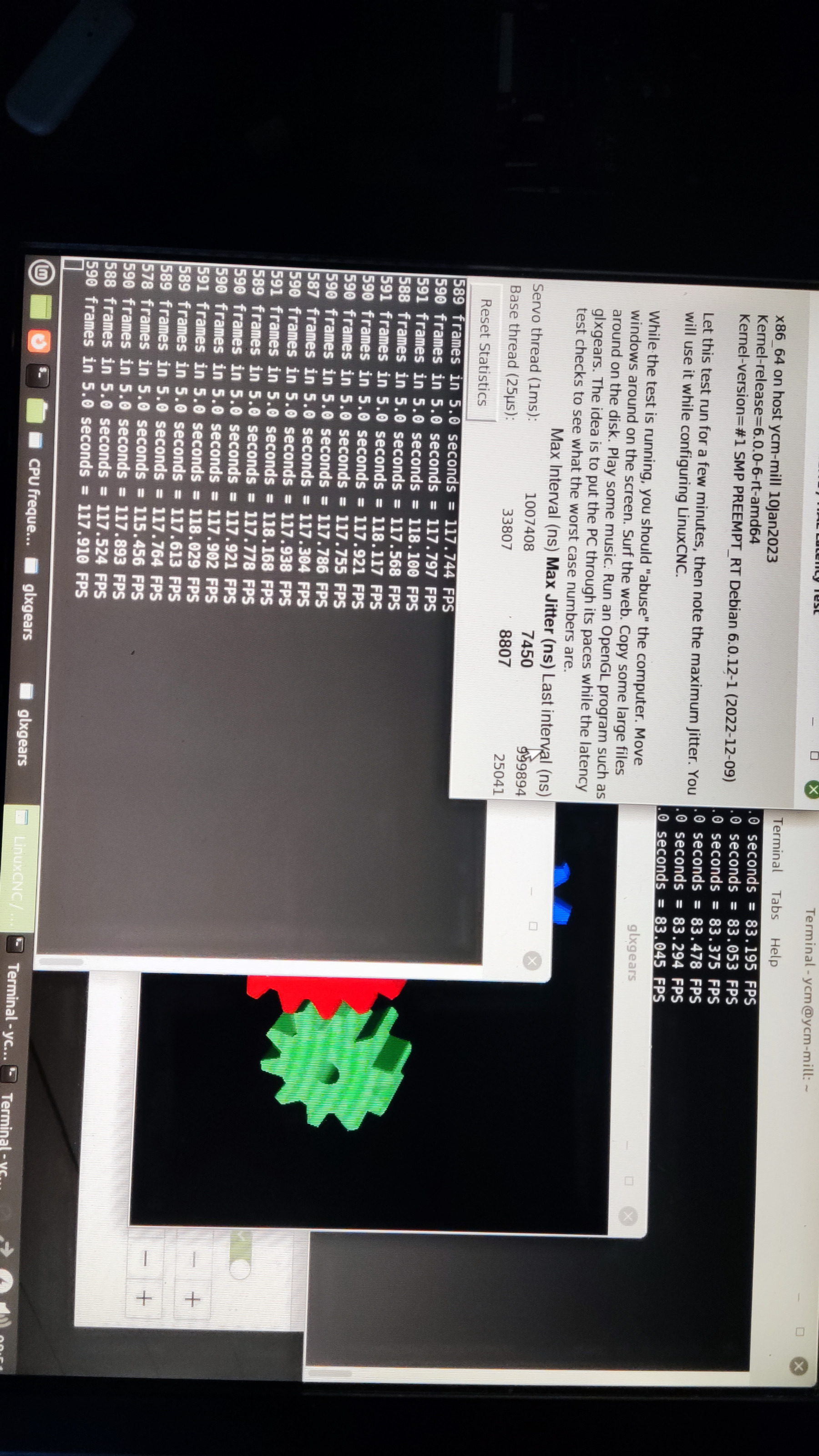

10 Jan 2023 20:06 - 10 Jan 2023 20:10 #261489
by Stanislavz
Replied by Stanislavz on topic Installing LinuxCNC 2.9 or Master on Linux Mint 21
Thank you ! It shows itself on a longer tests, especially with 0-100% cpu usage and changing programs. Left to run for night with some youtube - its ended at 17-20k. Now is 10-12k

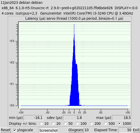

10 Jan 2023 20:45 - 10 Jan 2023 20:47 #261491
I had a bit of a play and might stand corrected with:
quiet isolcpus=2,3 nohz_full=1 apparmor=0
my 6.1 kernel and 4 core i5
A lot of settings you have played with seem to be specific to a 2 core CPU

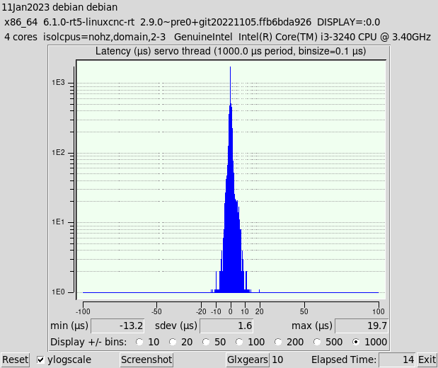

10 Jan 2023 21:52 - 10 Jan 2023 22:05 #261498
by Stanislavz
Could you try isolcpus=nohz,domain,2-3. Nohz is beeing set automatically on newer kernels with isolcpus.
3 hours of running... from youtube till 20 glxgears.
On settings - its more relevant on internal cpu driver.. cpu want to go green way and save power. That i have learned - monitor cpu voltage and C states. The real ones using i7z. Provided by cpufreq are configured, but not used.

11 Jan 2023 06:57 #261541
by Stanislavz
And in the morning.

11 Jan 2023 11:31 #261552
That helped. Still needed apparmor=0
This is Debian Bookworm with my 6.1 kernel.
So I think that will do me for now as its way under what a mesa card requires.
I really would like to poke around with the kernel parameters to see if there are settings that improve network latency (which you should be able to measure roughly with ping times. PCW has ping command syntax that lets it run without a screen refresh until you stop it. Then look at averages...
