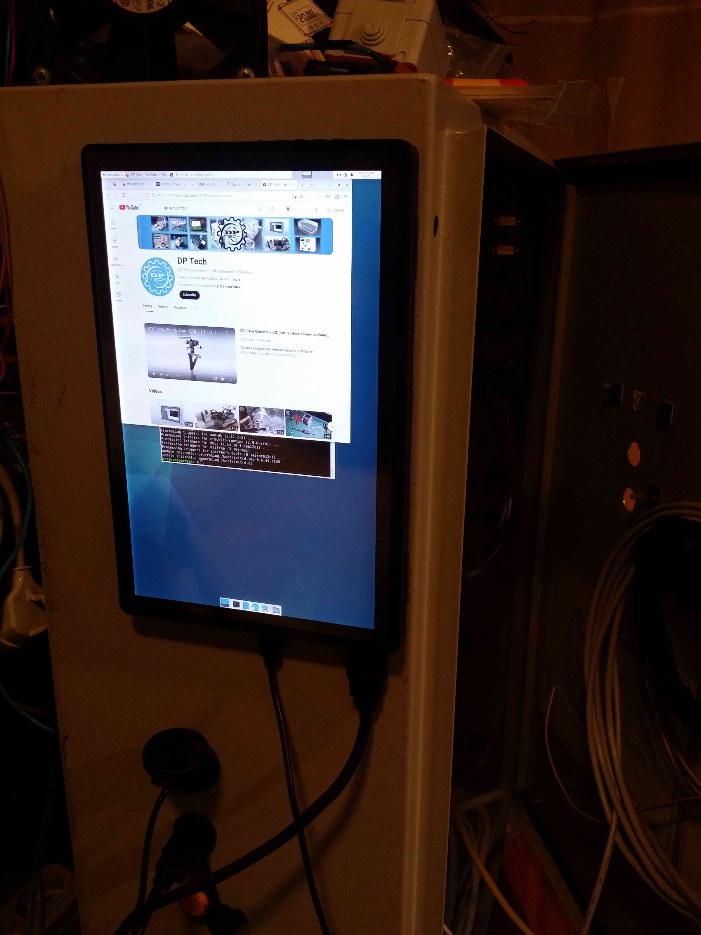

08 Oct 2024 14:00 #311601
by xenon-alien
Replied by xenon-alien on topic Linuxcnc 2.9.2 and 2.93 images for Raspberry Pi 4b & 5
THANK YOU VERRY MUCH!!!!
It looks great!
Finally i can rotate the screen! Also there is sound on the mini HDMI monitor .
Can you tell me how can I rotate the touch part of the screen too?
It looks great!
- Posts: 22029
- Thank you received: 7504
08 Oct 2024 15:59 #311610
gist.github.com/mildmojo/48e9025070a2ba40795c
Replied by tommylight on topic Linuxcnc 2.9.2 and 2.93 images for Raspberry Pi 4b & 5
Try this, otherwise it is a mess to sift through endless posts on several forums to get the right answer, been there and done that, twice.Can you tell me how can I rotate the touch part of the screen too?
