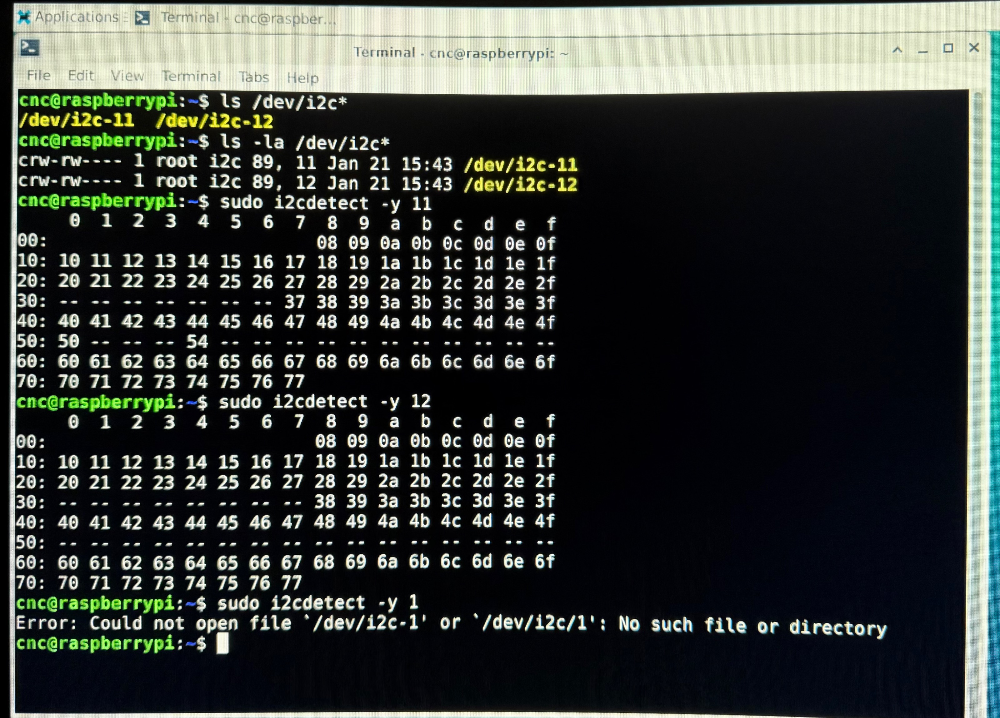

21 Jan 2025 05:55 #319522
by PopBang
Replied by PopBang on topic Linuxcnc 2.9.2 and 2.93 images for Raspberry Pi 4b & 5
I was able to enable i2c, but the instructions say use “sudo i2cdetect -y 1”, 1 doesn’t seem to exist for me, I can only detect 11 and 12 and neither show the 0x36 address.
I have confirmed that the pins are making good contact, so bad connection is ruled out.
Could it be the kernel configuration?

21 Jan 2025 06:35 #319525
Replied by Cant do this anymore bye all on topic Linuxcnc 2.9.2 and 2.93 images for Raspberry Pi 4b & 5
I'm working on a Rpi5 with an image I built myself from rodw's image builder
This is my kernel.

21 Jan 2025 06:41 #319526
Too hard to edit
[ls -la /dev/i2c*[/code]
Would be good to see permissions, not that should affect sudo.

21 Jan 2025 06:47 #319527
by PopBang
It’s only showing 11 & 12, I can’t get 1 to show.
I’m pretty sure I’m using the latest kernel though.

21 Jan 2025 06:53 #319528
Did you run the commands I suggested and post the output ?
What RPi are you using ?
What Linuxcnc img are you using ?

21 Jan 2025 10:17 #319535
by PopBang
I’m using a raspberry pi 5 8gb with the latest 2.93 image that’s linked on the first page of this thread. I’ve attached a screen shot of what I’m getting when run the commands.

21 Jan 2025 10:31 #319536
Ok it was a typo I made, but if you tried to edit the file it should not of existed.
as superuser edit /boot/broadcom/config.txt & change the line from
#dtparam=i2c_arm=on
to
dtparam=i2c_arm=on
Then reboot.
#dtparam=i2c_arm=on
to
dtparam=i2c_arm=on
Then reboot.
