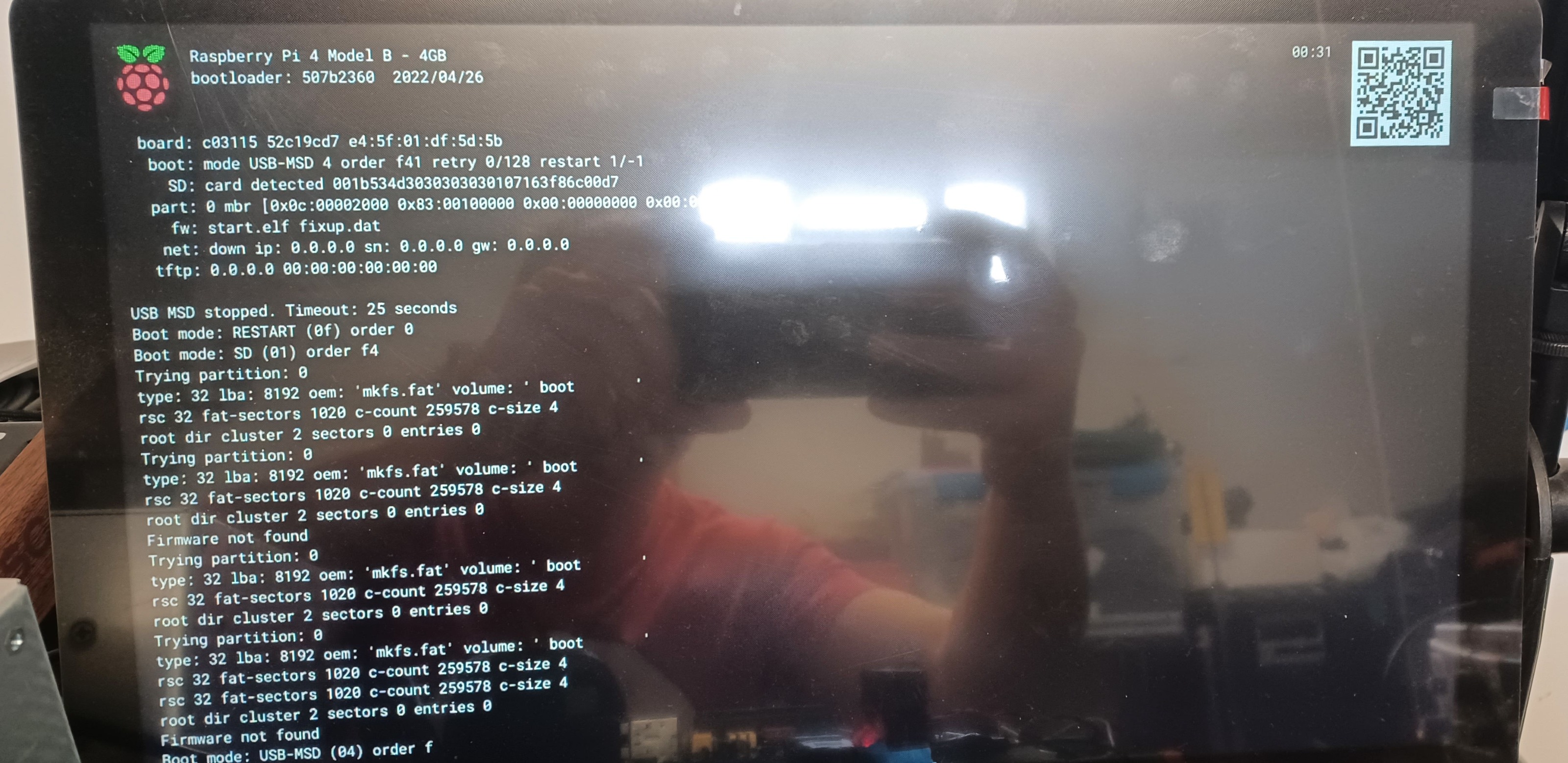

Well I tried our image first, and got this:

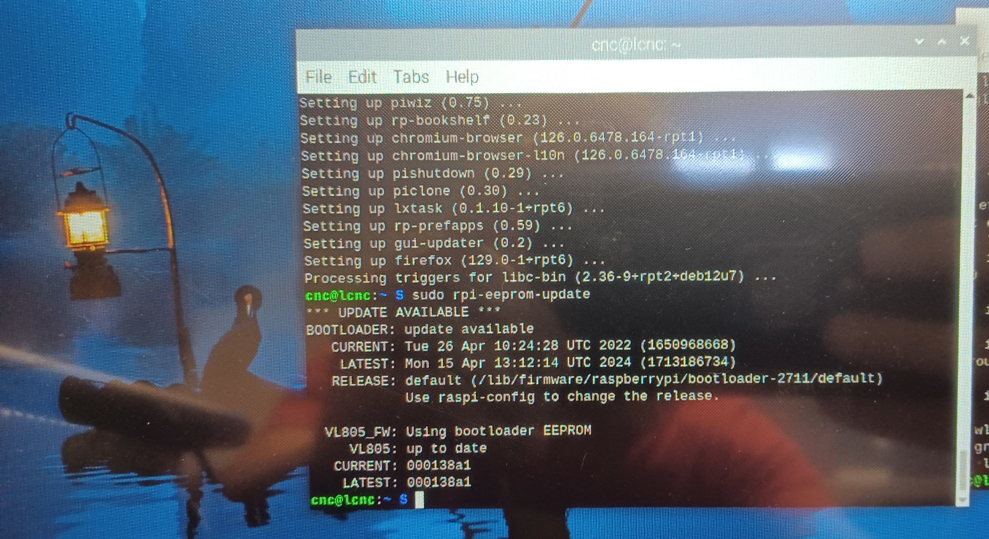

That was written with rpi-imager without error. Note the bootloader date (2022). So then, long-pressed shift and installed the latest RaspiOS. In that, did a sudo rpi-eeprom-update to see what firmware versions were in use:

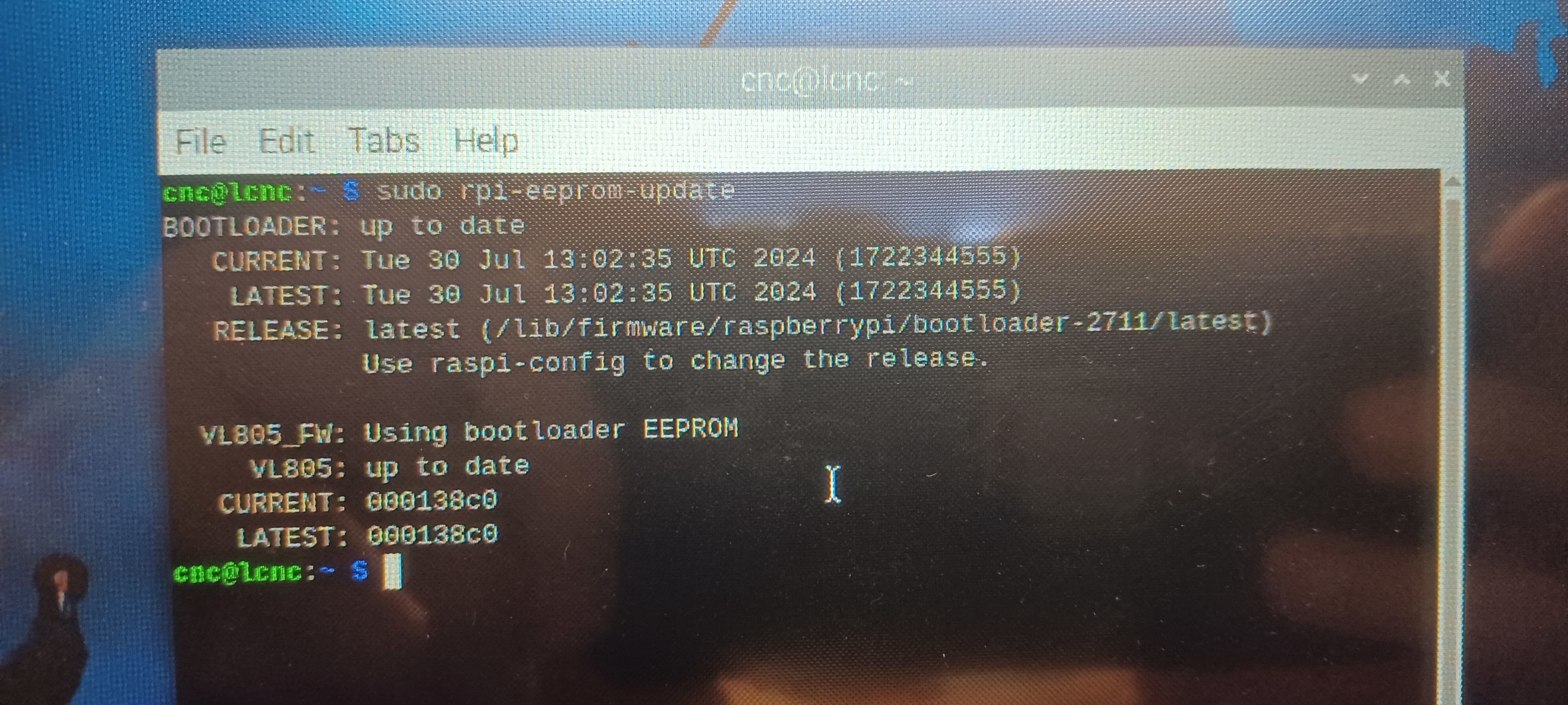

So looks like there are still firmware updates. So then issued a sudo rpi-update, which after that completed, was verified:
So then the SD card was re-burned with our image, and that now boots, woohoo! Thought I'd share if anyone else experienced this.

I have had issues with older 4b's until I updated the firmware but that was done using a setting in rpi-imager
