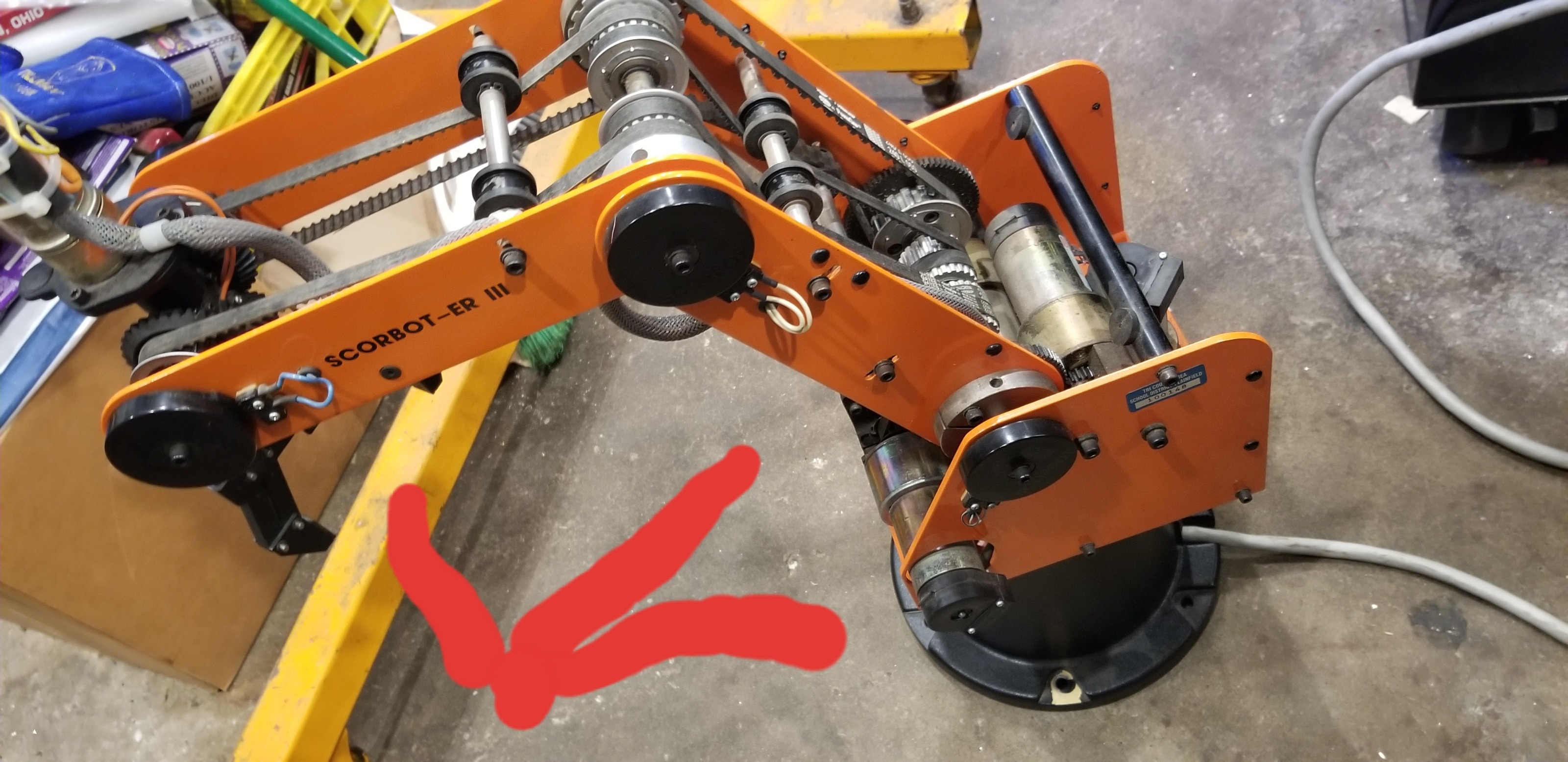

Yes it has homing switches please see attached photo.
I will try what you suggested and let you know.

Thank you everyone I now have it working, and am in the process of adding a Logitech dual action F310 controller as a pendant.
The Scorbot-ER_3 limit switches needed readjusting using MOTOR TEST, on the Eshed Robotic control box with the Arm repositioned close to home.

Had to readjust the limit switches on the bot again for homing.

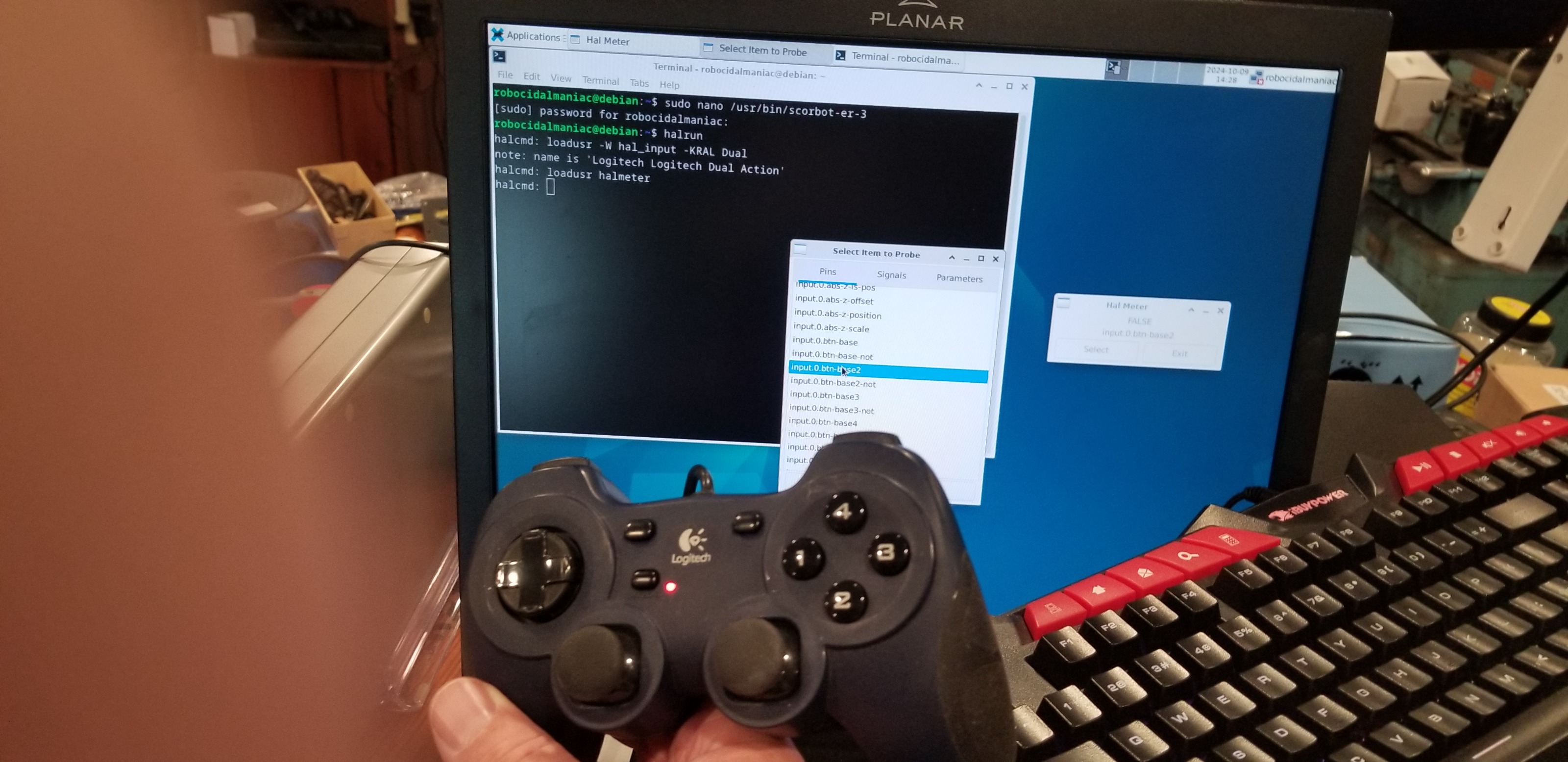

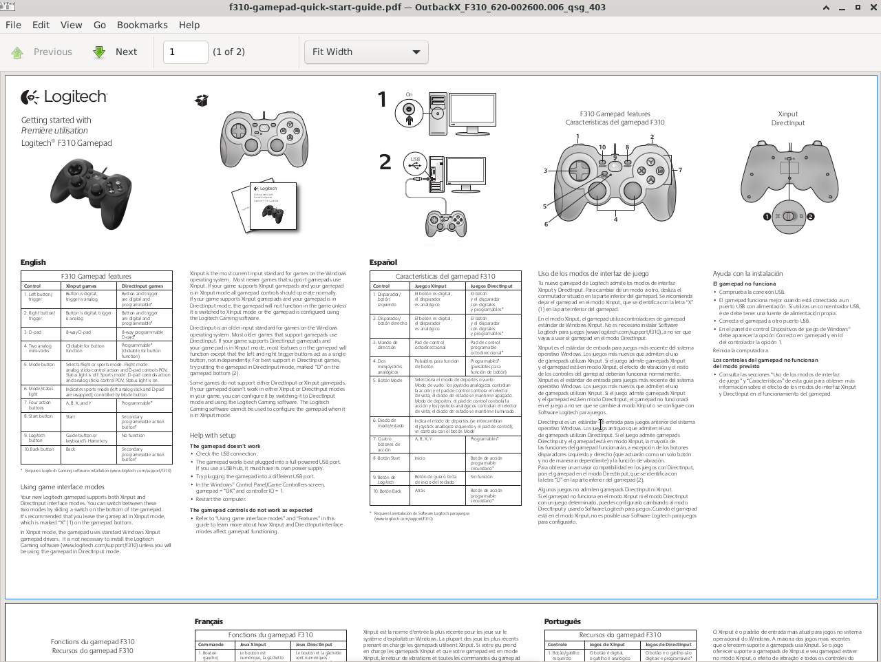

Please has anyone been able to use a Logitech Dual Action F310 controller as a pendant for a Robotic Arm? I am running LinuxCNC 2.9.2 and are able to get the Mill working with the F310 as a pendant, but not my Scorbot-ER-3 robotic arm. Please help
- robocidalmaniac
- Posts: 22
- Thank you received: 4
15 Nov 2024 13:52 - 15 Nov 2024 13:52 #314555
by robocidalmaniac
Replied by robocidalmaniac on topic scorbot-er-3
If anyone is interested I now have a Logitech Dual action F310 controller working as a pendant in LinuxCNC for the Scorbot ER 3 Robotic Arm. I can post if anyone is interested.
Last edit: 15 Nov 2024 13:52 by robocidalmaniac.

To get the Logitech Dual Action F310 controller to work as a Pendant for the Scorbot-ER-3 using LinuxCNC 2.9.2, after making previous changes mentioned earlier in this forum, do the following:
Open the "scorbot-er-3.hal" file in the /linuxcnc/configs/by_machine.scorbot-er-3/ folder and add these 2 lines (after the "loadrt differential" line);
loadusr -W hal_input -KRAL Logitech
loadrt mux16 names=jogspeed
then add (after the "addf differential.0 servo-thread" line):
addf jogspeed servo-thread
save and close the file.

Special note: The Pendant will not work until you home the Scorbot-ER-3. After Homing the coordinates will change to cartesian coordinates (X,Y,Z,A,
. After you make these changes the pendant will work as follows:
The left joy stick controls X, and Y axis.
The right joy stick controls the Z axis.
The D-Pad controls the rotation and turning of the gripper A, and B axis.
The bottom finger triggers control the rate of movement;
nothing 150
left only 300
right only 600
both 1200
Last is the buttons:
Button 9 is estop, if pressed you have to use the keyboard to reset
Button 2 is run G-Code
Button 4 is pause program, press Button 1 to Resume
Button 3 Stop program if if press Button 2 it goes back to beginning and starts
over again
Button 10 you must first press Button 4 this will run the code one line at a time
Button 1 Resume (after Button 4, or Button 10)
I have not yet figured out how to open and close the gripper through the G-Code file or the Logitech F310 Pendant. Only the GUI interface (+ -) works for the gripper.
I hope someone smarter then me can help to figure this out, and add a replay.
Thank You all

right only 600
both 1200
over again
Thank You all

If it helps here is the User Manual for the Logitech Dual Action F310 Controller
