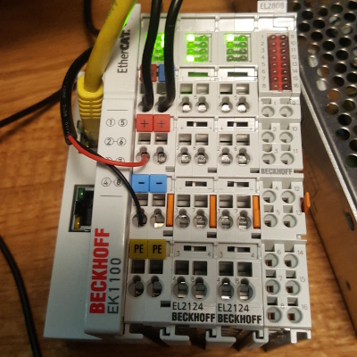

For Linuxcnc Ethercat users. I have made a install guide for 64 bit users, so you can use Draftsight 64 bit on same pc.

$ cd linuxcnc-ethercat/ => make

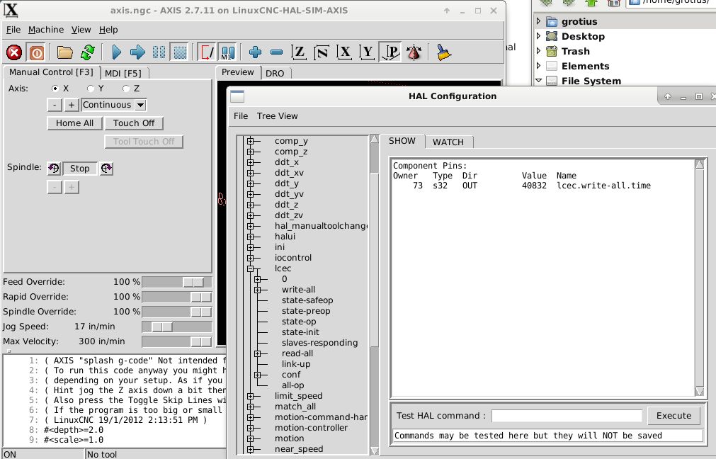

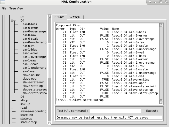

4. To start linuxcnc with ethercat, start linuxcnc with simple axis gui.
copy lcec_conf ==> ../linuxcnc-ethercat/src/lcec_conf ==> to your linuxcnc sim map (copy it where your ini files is)
copy lcec_so ==> ../linuxcnc-ethercat/src/lcec.so ==> to your home/.../linuxcnc/rtlib/ (this is only for linuxcnc_dev users)
copy and edit the ethercat_config.xml from the linuxcnc-ethercat example directory and copy it where your ini file is.
In your ini file add "HALFILE = postgui.hal"
make a postgui.hal file include :
loadusr -W lcec_conf ethercat-conf.xml
#loadrt lcec
#addf lcec.read-all servo-thread
#addf lcec.write-all servo-thread
First check if lcec_conf will load, open your halmeter.
When you see the Lcec section, uncheck the # sign's in the postgui.hal file.
Good luck. Many many thanks to Sascha. He is founder of Linuxcnc Ethercat. Great to see what he has done in the mean time !!!

How to create a new Ethercat driver.
Driver : EL3062
1. Correct your own slave position and name in the xml file : <slave idx="3" type="EL3062" name="D4"/>
Keep the xml file simple. In etherlabmaster/tool/ you can do $ ./ethercat xml -p3
This is create a xml file from slave number 3. This output you can not use. It's as simple as the above single line.
2. Copy a EL c and h file that comes close to your new driver, in my case the EL3255, a 5 channel analog input device.
3. Modify the EL3255.c and EL3255.h to your EL3062.c and EL3062.h needs.
It's almost as simple as the find and replace function for whole document with text editor geany.
4. Modify the lcec.main.c file ==> add your EL3062 to the list.
5. Modify the lcec.config.c & lcec.config.h file ==> add your EL3062 to the list.
6. Add your EL3255 to the Kbuild file ==> This file brings all the drivers to one single lcec.so component.
7. Do a "make clean" in your top directory and do a "make" You must start clean. You see what "make clean" does in the output.
8. Copy your new lcec.so from your src directory to your rtlib.
9. Copy your new config file to your bin directory.
10. Start linuxcnc.
11. Keep in mind. The makefile output is in the same directory as you did make. So lcec.so and config is in this direcory.
Copy them to your rip-environment or to the normal linuxcnc environment, for example usr/bin/ for config file
12. Don't give up after first attempt.
Okey after 3 attemp's it succeeded for me. The bottelneck for me was in the lcec.main file.
