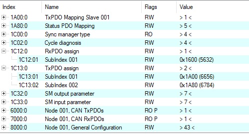

If I had them, it would be helpful, of course, although I think we are quite far away, I attach a new file to see if you have any progress, since the TWINCAT3 project that you passed me is not available, can you see if this data is correct?
<sdoConfig idx="1c12" subIdx="complete">
	<sdoDataRaw data="01 00 00 16"/>
	</sdoConfig>
	<sdoConfig idx="1c13" subIdx="complete">
	<sdoDataRaw data="02 00 00 1A 80 1A"/>
	</sdoConfig>

04 Mar 2020 17:47 - 04 Mar 2020 18:32 #159206 by JimPanski
Hi Chimeno,
first of all I was asking if you have those devices because I got a second set op it here wich I could maybe share if you are interested.
I tried you configs with no luck :/

26 Apr 2020 08:09 - 26 Apr 2020 08:13 #165630 by purged
In the meantime i think I got a better overview in Twincat, so that I could finally find the COE Startup SDOs which were used in the config xml file.
Hi Guys, I am stuck in a similar situation, may I chime in?
I am trying to have LinuxCNC talk to ESTUN ProNet Plus series servo drives via linuxcnc-ethercat->Beckhoff EK1100->Beckhoff EL6751.
There is a CANopen manual from the manufacturer so I have high hopes of getting that to work: www.estuneurope.eu/wp-content/uploads/20...anual_compressed.pdf
I have set up TwinCAT on a separate windows machine and I can scan and find all Beckhoff devices automatically. It finds 'special device' EL6751 and asks for baud rate which I set to 500k, the same which I have configured my servo drives to. TwinCAT then 'scans Fieldbus' which takes 30 - 40 seconds or so, but it doesn't discover my servo drives. Is that normal or is my cabling faulty? I've seen in a Nanotec application note that their CANopen devices can be discovered automatically ( en.nanotec.com/fileadmin/files/Applicati.../TwinCAT/TwinCAT.pdf )
On the other hand I have all the PDO data and everything in the CANopen manual so I could set up the devices all manually. How do I generate the ethercat-conf.xml (i.e. github.com/sittner/linuxcnc-ethercat/blo...ex/ethercat-conf.xml ) in TwinCAT then?
Thank you very much :)

07 May 2020 11:01 #166955 by Patis
@purged I've the same problems with Twincat3 and scanning Canopen drives. My Nanotec Drives (SMCI_36 or PD6N) cannot scanned by Twincat3. But if I add the Nodes manually, the communication between both works. I talked yesterday with Beckhoff support and they said this is normal, because the Canopen Protocol can be different. You must do it manually.
I configure in my Drivesmapping-/configurationTool an easy Status- and Controlword mapping. Then I add a new node with the NodeID and add the same PDOS in Twincat3. If your setup is online... click on the refresh button in Twincat3 and check if your EL6751 is green(StateOP) and your Statusword must have any online Value.
If the Err LED is blink' red 1Hz... the NodeID is wrong or start with your Hardware or: You need a realtime capable Networkcard from Beckhoff or the network chip must be one of the supported chips from this Beckhoff site:
Beckhoff Link
I've this one:
Amazon Link
Another communication problem was:
Your EL6751 has an Hardware Version and a Firmware Version. Try to update this to the newest supported FirmwareVersion over Beckhoff Support. I find out... a lot of drives don't communicate under El6751 0000 0017 FW Version.
Creating the EtherCatXML for Linux is a nightmare, because I don't know how I can debug this. If SOMEONE has Tips for me give mee feedback. I'll create a new Post for my Problems with this XML Config file!!!
