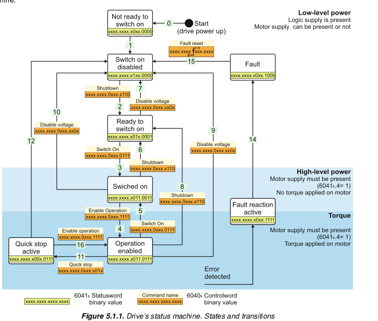

08 Jan 2022 22:55 #231189
by 3radfahrer
do you try to home with an internal homing-procedure of your drive? or does linuxcnc handle the homing-procedure?
please find attached the files of my config. please keep in mind, that for this configuration I home on a signal, that comes via ecat from my amp. the signal is generated by a magnetic switch, that is attached to the amp.
attached is also a diagram of the statemachine I have to pass through. The transitions are in the comments in the configs. The image is from the technosoft CoE manual
Replied by 3radfahrer on topic Ethercat - newbie guidelines
Thanks for this info.
Then it seems to be quite similar to the implementation of my amps in combination with the generic driver
Can you share your config? I did quite a bit of rework on the cia402.comp component and can now get my drives to home and rehome consistently but if left to travel too far, I get following errors. I am not sure why because we are setting the pos-fb = pos-cmd in the component while homing so there should not be anything to complain about.

08 Jan 2022 23:17 #231195
Replied by rodw on topic Ethercat - newbie guidelines
Thanks for that much appreciated.
I am trying to uses Dominic's cia402.comp and home using linuxcnc's index homing.
I have revised the component to make it work for my drive and shared my version on his cia402 component thread.
I was thinking afterwards, that I may not have correctly scaled the linuxcnc homing velocities to agree with the drive settings So I will try changing some ini file settings.
