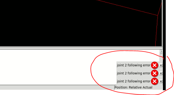

what is the actual revision of the hal file?
If the joint pins are all still commented out, this errors are all normal

22 Feb 2022 15:21 #235534
by db1981
Replied by db1981 on topic (Freelancer) Linux CNC + EtherCat + RPi 4 Setup
files looking ok.
is this error only on joint2 , do the other axis move?
One Idea, mode_of_ op is missing. This pin is not provided by your drives config.
Please check the value of the pin opmode_display in halshow.

Replied by Dj Junior on topic (Freelancer) Linux CNC + EtherCat + RPi 4 Setup
Yes! is only joint2
27 s32 OUT 8 lcec.0.4.opmode-display ==> x-opmode-display
27 s32 OUT 8 lcec.0.5.opmode-display ==> x-opmode-display
27 s32 OUT 0 lcec.0.6.opmode-display ==> z-opmode-display

by db1981
as you can see, the drive for z (joint 2) is not working correct. The Value should be 8= CSP Mode too.
Change the CAT cabling to get this drive to another position in the chain and look if the op-mode display moves with the drive or not.
If it moves, the bug is related to the drive himself, if not the config is buggy.
