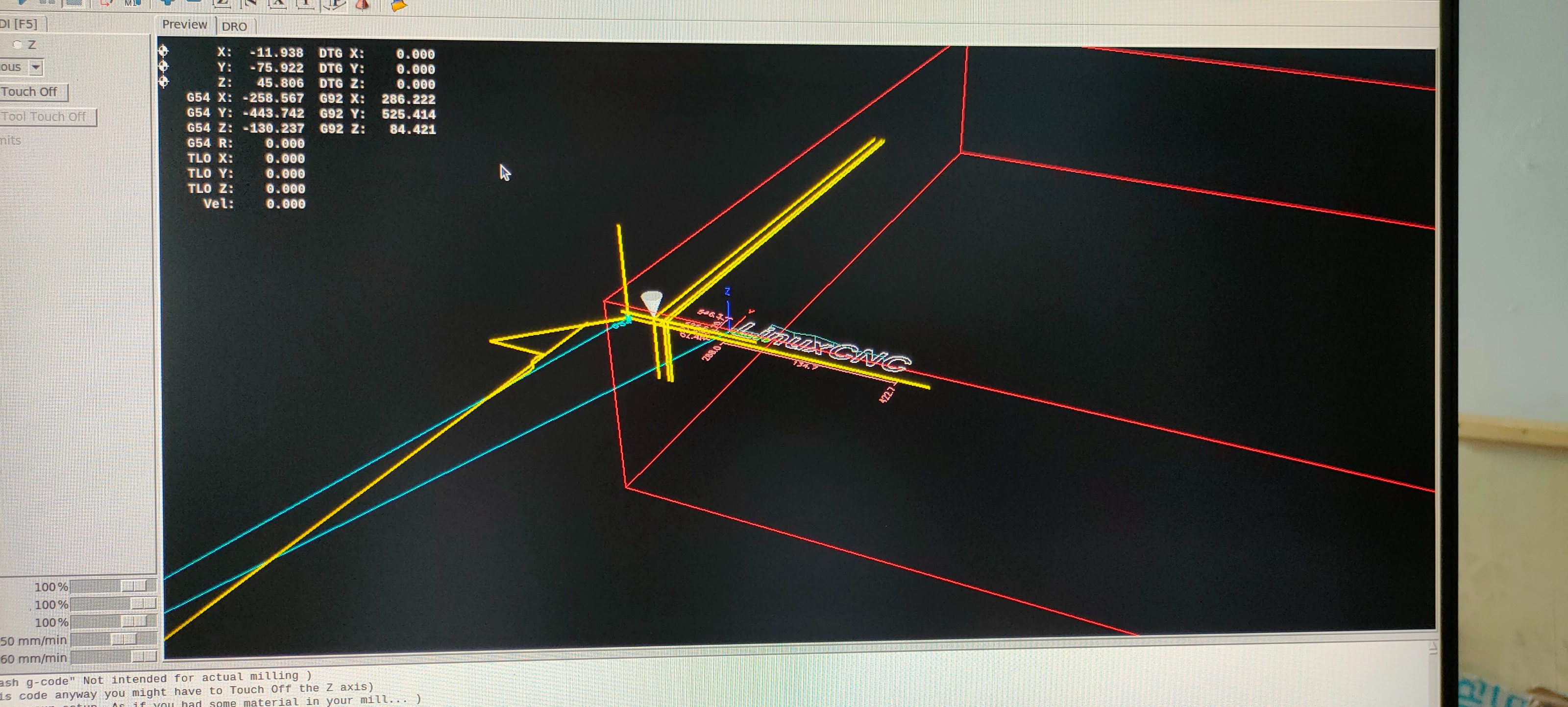

So, for the last few days I've been playing around with axis parameters Accel, Velocity etc and some basic programs with the router and laser etc, and I've noticed a problem with the axis tripping with following error, mostly axis 0, but has been 1 and 2 as well.

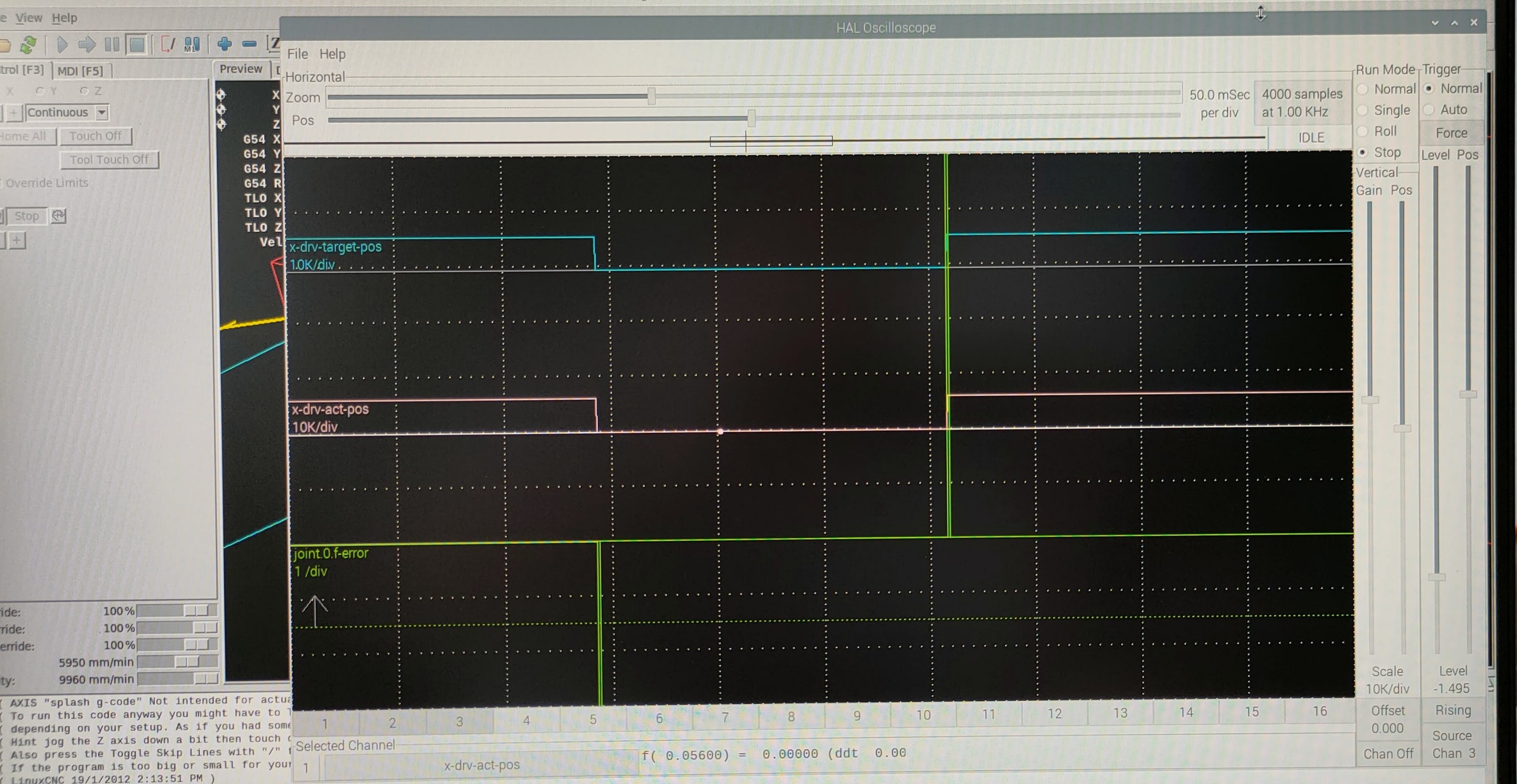

I had a look with the hal scope and started to monitor the x-drv-target-pos, x-drv--act-pos and joint.0.f.error. everything looks good with slow move errors of around 0.1mm and rapid move errors of 2mm tops. then during a move it happened, and I noticed an immediate swing of both target and actual to 0 (not physically though) and of course a huge following error - tripping the axis. unfortunately I was not quick enough to save the image and it was on auto trigger.
After changing the scope trigger to one shot I set out to capture a fault to better investigate. after many back and forth moves on the 0 axis I had no luck and had to stopped for a short time. When I came back I noticed that it had a following error and I had captured the result - this time there was no movement at all. and on the linuxcnc screen it showed max moves on the all axis which again I had not performed.
From the scope it appears that the Ethercat dropped out for 150mS - has anyone experienced this before??

24 Jan 2023 04:34 #262794
by SteveP_CNC
Replied by SteveP_CNC on topic RPi 4 image with Ethercat drop-out? Problem with new PC build Debian Bookworm.
Hi all,
Just a quick note to say that the problem I was experiencing was due to lack of screened ethernet cables between the PC, stepper drivers and I/O card.
Trick for young players. Hope this helps out someone in the future.
Steve
Steve
