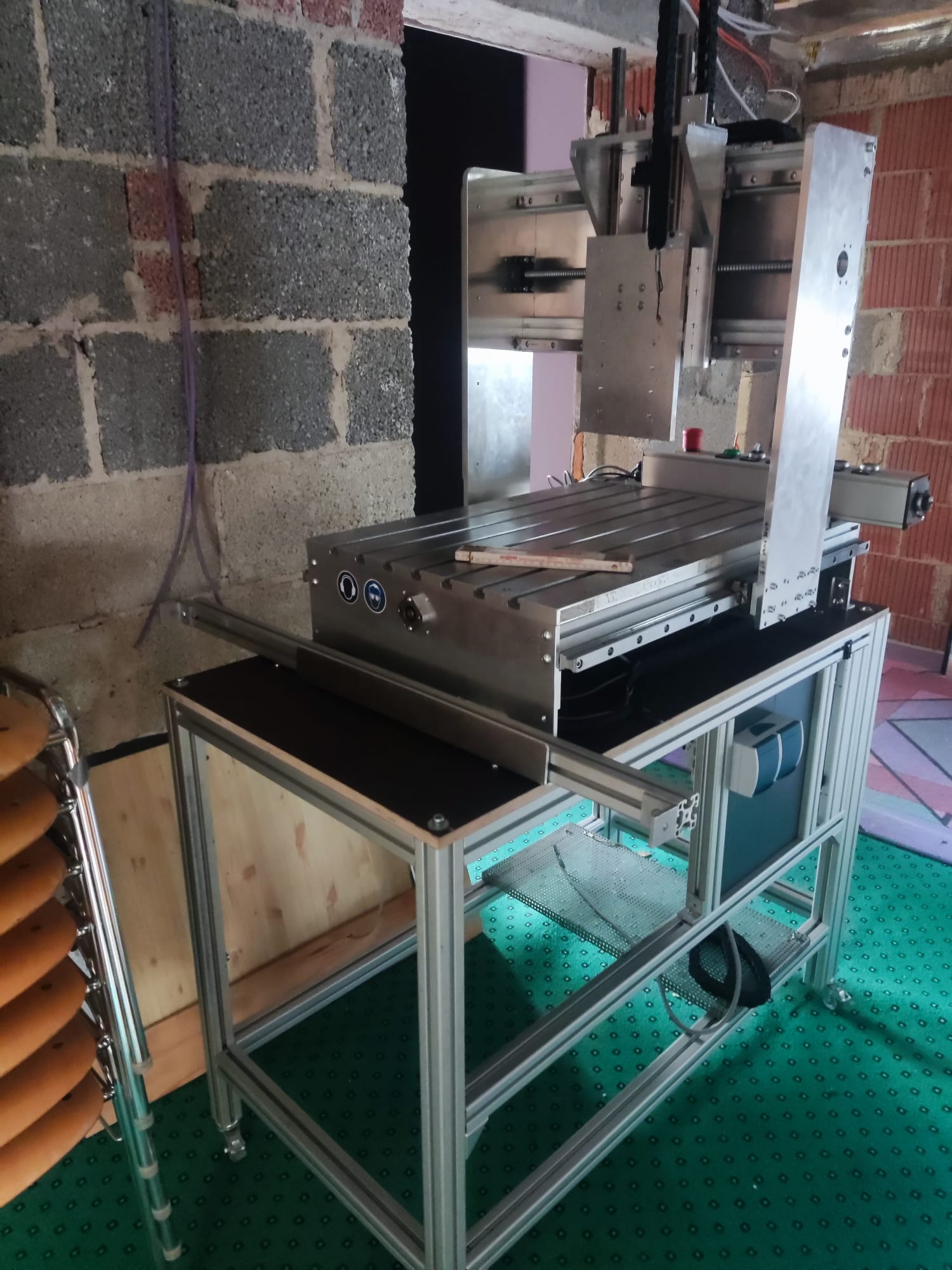

So for overwiev what I want to do is to build a CNC Portal Mill with complete Ethercat System; Ethercat because I like the technology and I think it could help me in the future if i have gained a little bit of experience in that field because I am an engineering student.
Therefore I only have a first overview what I want to use:
-the servo motors i mentioned, because they are the cheapest i could find with ethercat and one of my main questions regarding to that, is if a implementation of such a servo is even possible
-a used beckhoff ek1100 --> and other moduls(which I need to choose before that) in connection with parts like the endstops, the VFD for the Spindle (a ATC one) and some other accessories, in the future, maybe even some glass scales but lets see
And for the rest overview what i have in the moment is the frame for the CNC (picture in the attachement)
Cheers, Smitherman

What i forgot, its a self build one from another person with very good 16mm ballscrews and Rexroth System

The frame looks very good, but my gut tells me that the servo is a bit too small. and my belly is bigger than my mind. so i believe him. the ek1100 is okay as a master. there is also configuration here in the forum. But installing the servo motors could be an adventure without manuals from the manufacturer. and I don't see any interface to connect a scale. I know with delta servo a2 or a3 version you can connect the scales directly to the amplifier. But jmc isn't documented at all really difficult.

Thats why i asked, a little adventure is okay for me as long as i get it to work somehow, i already worked with Servos, but not in Ethercat.
For your info in the before live of that machine there were Nema23 Steppers mounted which worked great and i assume that a 180W servo should fit then.
The scale was only a dream config so if its not working, it is okay.
But the Servos give me a little of a headache

180w servos will be plenty powerful for that machine
