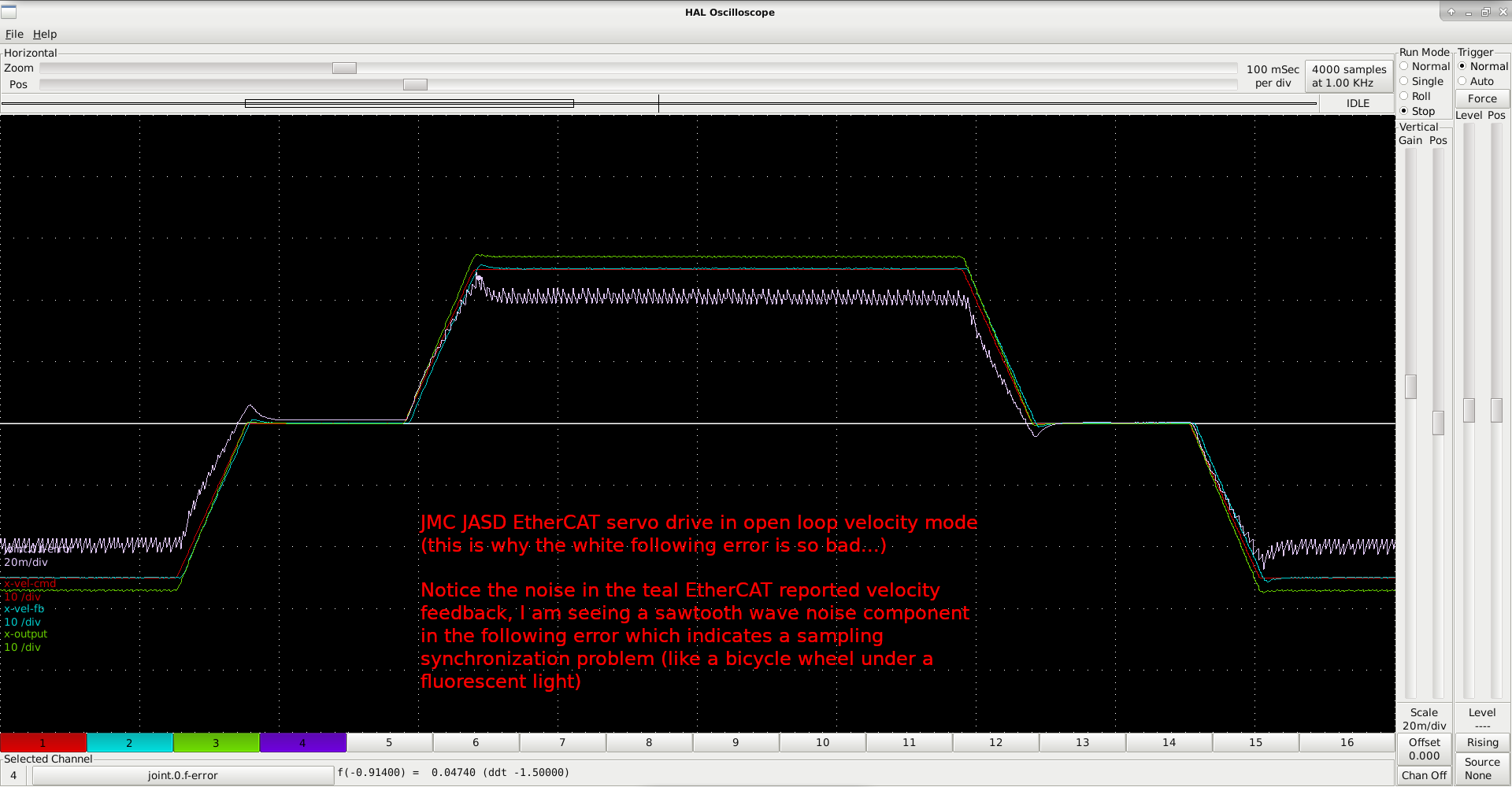

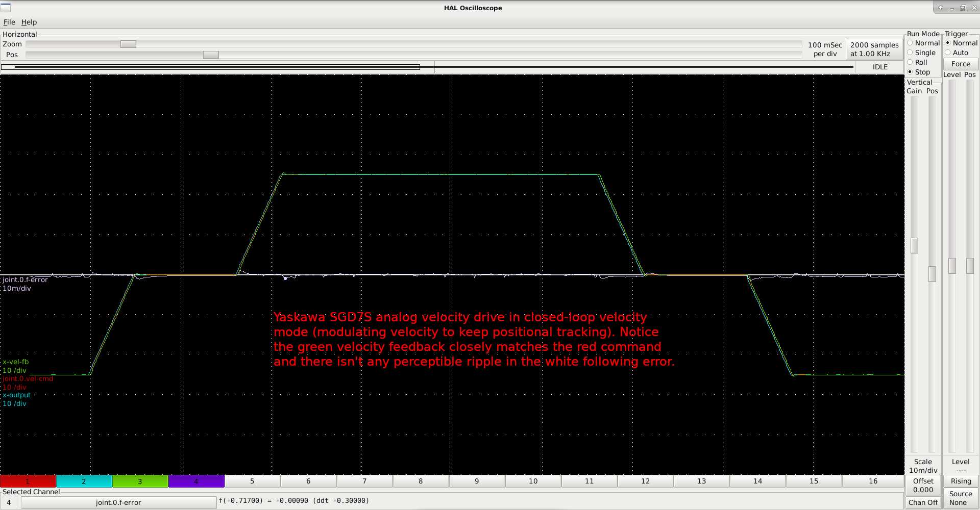

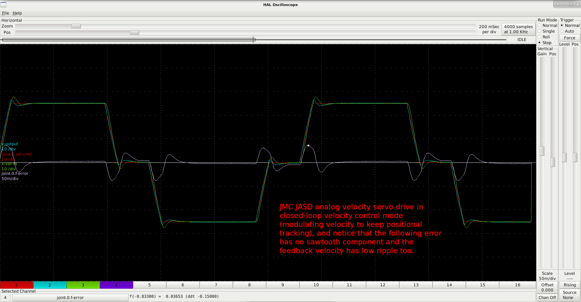

27 Aug 2023 23:21 #279120 by fdarling
If this helps anyone, I have successfully used a JMC JASD7502-20B-EC EtherCAT servo drive with LinuxCNC, if you use the generic driver the standard CiA402 registers will just work. However, I was not seeing the greatest performance with the self-reported velocity feedback, and similarly I was getting following error ripple that looked to me like a synchronization problem. Because of this I didn't bother tuning the system, I was just doing preliminary testing to make sure it was protocol compatible.
I am still trying to get a Yaskawa EtherCAT servo drive to work so that I have a Japanese quality reference to compare against. However their drives do not support combined read/write datagrams, the reads must be separated from the writes. This means the LinuxCNC driver needs to be tweaked a little bit unfortunately, and I am currently working on that...

29 Aug 2023 15:22 #279295 by udoS
Can you elaborate on that;
udoS

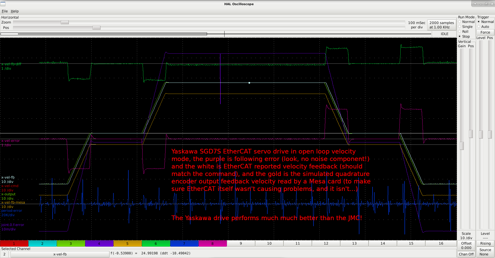

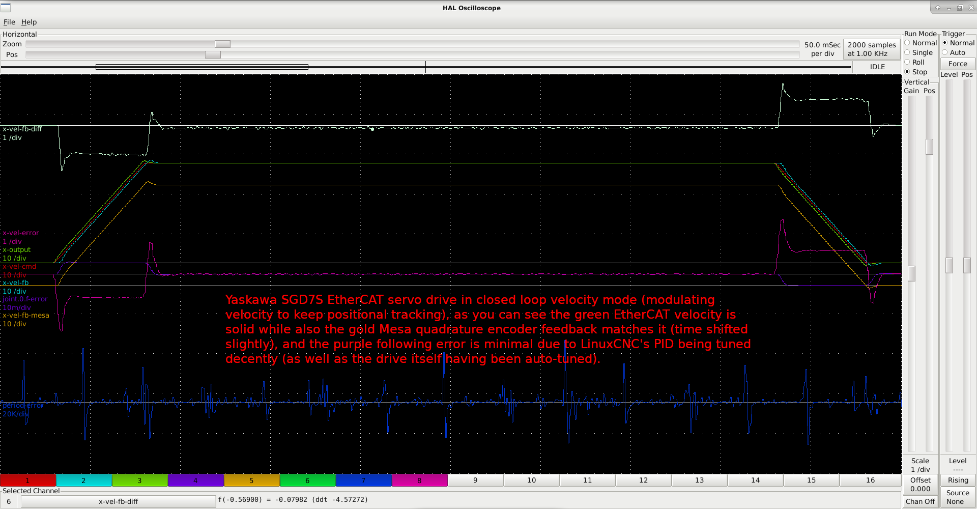

29 Aug 2023 23:50 #279330 by fdarling
 I was not seeing the greatest performance with the [color=
Attached are screenshots of "halscope" in LinuxCNC showing the performance of a JMC vs Yaskawa EtherCAT drive in open loop velocity mode, and also of a JMC drive in closed-loop analog velocity mode and the Yaskawa EtherCAT in closed loop as well, and finally a Yaskawa analog drive in closed-loop for completeness. I did not have any screenshots of the analog drives in open loop, and I don't feel like hooking them up again right now
You can see that the JMC analog drive is a lot smoother than the EtherCAT one. I believe the EtherCAT edition drive isn't properly synchronizing the reading of the serial encoder to get consistently spaced positional readings, and the velocity is calculated off a simple position-delta per EtherCAT cycle rather than reporting the internal calculated velocity, which would be done at a higher sample rate with some better filtering. I speculate this because I've coded this stuff before, and run into the pitfalls...
The Yaskawa drive is on a whole different level of quality as you can see from the screenshots... The EtherCAT and analog drives perform similarly, and they both perform extremely well. The EtherCAT reported velocity feedback is rock solid.

JMC JASD EtherCAT servo drive in open loop velocity mode
(this is why the white following error is so bad...)
Notice the noise in the teal EtherCAT reported velocity feedback, I am seeing a sawtooth wave noise component in the following error which indicates a sampling synchronization problem (like a bicycle wheel under a fluorescent light)
JMC JASD analog velocity servo drive in closed-loop velocity control mode (modulating velocity to keep positional tracking), and notice that the following error has no sawtooth component and the feedback velocity has low ripple too.
Yaskawa SGD7S EtherCAT servo drive in open loop velocity mode, the purple is following error (look, no noise component!) and the white is EtherCAT reported velocity feedback (should match the command), and the gold is the simulated quadrature encoder output feedback velocity read by a Mesa card (to make sure EtherCAT itself wasn't causing problems, and it isn't...)
The Yaskawa drive performs much much better than the JMC!
Yaskawa SGD7S EtherCAT servo drive in closed loop velocity mode (modulating velocity to keep positional tracking), as you can see the green EtherCAT velocity is solid while also the gold Mesa quadrature encoder feedback matches it (time shifted slightly), and the purple following error is minimal due to LinuxCNC's PID being tuned decently (as well as the drive itself having been auto-tuned).
Yaskawa SGD7S analog velocity drive in closed-loop velocity mode (modulating velocity to keep positional tracking). Notice the green velocity feedback closely matches the red command and there isn't any perceptible ripple in the white following error.
