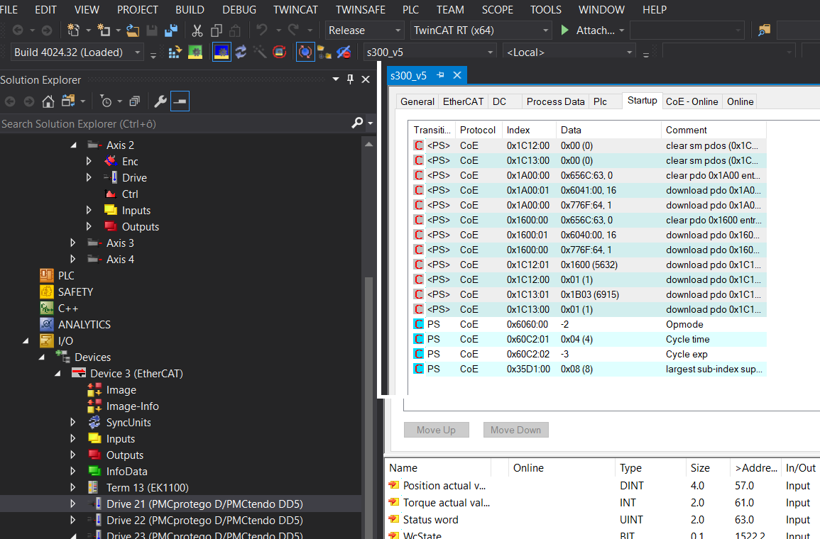

I can recommend you from beginning configure stuff over twincat3, check how it works and what is in the mapping PDOs and what is in the SDO at start up ... I attached below festo manual for cmmt which is very helpfull for starting on a green meadow...1 and 2 chapter is for IPC in the ethercat network thats are not usefull for you... your learing stuff starting from 3 chapter in the .pdf
learn what is what, what is in which format, what is in which data format, what have to be setted up at startup etc...
download .esi file from vendor site and put it to the " C:\TwinCAT\3.1\Config\Io\EtherCAT " in win machine with installed twincat3...
there is active scan button and twincat will find your slave and it will get it to online... you have to active DC for synchro and deactivate lag monitoring function in encoder of slave ...after it you will control your slave and see what and how everything change in the online PDO...
There you can customize the PDOs in a few clicks and hook up online in the fastest and easiest way without all errors around lcec and no eeprom overwrite in the slaves ...
check attachement, learn how to over twincat3, create custom generic .xml for your slave ... if it is cia 402 format of control used db1981
learn it no copy´n´paste it

they should if it was not configured or from default was different from your setup...
You can prepared drive in many ways... I do not know what you like but I am prefering premapping it over .xml file and all stuff has in nice single pile... but you can create same bash script with premapping ethercat commands and run it just before you startup the lcnc like you have above...
premapping over .xml file below - you have to tell slave how and with what you will communicate together -
without premapping
syntax you will have to understand yourself
regards S.

PS
but twincat3 is really helpfull for one simple reason - startup section which showing us what is neccessary put to the mapping SDOs, in which format and in which position... see printscreen below in attachement ...
If you did know full syntax (what probably nobody from us), you can spent tons of time of configuring servo driver without any feedback..(as me, please do not repeat my mistakes) ... because drivers which I had in my workshop have not proper manual and nowhere nothing wasnt ... check my other posts too ....
regards
regards

Whew!
I read thru a hundred links, changed my code a hundred times, and eventually got it working.
I wish I could say there was a particular 'aha moment' when I knew I'd fixed it, but I tried so many variations that I'm a little fuzzy on which fix, exactly, worked.
Understanding the drive's 'startup' tab in Twincat certainly helps.
