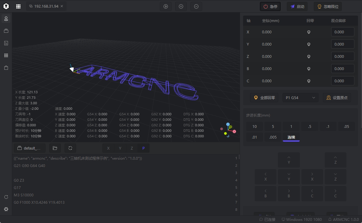

I'll provide a detailed explanation of some of the things I'm currently working on and the issues I've encountered:
1、Python is not used for real-time processing tasks. Its role is solely to read and invoke relevant APIs from the LinuxCNC Python module, as I have rewritten the GUI using HTML.
2、I use the ECR60 to drive stepper motors, and I haven't connected the NPN limit switches to the ECR60's IO; instead, I've connected them to the GPIO pins on the Raspberry Pi.
3、To display the position information of each axis in the HTML GUI and the calculation formula for tool position simulation, here are the details:
Based on the above situation, the motor control and the triggering of the NPN limit switches are working perfectly fine. The axis position information obtained during normal machining processes is accurate. Now, the issues I am encountering are as follows:
1、After triggering the NPN limit switches, the motors rotate as expected, but there is no change in the data for actual_position. This results in a lack of synchronization in the axis position information and tool position simulation displayed in the HTML GUI.
I also tried some experiments based on your feedback:
1、I compiled a component named "armcnc_home" following the documentation (linuxcnc.org/docs/devel/html/man/man9/homecomp.9.html) and made relevant configurations in the INI and HAL files, but it seems like it didn't provide any effective assistance:
2、After triggering the NPN limit switches, during the homing process, I observed that the data from the "LinuxCNC Python module" API, including "joint," "joint_actual_position," and "joint_position," are continuously changing in real-time. I was considering using these values for synchronizing the axis position information and tool position simulation in the HTML GUI. However, I've noticed that after each LinuxCNC restart, the values of "joint.ferror_highmark," "joint_actual_position," and "joint_position" become extremely large. I believe that my idea of using these values for synchronization in the HTML GUI is not correct.
3、The values of "actual_position" only change after the homing process has been completed.
After these few days of tinkering, things seem to have become more complicated, and my goal is simply to ensure that the correct axis position information is displayed in the HTML GUI during the homing process. I appreciate the discussions and support you've provided regarding my issue, but I've only been working with LinuxCNC for three months, and my understanding of LinuxCNC is still at a shallow level. Therefore, I'm currently struggling to pinpoint where the problem might be occurring.
Thank you very much.
actual_position[i] - g5x_offset[i] - tool_offset[i] - g92_offset[i]Based on the above situation, the motor control and the triggering of the NPN limit switches are working perfectly fine. The axis position information obtained during normal machining processes is accurate. Now, the issues I am encountering are as follows:

29 Nov 2023 07:27 #286756
Replied by rodw on topic In using ECR60+NPN(GPIO), I encountered an issue.
I'm not sure if what you are expecting is normal behaviour.
I'm not sure that you require a custom homing module if you are homing using GPIO pins.
I don't whhen I home to a pin on the ethercat IO module I use.
I have attached my HAL. Its remarkably similar to yours except I set my signal names to be based on Slave/Joint numbers instead of XYZ.
You will see my home switches are connected to Slave 3, my I/O module
I have noticed that during homing, the DRO values are meaningless until it is homed.
But once homed, the machine is remarkably repeatable if asked to go to X0 Y0 in a new session if I set the coordinates with a probe in the previous session.
Drives are Rtelligent ECT86 (Nema 34 version of the ECT60)
